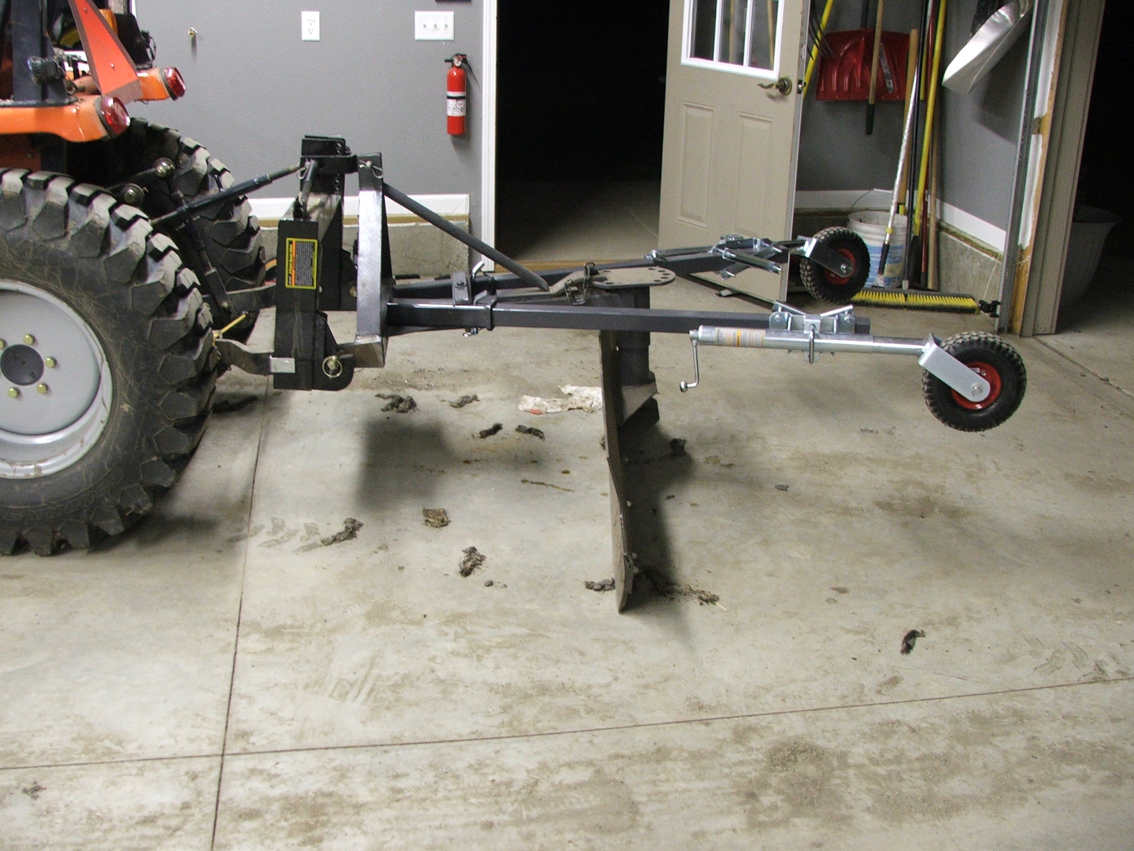

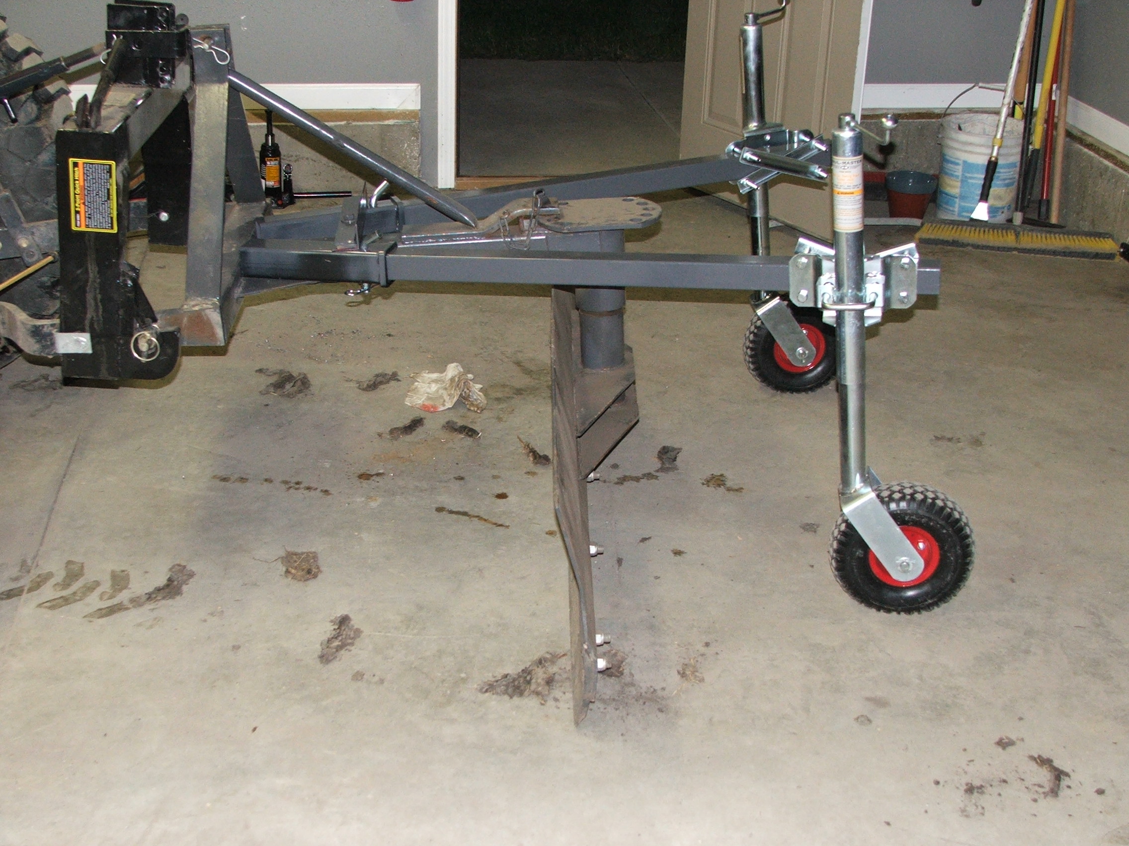

here is some pictures of how i added gauge wheels to a rear blade. my blade is a Tarter Gate but it is identical to a king kutter.

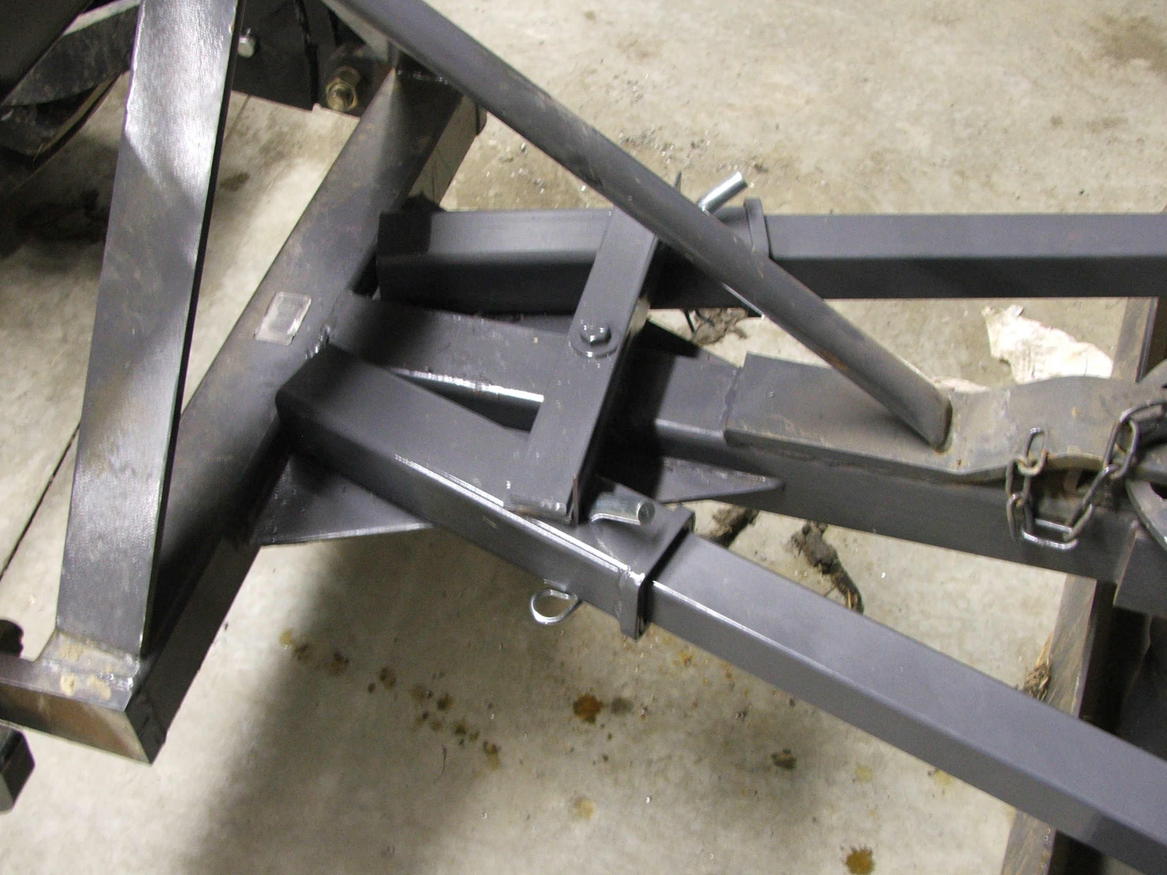

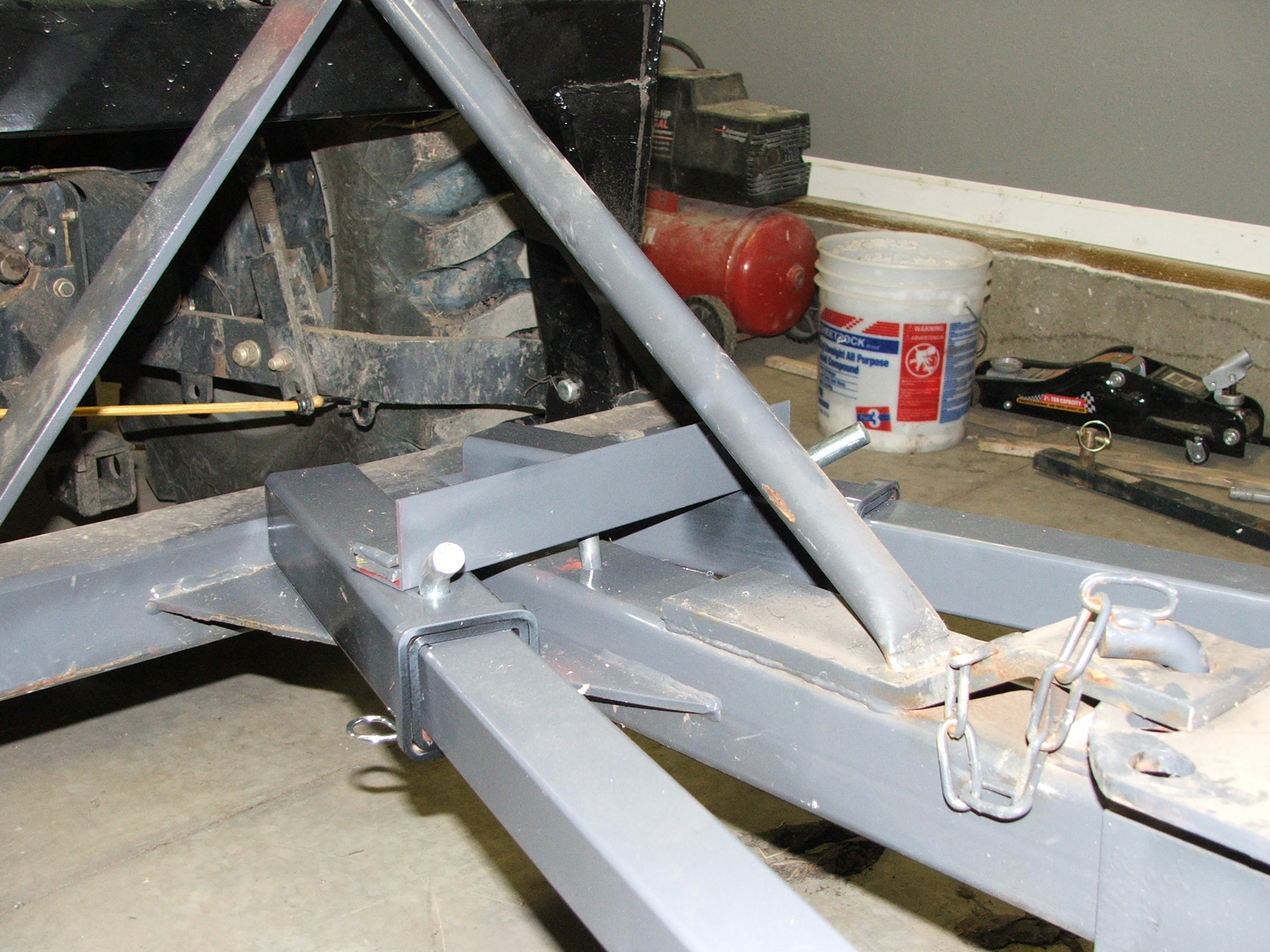

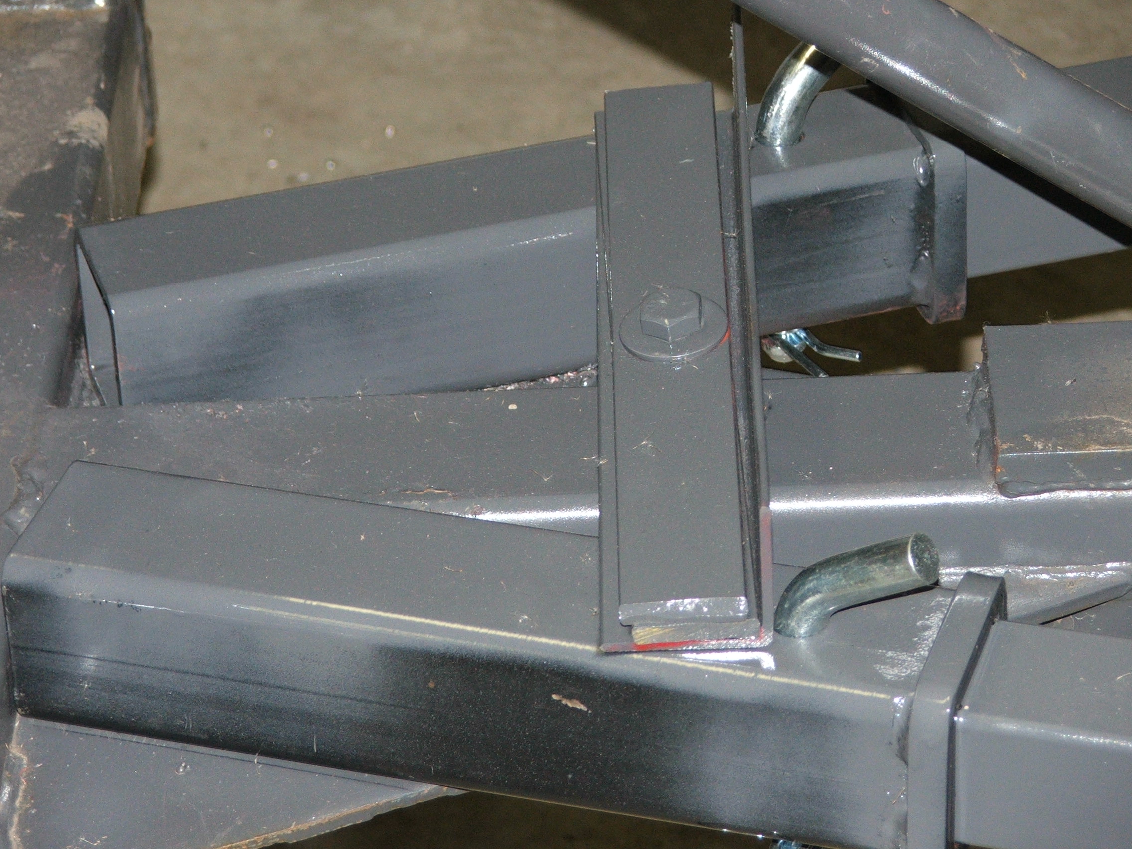

Are there bolts going through the receiver tubes and the gusset?
I know I'm missing something, I just can't see it.
The only fastener I can see is the clamping bar and angle iron, something must keep it from sliding back or sideways.

I agree. It looks like the only thing that holds those receiver tubes with those very long lever arms in place is the friction against the angle iron pressing down from above. In turn that is only held in place by one bolt.
As the plow is used there will always be vibration, and it seems this will all come loose and fall apart. With a little welding that would change of course.

there are 2 1/2" bolts attaching each reciever tube to the gussets the nuts are just located in the tube so you cannot see them. I added that clamp to the tubes after the fact because i thought that the gussets may not be strong enough and the clamp puts some load on that center tube.
