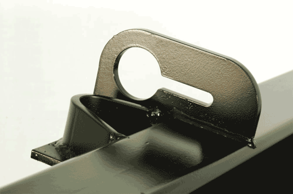

Instead of hooks why not just weld a piece of 3x3x3/8 angle to the top then cut slots in the angle 7/16" wide then you just drop the chain in the slot to the length you need. On my FEL I have 3 slots 1 6" from both ends and 1 in the middle. It can support any amount that your tractor can lift. It is easy to adjust the chain, just move it to what ever link that you need. If you want to take the chains off just roll the bucket all the way over and back up the chain will slide out. A chain wont bounce out of slot like it will with a hook. Just my 2c worth
/ Adding draw hook to FEL #7
Just make sure you weld them in-line with the loader arms. This is the strongest point of the bucket and loader. Do not weld them on the outside edges of the bucket. You will twist the bucket or possibly even the loader. We've gone to the slot style as a standard component on our new buckets and customers really seem to like the strength and ease of the self-locking style.

Thanks for the input. I only have 1 chain - it's 3/8". I too would like to see a picture of the "slot" approach.
Mounting the hook upside down along the top seems popular. Doesn't that mean that the bucket has to be extended to use the hook and aren't the cylinders most fragile when extended?
/ Adding draw hook to FEL #12
Here is the lot style we use on our buckets. Two aligned with loader arms, not at outside edge of bucket.

They're available as a part. Because I don't know what your top rail on your bucket looks like I can't say for sure on the fit, however you should be able to make them work. Possible stiffner on top edge? They are a square piece of steel with the cut out (rounded top corners). I think they're about $15 each.
