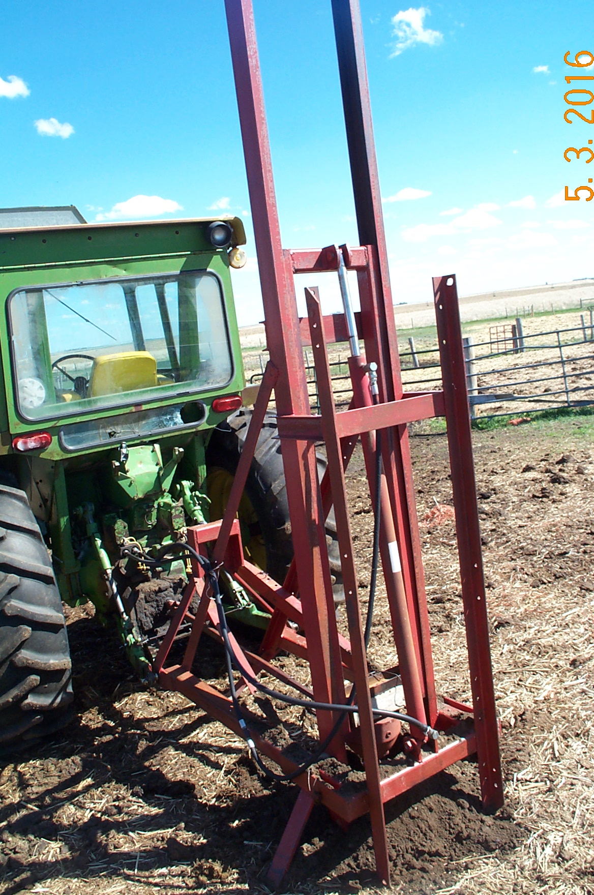

/ Adding down-pressure to a post hole digger (PHD) #6

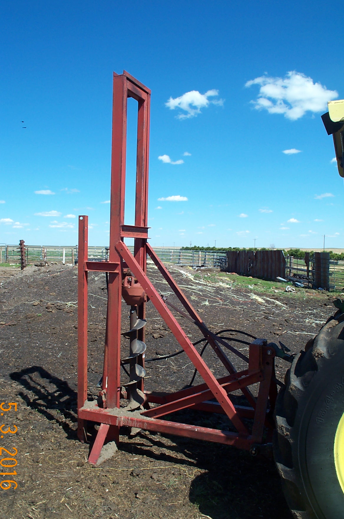

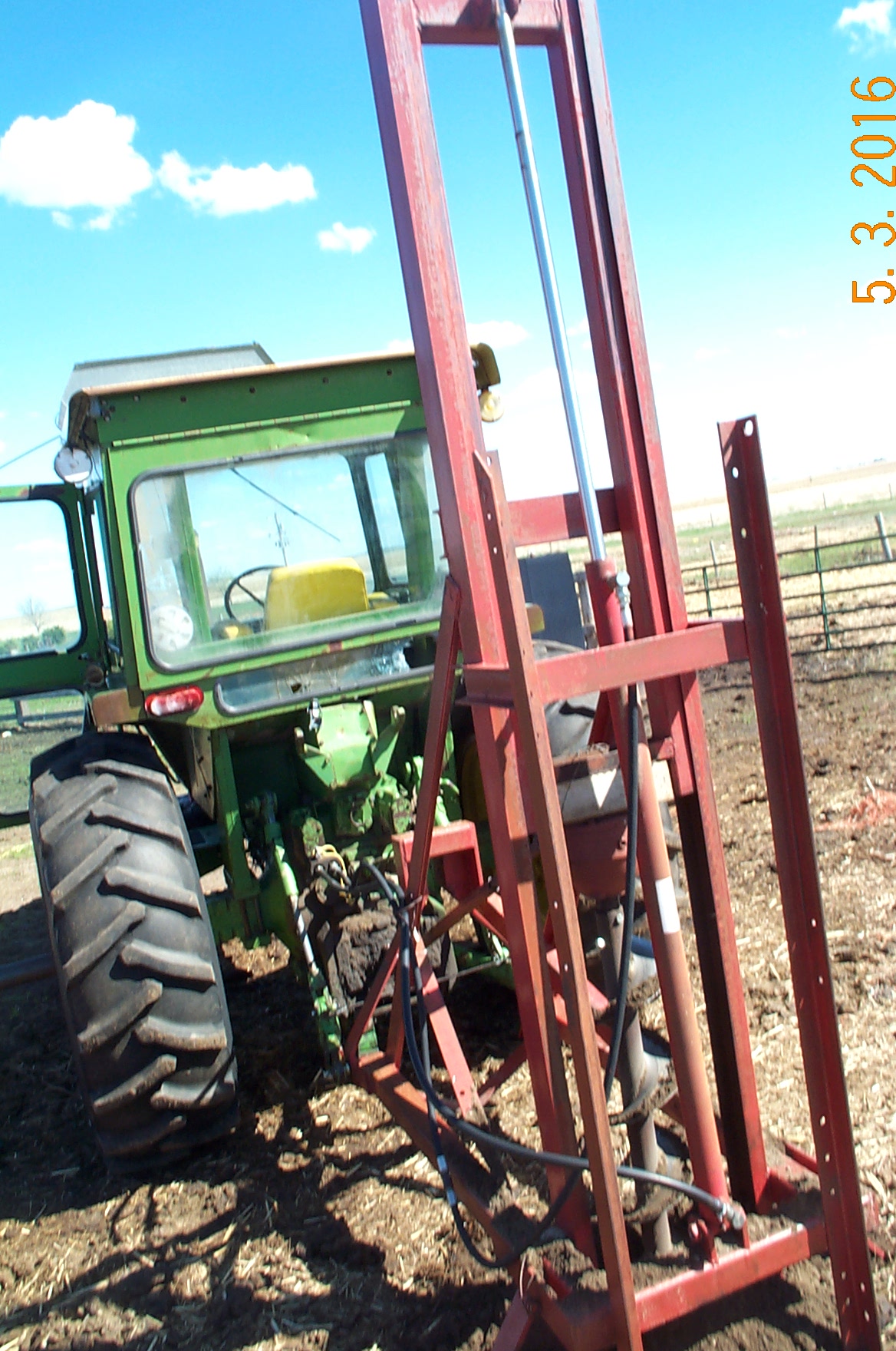

my digger was once a piece of junk, My dad always only bought the cheapest POS out there,
and he tried it a few times and gave up, I used it a little and could not dig a hole unless conditions were jsut perfect, and could hardly ever dig a straight hole, as the head would rode in an arc as it moved up and down,
and one day I figured I would adapt it to ride on a track so it would dig straight, first of all and add some down pressure, even tho the weight is only the frame it acts like three to four times the weight of the frame, if just piled on the digger when was original,
now you hardly ever have to do any more than just clean out a little loose dirt in the bottom of the hole, out of 23 holes today, I only had to alter about two holes (8" auger, and a 6 5/8" steel post, and only by about 1" on a edge.)

/ Adding down-pressure to a post hole digger (PHD) #7
BHD that is slick. I've always struggled with the arc too. I might just "borrow" some of that design.
/ Adding down-pressure to a post hole digger (PHD) #8
That's hydraulic powered not PTO isn't it? Why not just mount it to a SSQA plate or the bucket? Would have some arc issues, but would be easier & cheaper to build.
I have a lot of arc issues with my build, but forget if the standard PTO PHD does the same. Easy enough to inch forward to counteract the arc travel path with my HST though.
/ Adding down-pressure to a post hole digger (PHD) #9
If your talking about the red one with the lift then that one is a pto. Zoom into the gearbox and tractor pto and then you can see it. Hard to tell at first. I would add a edited picture of it but TBN won't let them load
/ Adding down-pressure to a post hole digger (PHD) #10
Ah, the hoses for the lift cylinder threw me off.

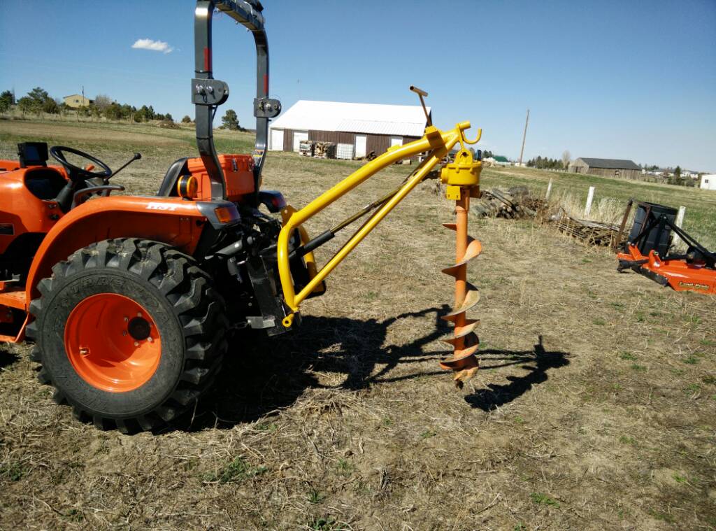

How much downpressure on that rig? Is it just limited to the weight of that frame?
/ Adding down-pressure to a post hole digger (PHD) #11
It is PTO powered, and the weight is basically limited o the frame, but it now dig a lot better than if I would have just weighted the digger, (why I do not know),
the two angle Irons on the back are to push the fence wire out of the way, so the wire does not get in to the auger, and it makes a reasonably effective safety cage,
(when I was in high school my Ag teacher lost most of a foot to a three point digger, when he attempted to lean on it and add weight on it, the tractor he was using had some kind of draft control on the three point and it jumped up and out of the ground and come down on his foot),
neighbor had some kind of a two point for a old IH tractor when I was a kid, and that is some what where I got the idea, for the frame work,
I was similar to the one in the picture, and I think it had some kind of cable lift,
