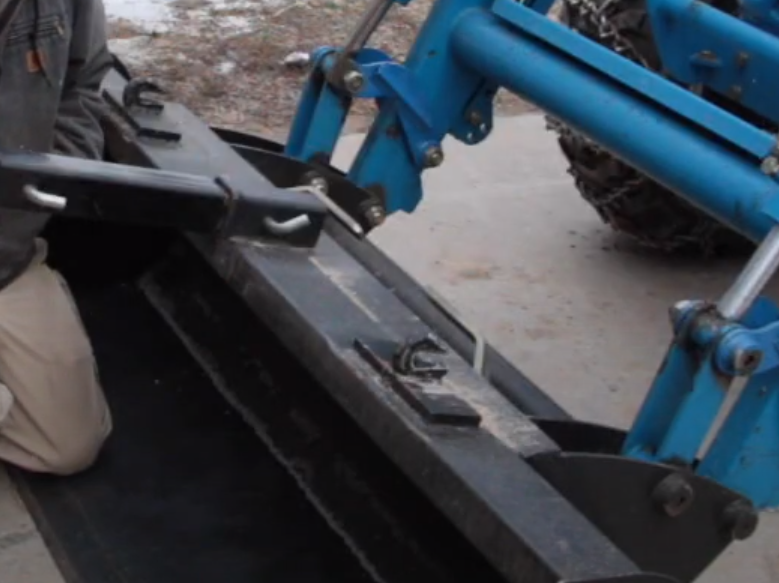

Thats one of the first things I did to my tractor after it was dropped off. I used a couple of 3/4" flat stock, welded the hooks to those, then welded the stock to the bucket, just in front of the lift arms.
Here is a screen shot taken from a video I made about them

Avenger, do you find any flex along the top of your bucket when using the hitch? I see in your video that you are lifting a garbage can. Not sure how heavy that can would be. Do you use it for other things? I intend to use the hitch to move trailers around which have tongue weights of about 200 - 300 lbs.
   / Adding Chain Hooks & 2" Hitch Receiver on MT3 Bucket #6
No flex that I notice. Thats actually the primary reason I welded that receiver on there, was for moving trailers around. Makes it MUCH easier. My boat is probably the heaviest. But my utility trailer, even loaded, no problems at all.
I do use an extension too. Puts more stress and strain on it, but makes it easier to see when hooking up to the trailer. No flexing, breaking, or anything. 10/10 highly recommend.
