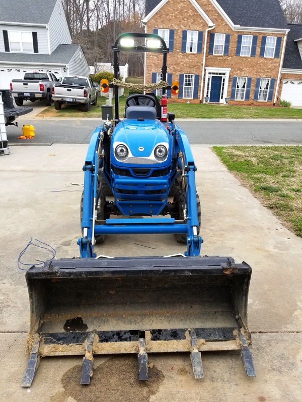

I just tonight finished up adding a pair of 36w LEDs forward facing on the underside of the top of the roll bar (hopefully out of the way of tree branches enough they won't get snatched out...I use my tractor in the woods a lot). It's a LOT of additional light for only a 6 amp draw. I can't imagine needing any more than that, personally.
I'd previously put 2 pair of 18w ones on my golf (farm) cart, one forward, one rearward, switched separate, and it's plenty of light for the cart. I plan to add a pair of 18w for a rear work light on the tractor soon.

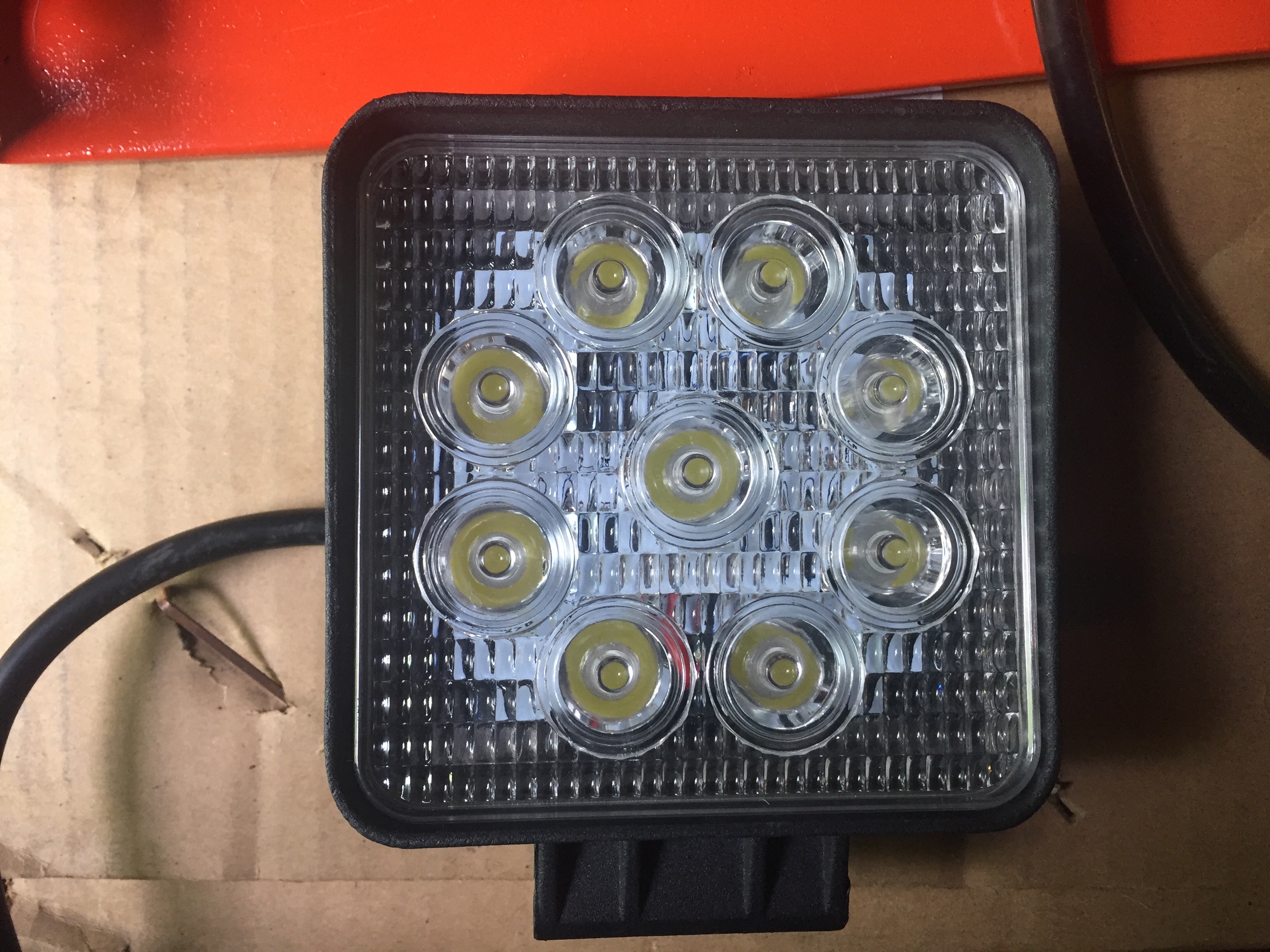

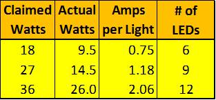

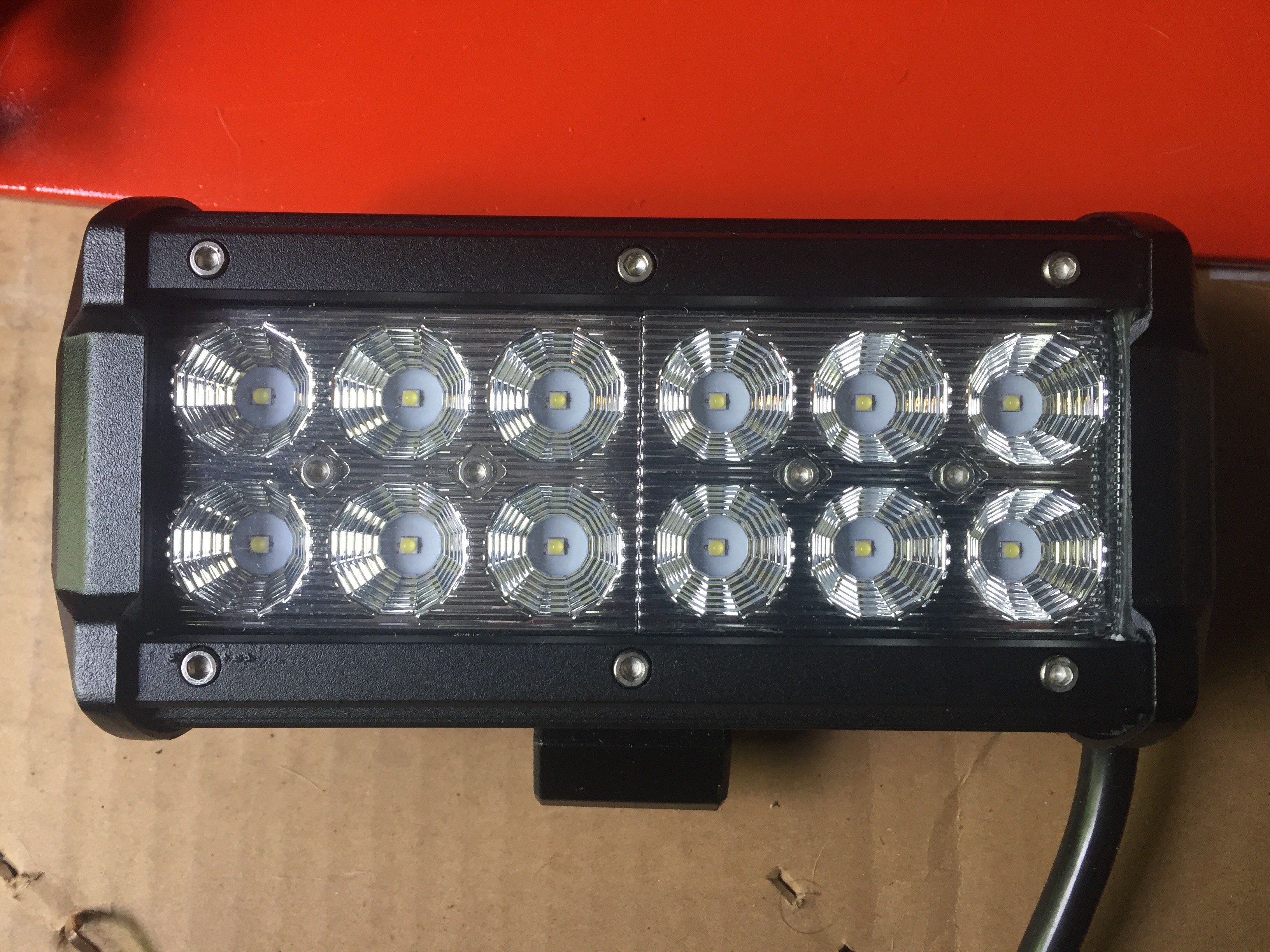

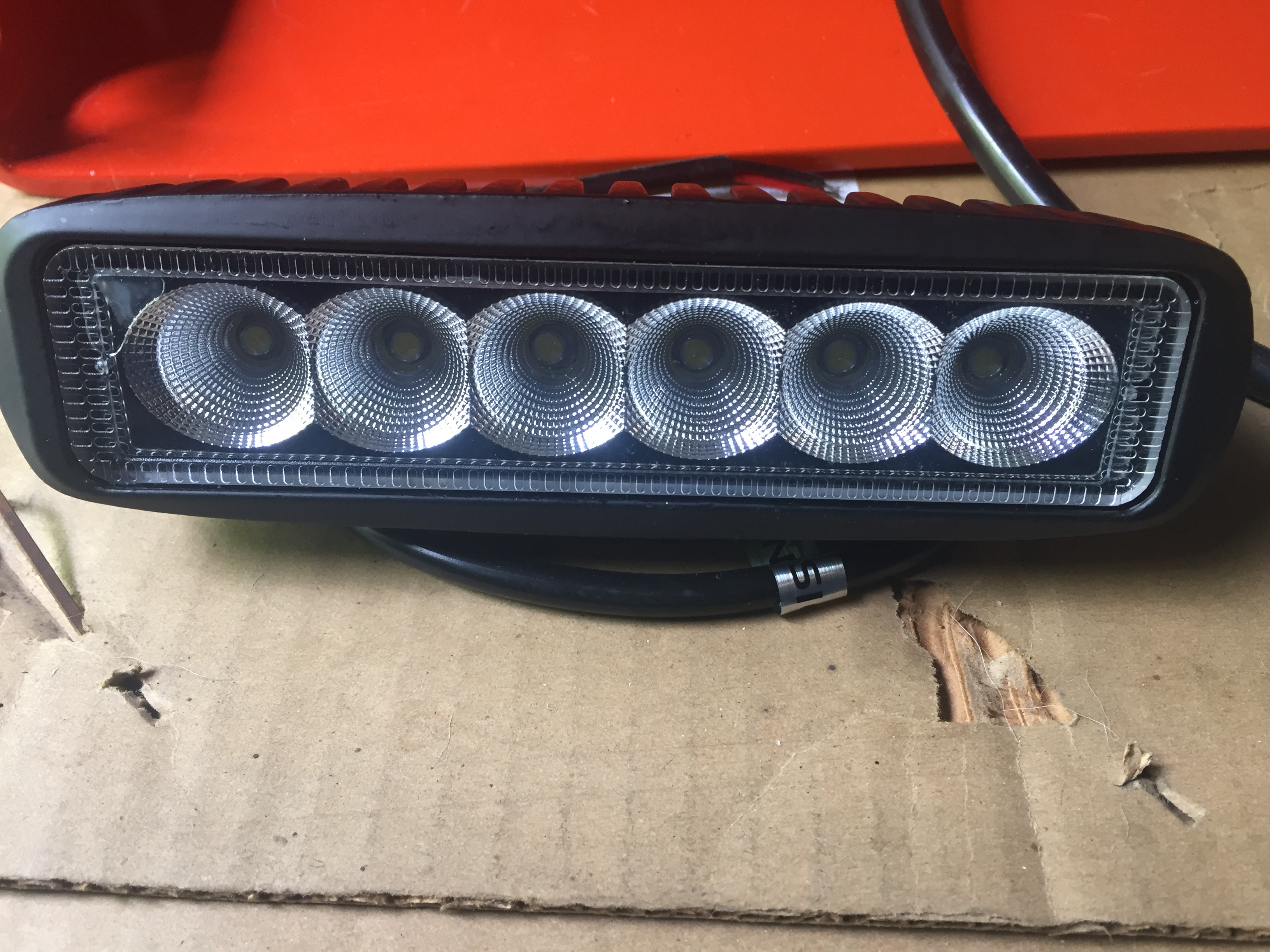

CMV,

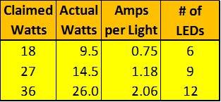

After measuring 3 different styles of LED work lamps, I found the rated watts to be overstated. If you disconnected your headlights, you'll have plenty of current to work with.
I've bypassed the headlights in several applications without altering the wiring by using an equivalent plug that simulates the headlight connection. Sometimes they are sold as headlight extension wires. Should the need arise it would be a simple plug and play to go back to stock.
The 18 watt lamps were of a 1x6 led arrangement (1 row of 6 leds), 27 watt has 9 leds in a 4.5 square housing and the 36 watt units have 12 leds mounted in 2 rows or 6 leds.
Keep in mind the values above are per work light, so if mounting a pair the amperage would be doubled.
The LED's lights above were the common cheap type found on Amazon for under $25/pair.
Example of 18 Watt:
27 Watt:
36 Watt:
All of the above put out an amazing amount of light when compared to halogen headlights or conventional work lights. The 36 Watt variety work very well on my cab tractor.
No need to overthink this and you'll be shocked at the light output.

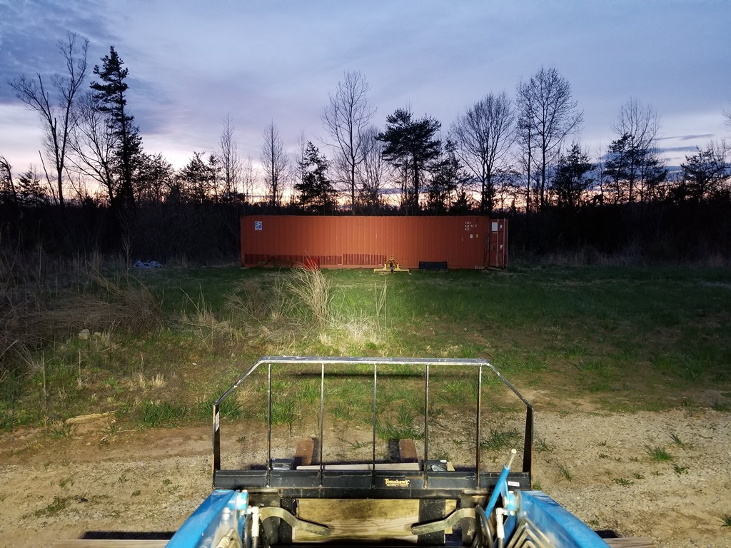

Got the 9" ones from WM that are $19 ea. I disconnected my front headlight connectors and then just tapped green & black wires there. Sleeved some wire and routed from under hood to rear of machine following hyd lines as much as possible. Lots of zip ties to keep wires where I want them. I wanted to retain use of the stock headlight switch for my new lights not need some additional switch, so I lost my stock front headlights. Could reconnect but no idea what that circuit and switch can handle so felt more comfortable leaving stock halogen bulbs disconnected - not that they really did much anyway.
Coke/Pepsi, Ford/Chevy, drill/don't drill ROPS. I chose don't drill so just used a piece of angle iron and U bolts to mount the lights. Other than some scuffed paint, no harm/change to ROPS. Not the cleanest or prettiest way to go about it, but works - which is all I cared about.
Overall the lights are really, really bright. The pattern is a little more of a spot than I'd hoped for, but still 100x more illumination than the stock lights - esp since they were mostly obscured by the bucket.
