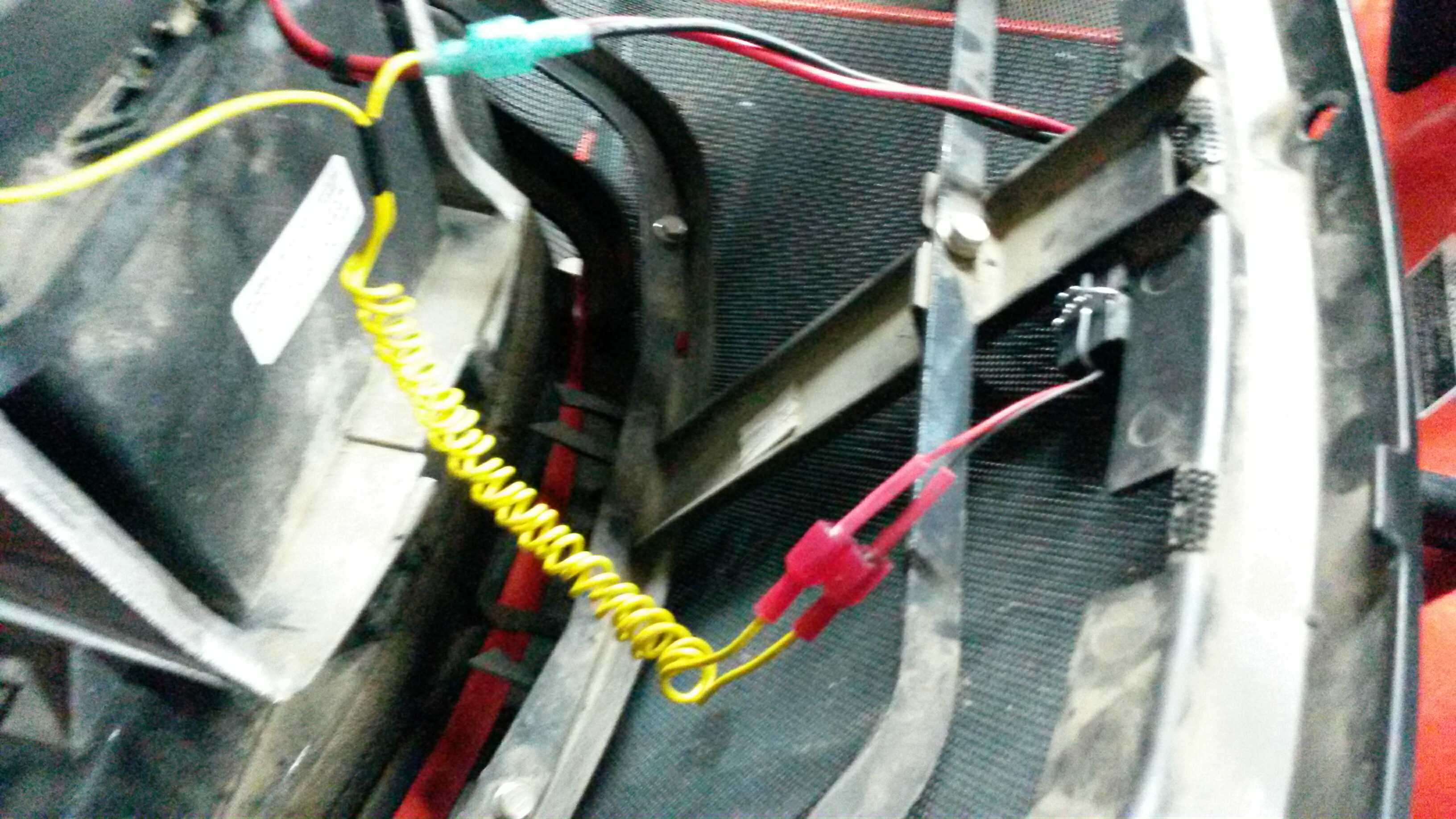

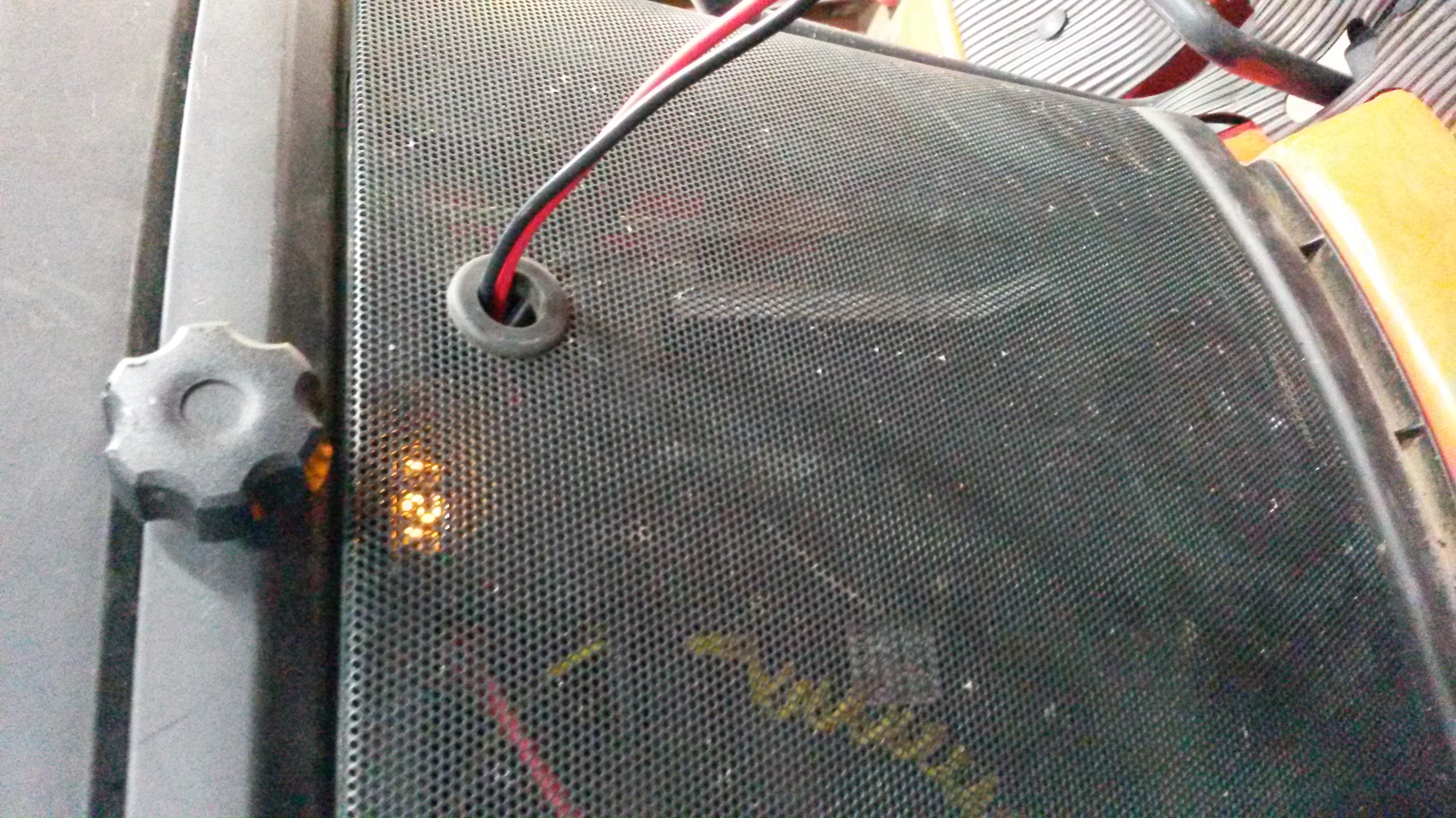

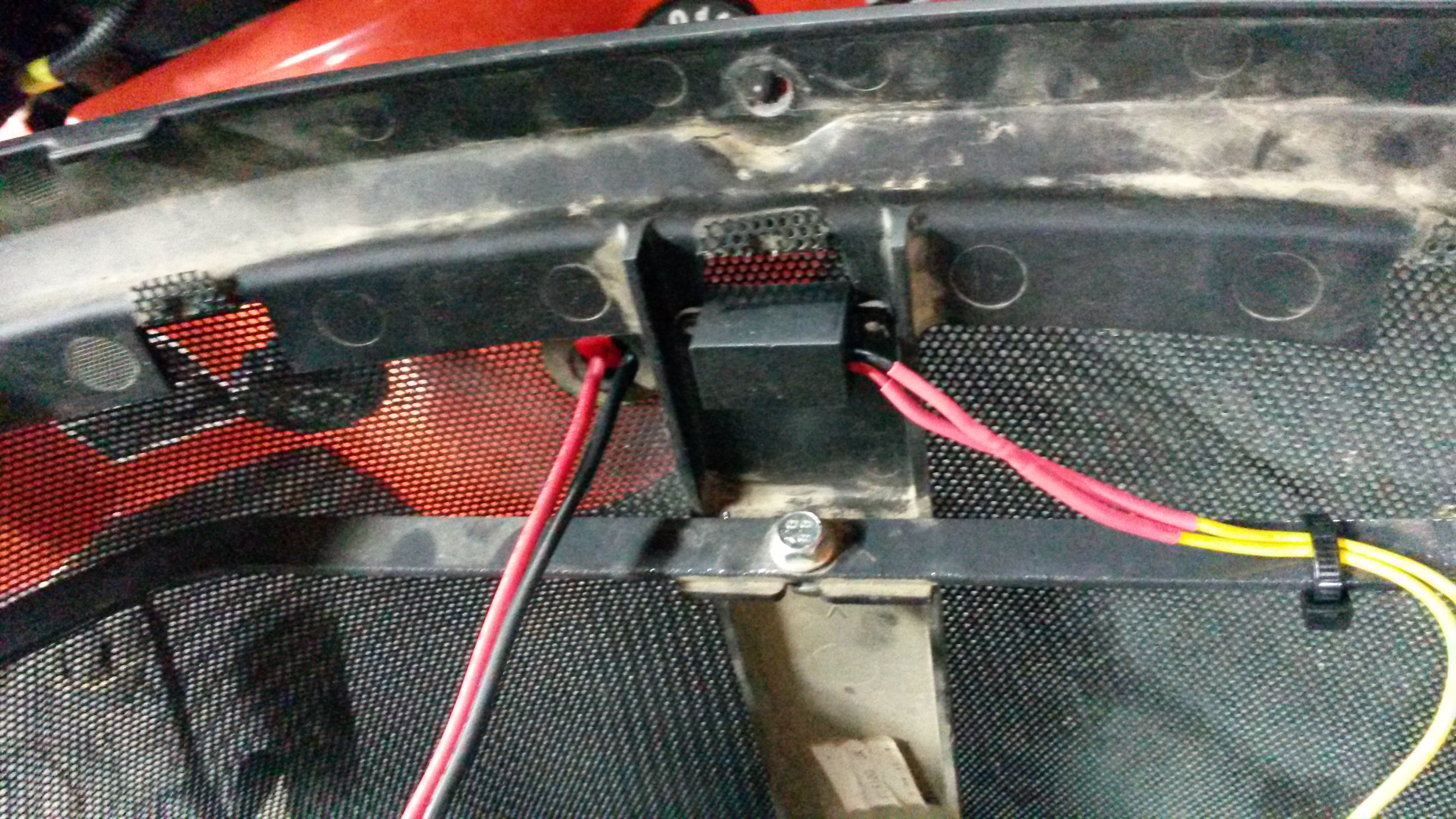

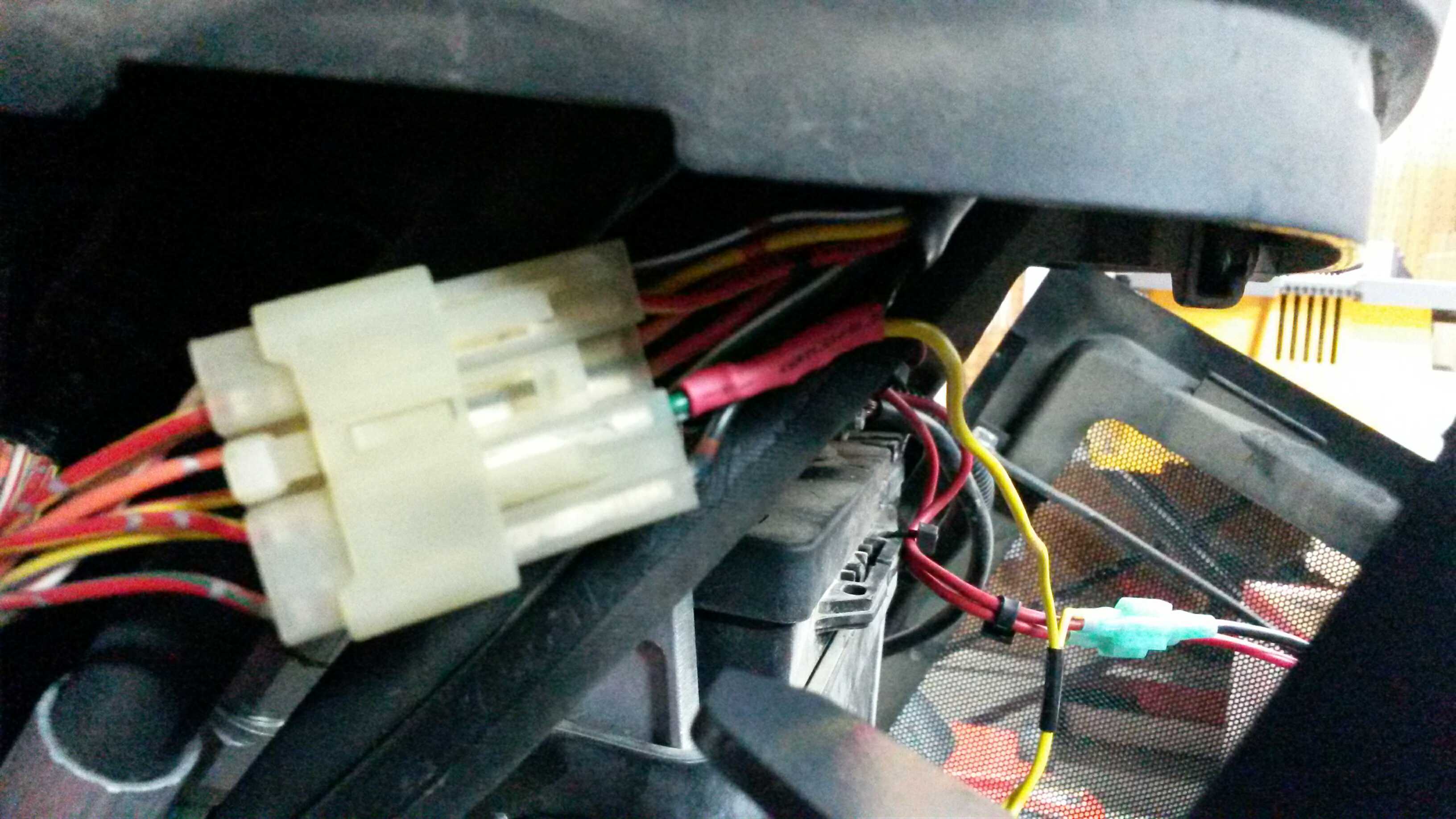

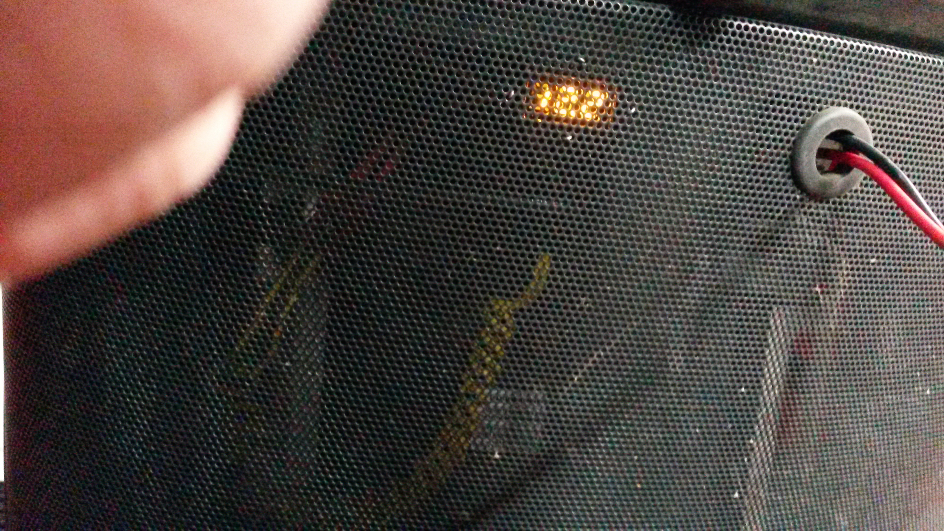

Here's my copy of your voltmeter on my kubota bx1860. 1463206271653.jpg hard to see from the seat, but easy standing next to the tractor.
Tied into a wire in the blinker switch by removing the pin from the connector and soldering a wire on, then putting it back in. So I could remove it without leaving skint wires.
