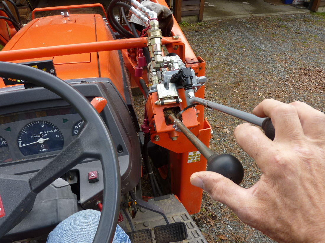

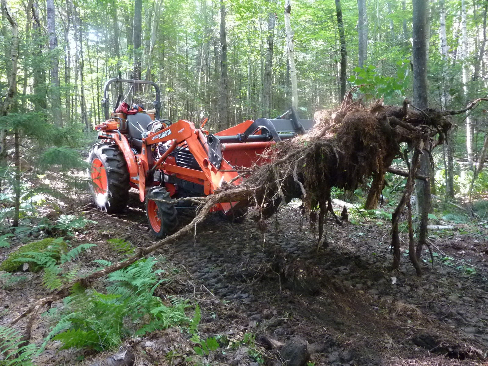

Here is one I did long ago.
The more modern approach is to use an electric valve with a third function switch on the FEL control lever. I have one of those on my other tractor. Both methods work very well.

Do you still like this setup?
/ Adding additional valve next to loader joystick? #6

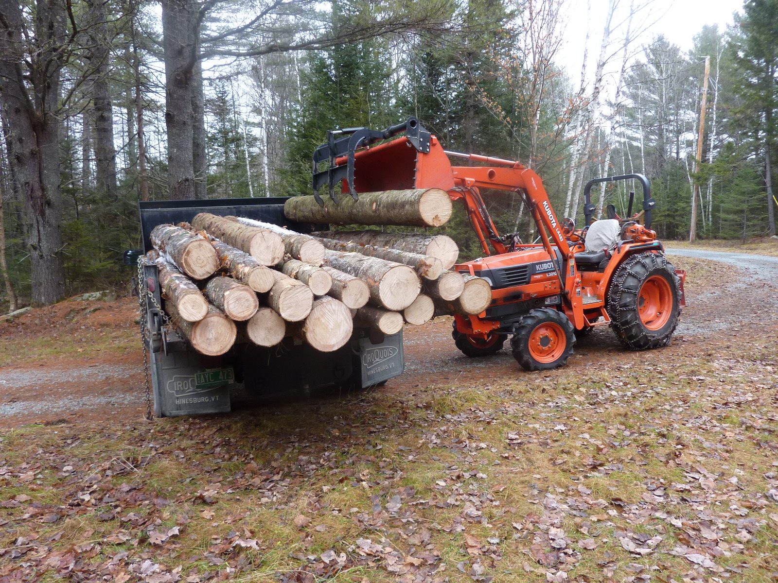

Yes I do, very much so. Been using it over 10 years. Use it mostly to load logs but do other grapple chores too.

/ Adding additional valve next to loader joystick? #7
I should add that my other tractor came with a 3rd function switch on the FEL lever when I bought it used. I really do not have a preference of one over the other for controlling the grapple.
