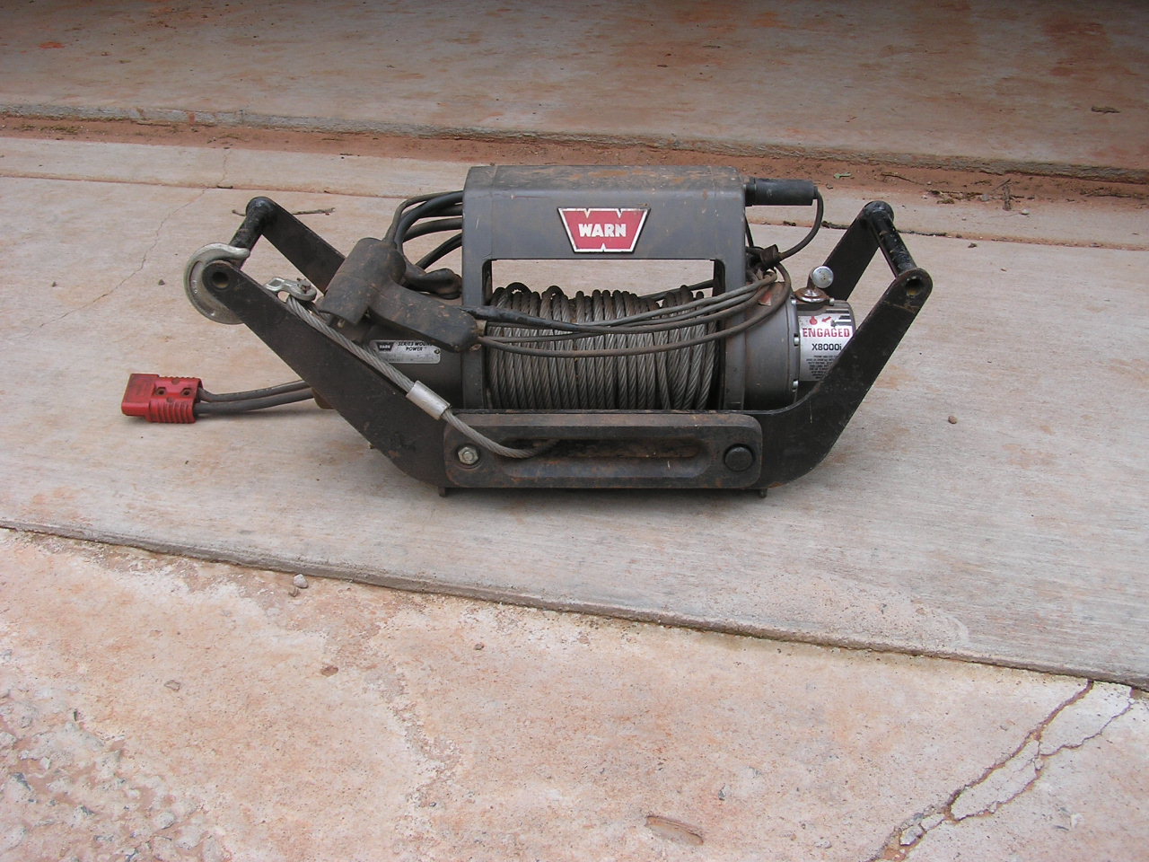

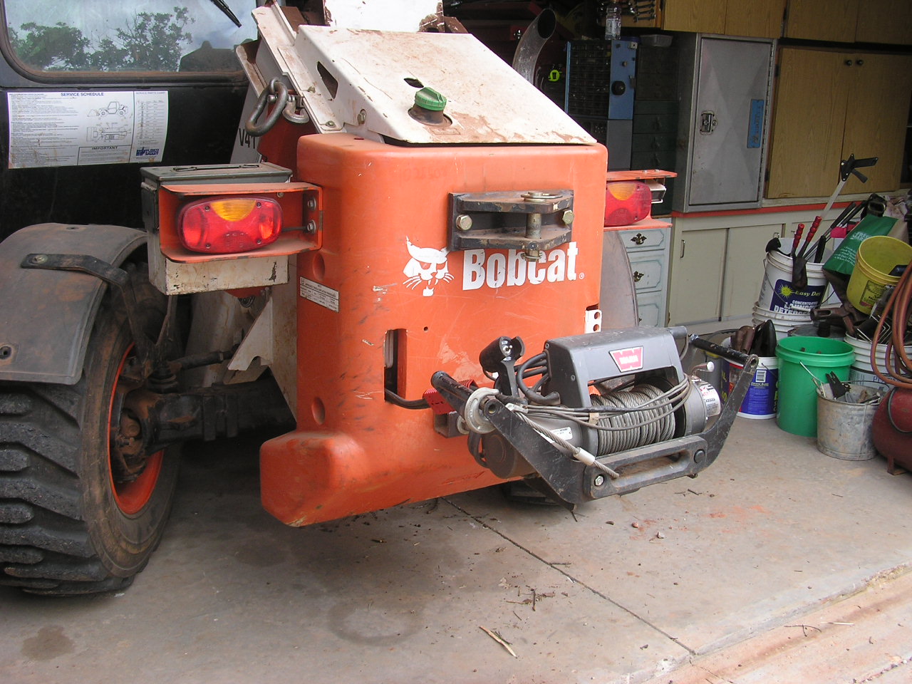

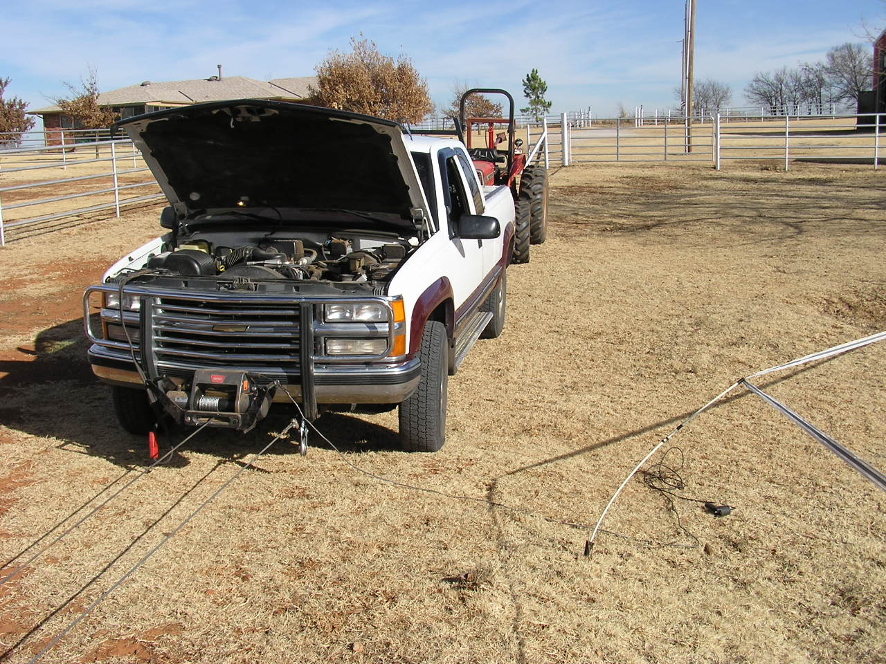

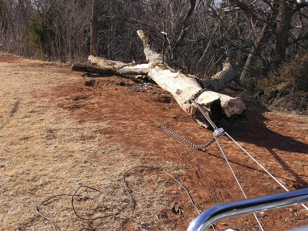

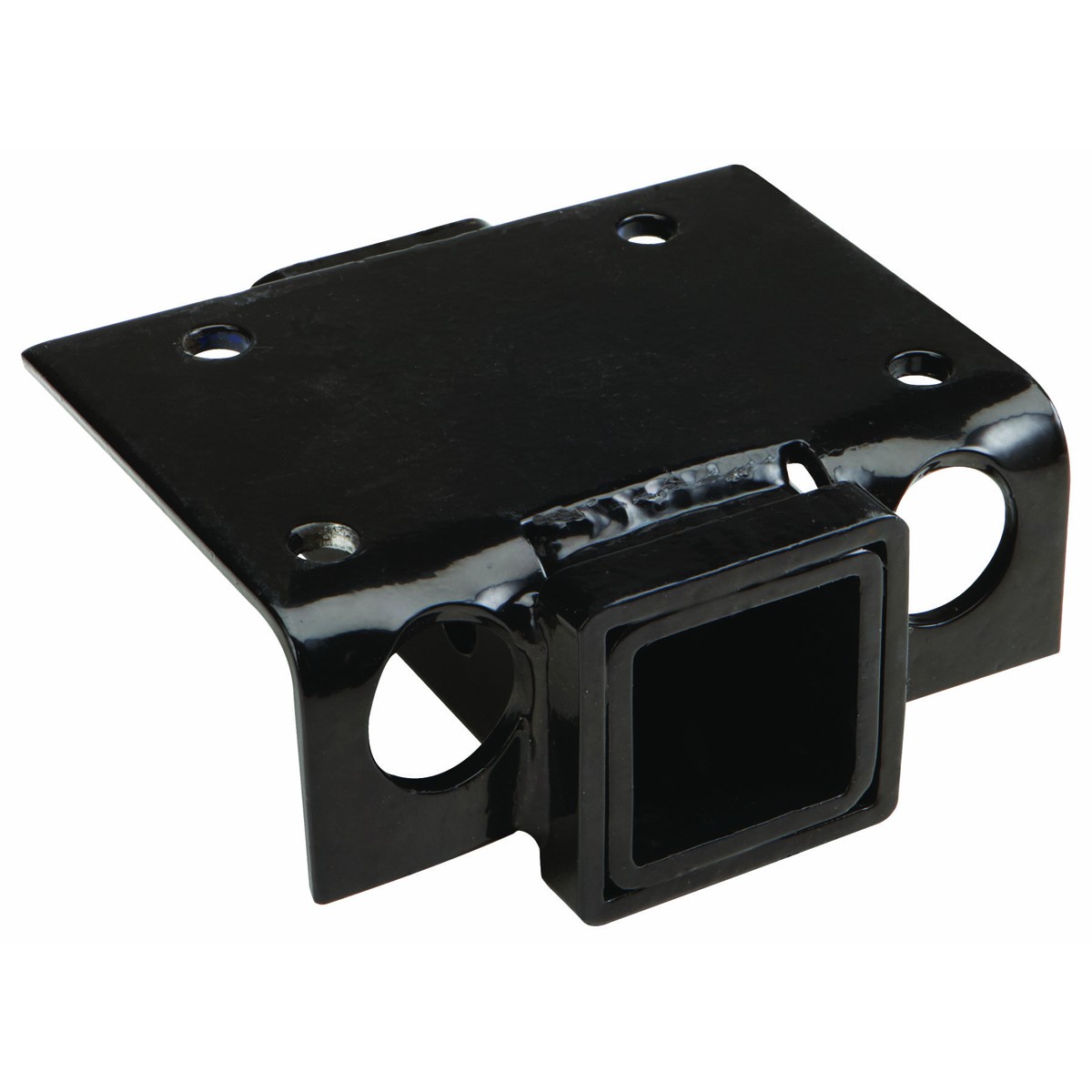

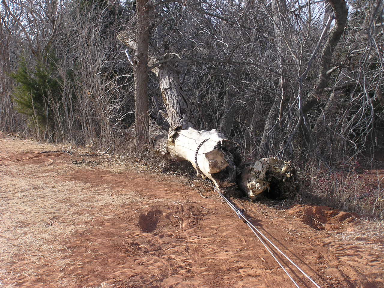

I am thinking about adding a winch to my Cam Superline 7 ton 20' full tilt deck over equipment trailer. I've got a friend suggesting a Warn M12000. It will be a general use winch depending on whatever situation may arise. Any thoughts?
Mount it on a receiver winch mount like this, so it can be used on your truck or tractor also.

The receiver mount is a great idea. Check out viper winches. I have the 12k model and the price was very reasonable. Make sure you get a good battery and figure out a way to keep the battery topped off if you don't tow often. A solar charger or a trickle charger that plugs in would be a good idea!
   / Adding a winch to 7 ton trailer #8
Xfaxman - in the bottom pic. Were you stretching that pickup and making a crew cab - ha,ha. Looks like the Massey must have been connected to the back of the pickup. Those "receiver hitch" Warn's look to be VERY handy. Warn didn't make that type when I used their winches.
