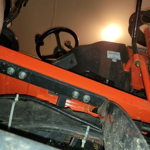

unclesalty-Can you post a picture of the mounting location of the step you have on the right side of your CK2610?
I’m confused on this. My dealer said (as of yesterday) there is no right-hand step available, and claimed to have discussed with the Kioti Rep. Here’s a picture of my right-side frame, and there are no holes that I can see to mount a step in a similar fashion to how the left side is done.
Did the frame change on the latest models? Mine is a 2019.
Thanks, Toukow

There's a square bar up under the deck lip on mine, the same as the other side with the same 4 step mounting holes. 2020/2021 model, so there was probably some change from 2019 to 2020.

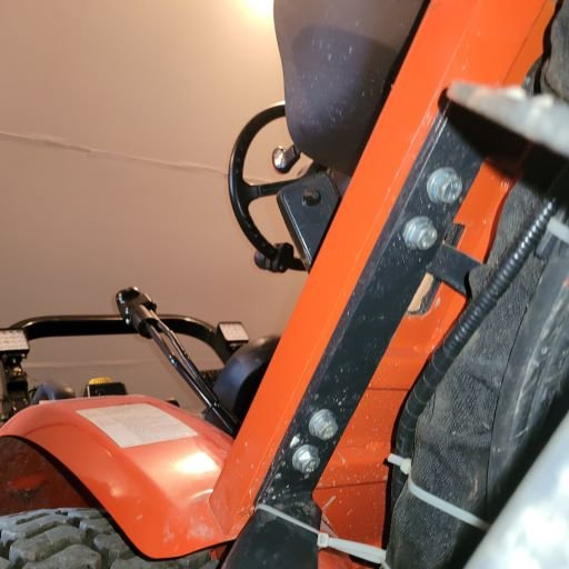

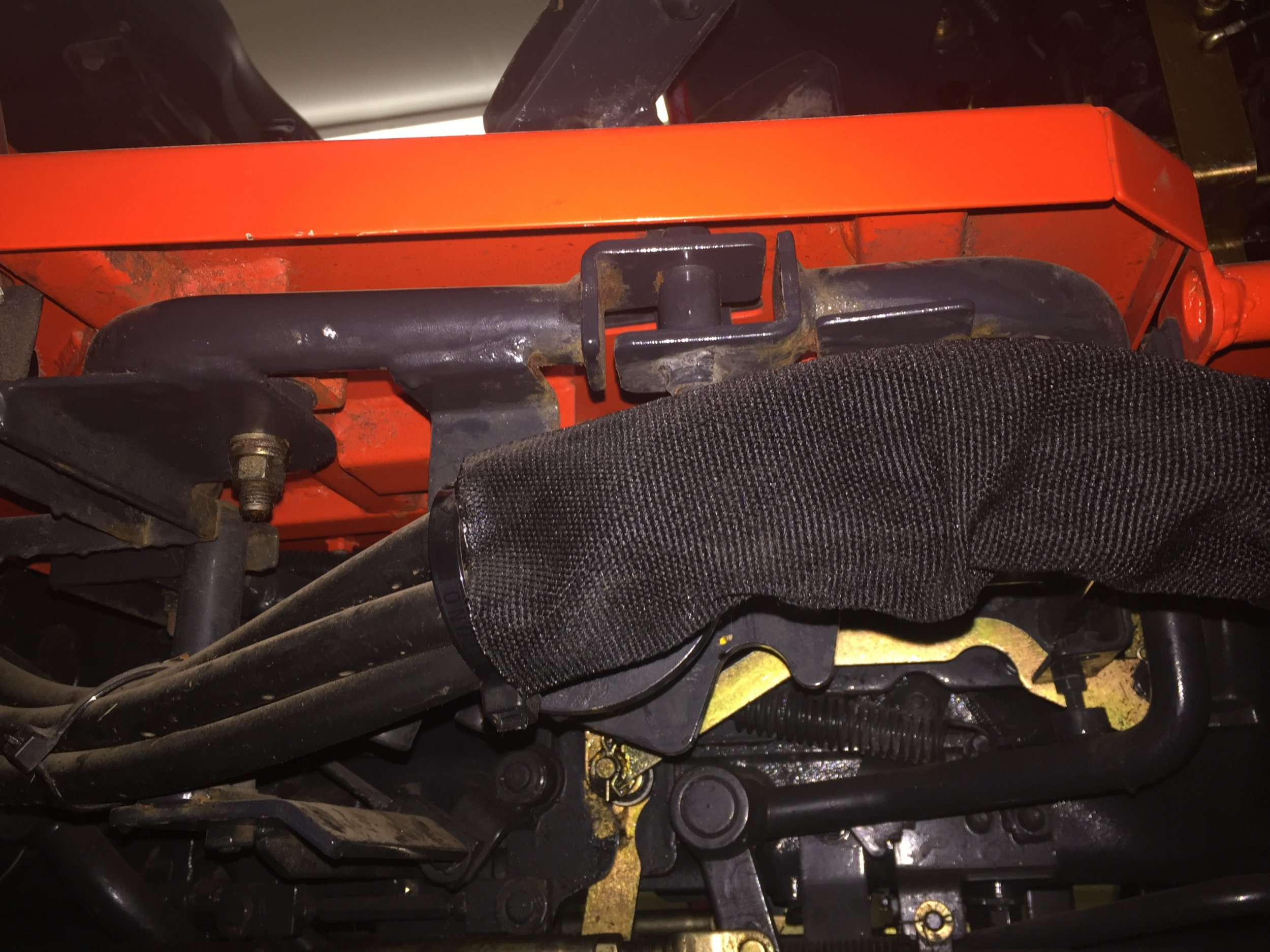

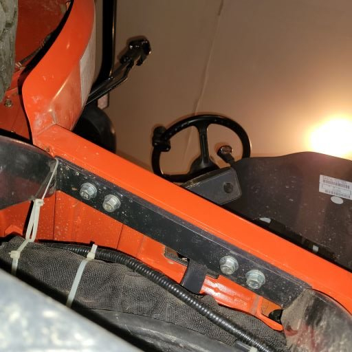

This is the same configuration on my 2018 CK3510SE HST. Here are three more pics of my add-on right side step, from slightly different angles. Toukow, it looks like the set-up on your 2019 CK2610HST is indeed different from Midniteoyl's and my CK3510SE HST models. So it could a matter of frame size. Or maybe the SE designation, though I think that's less likely. But, then, Unclesalty just bought a CK2610HST, and the dealer was able to add a step. Maybe an older model-year? I've just assumed it's a late model. Hopefully he can post a pic of his right-side step set-up and solve this mystery. :)
