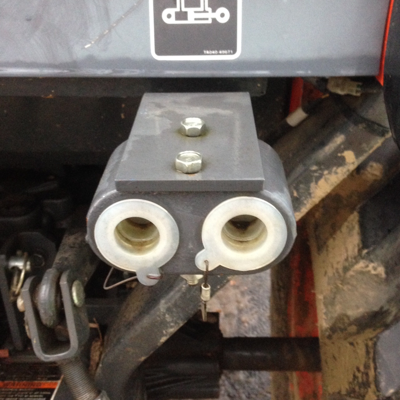

I'm somewhat new at tractors and hydraulics so perhaps this is a dumb question, but if I wanted to add a hydraulic top link and also upgrade to a hydraulic rear blade on my Kubota B3000, wouldn't it be a simple matter of re-plumbing a couple wyes into my existing rear remotes?
I figure if I have my top link adjusted the way I need it, then I'd just disconnect it's hoses and then the rear blade would be the only thing being operated. I kind of poked around for fittings but haven't been able to find anything so far. If this is doable, or if I'm approaching it in a dumbass manner, please consider advising me :rolleyes:
thanks... Gary

No Y's or T's.
Fluid has to go through all valves in series.
If you have a hyd block, you probably have a line going back to the 3pt and you can use that.
You do have a hyd block and if you have a loader, the hoses come and go from the hyd block.
If you have no loader, then the hyd block is capped off, and you can remove the cap and use those port for the remote valve.
You need a two or three spool valve with PB.

JJ.... thanks for a quick reply, gotta say I don't understand much of it though..... told ya I was new at this. But based on what I did understand, here's the way I see it. My rear remote(s) have a supply and return, correct? If I tee off of these with quick disconnects, and only have one implement plugged in at any given time, isn't that in effect "no tees"?

Is there a valve that controls your remote outlets?
   / adding a hydraulic top link and hydraulic rear blade Kubota B3000
Yes, there is.
   / adding a hydraulic top link and hydraulic rear blade Kubota B3000 #6
Yes, your one spool remote can operate the top link cyl for the 3pt.
Why would you disconnect the hoses on the top cyl?
They have to be connected to lock the cyl in place.
   / adding a hydraulic top link and hydraulic rear blade Kubota B3000 #7
You can use T's or Y's or whatever else you want to rig up. But you create the necessity of coupling/uncoupling hoses. If you leave both circuits coupled the tractor will simply split the flow and operate both functions at once.
I've heard of guys on here T'ing their FEL lines to the rear and adding couplers back there. They could then unplug the FEL and have dual functions at the rear of the tractor. Or unplug the rear attachments and have FEL functions. But never both.
   / adding a hydraulic top link and hydraulic rear blade Kubota B3000 #8
I wouldn't expect the top link to stay put when disconnected. You lose a small amount of fluid every time you disconnect, and that will be enough to probably let the top link wiggle a bit.
#9
JJ... I would disconnect at the tee (yet to be installed) off the rear remotes quick connects. If everything had quick connects wouldn't that lock cylinder in place? Duh.... I think a light just went off..... if all I'm doing is connecting/disconnecting one or the other, I don't even need a tee. Not sure what I was thinking.
Richard... yer right, as I realized. I don't even need a tee at all.
