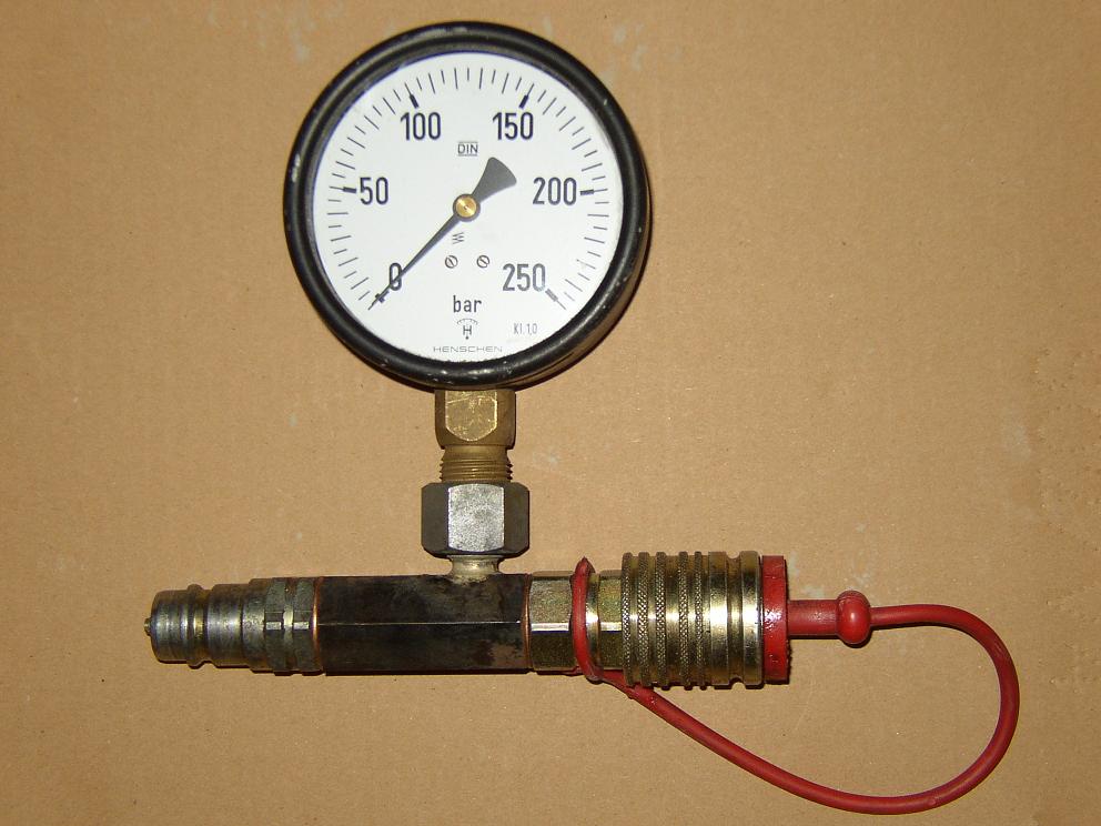

I made one that just plugs into a QD, I used it to check the pressure on my tractor.
Here is a Picture

/ Adding a Hydraulic Pressure Gauge? #4
If you add one like Kenny showed, you'll just measure relief valve pressure.
I added one for checking working and relief pressure.
Range is 250 bar = 3625 psi

/ Adding a Hydraulic Pressure Gauge? #5
And connected in series with cylinder, left from rear working light...

If you put the gauge between the loader boom lift cylinders and the SCV, it will show the pressure holding the bucket up regardless of the valve being open or closed. The setup with the tap between a male and female quick-connect might be ideal for this, or you could plumb it in on the loader itself and mount it up on the arm or something.
You can see dynamic pressure spikes that significantly exceed the relief pressure setting when the valve is closed if the load is bouncing up and down or you are ramming the tractor into a heavy pile.
Think of it this way - what would happen to the loader if you were to suddenly cut the hose going to the lift cylinders? It would fall to the cround. Unless it is resting on the ground or otherwise blocked up, there is pressure in that line holding it up.
Except when the loader is resting on the ground, you will need to subtract the pressure caused by the empty weight of the loader from all values. Zero payload weight will not be zero pressure.
Many loaders have a fairly non-linear lift geometry leverage curve. The pressure for a given weight will typically be higher at full height than down near the ground. You will want to calibrate your "scale" at a given lift height - preferably down near the ground.

/ Adding a Hydraulic Pressure Gauge? #10
If you make T connection with hose and manometer just behind pump, you'll see pressure just during lifting.
If you want to measure "weight" in loader, you need to connect T with manometer in lifting hoses circuit. Just make something like on my first pic, put high pressure hose between T and manometer and install it in fast connectors toward lifting cylinders.
But, as somebody mentioned, your loader has overload valve anyway, so you don't really need it.
I made and used this gauge when I had jerking during lifting hopper on my corn picker, and wanted to detect problem.

Do not put a gauge in the loader lines after the valve. It will see a lot of transient loading as you move and it will fatigue the Bourdon tube over a fairly short time. The gauge will probably blow before this tho because of the very high [as much as 10kpsi] transients seen as you move with a full bucket or push hard into a pile with the valve centered. The relief valve is not in this part of the circuit. The bucket will fall if the gauge blows.
I put a gauge in my pump output line as you are thinking about. At the connection to the hose feeding the gauge I threaded the interior of the connector and forced a set screw in lightly. The oil must travel thru the thread helix so flow is very slow. This way if the gauge or hose blows it will only drip. I find that my loader valve builds near 1000psi before opening the lines to feed the loader so everything takes at least 1kpsi. The heavier loader loads give a reading more in proportion to the weight of the load.
Its good because a gauge in this location always gives you a reading of how much pressure the pump is working against no matter what part of the hyd circuit you are using.
