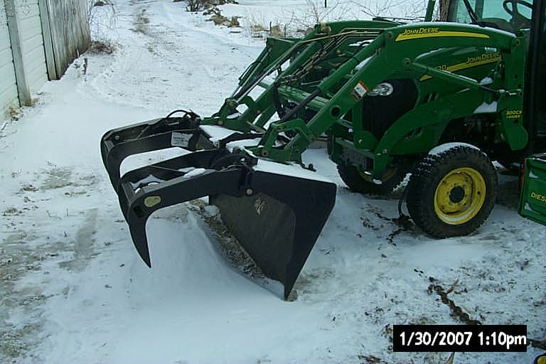

   / Adding a grapple to a 3x20 series #25
I have a 3520 Cabbed tractor with a dealer supplied grapple. It really is useful picking up large branches. I've gotten to where I can pick up rocks with it too. It has the extra lever in the cab for opening and closing it. If you have any questions ask away.

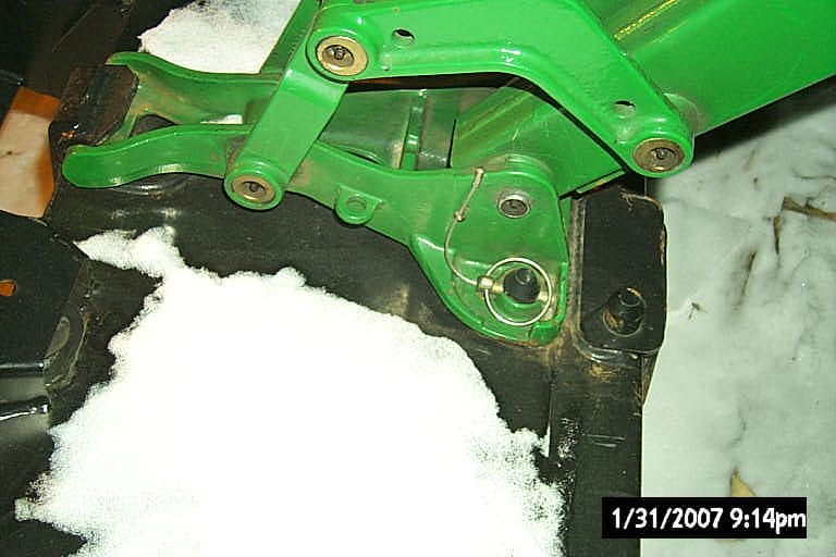

   / Adding a grapple to a 3x20 series #28
The grapple control is the third from the right. The bucket/grapple uses the standard bucket attachment system.

   / Adding a grapple to a 3x20 series #29
IslandTractor said:
I imagine he is talking about the rear remote control lever.
He is. I could not understand why you liked the rear remote setup when I had the diverter on my CK30. After I had to trade to a JD 3520 and found the third SVC was the way John Deere set it up i was a little hesitant. now after using it for a while I don't see it as being any more difficult to use than the diverter. It just depends which way you are most comfortable.
Al
   / Adding a grapple to a 3x20 series #30
Al
I've never used a diverter but as you know I have found using the rear remote to control a grapple perfectly acceptable. The only downside that I can really think of is that it ties up the rear remote so that I cannot use the grapple and backhoe on the same task without getting off the tractor to switch the lines around. If I find that is more than an occasional nuisance I will probably go ahead and add a diverter...but only to recover the rear remote.
