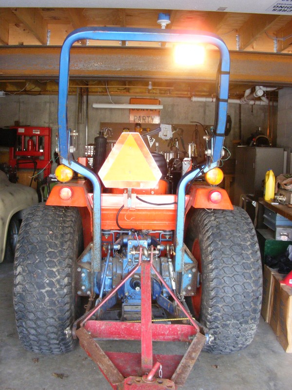

I have a Kioti LK3054 and want to put a light on the ROPS so I can see when plowing in reverse with a 3 pt hitch blade at night. There is a 6 wire connection behind the seat but which wire is the power? I do not have a meter to check the power source. I was hoping someone has done this in the past and could pass on their learnings. I would appreciate it and wish you all a merry Christmas.

How about a test light, (if you don't have a meter), they are cheap, and will tell you which wire(s) are hot when your light switch is on.

Thanks great idea where was my head, DUH.... I hooked up the light and connected a wire to it and used that as my test light. Low and behold the blue wire was the hot one. thanks for clearing my head. I attached a photo so you can see my results. Not sure if I did this right but here goes anything.

Thanks, but you deserve the credit- I didn't consider using your actual light as your test light ;)- glad it worked out for you!
