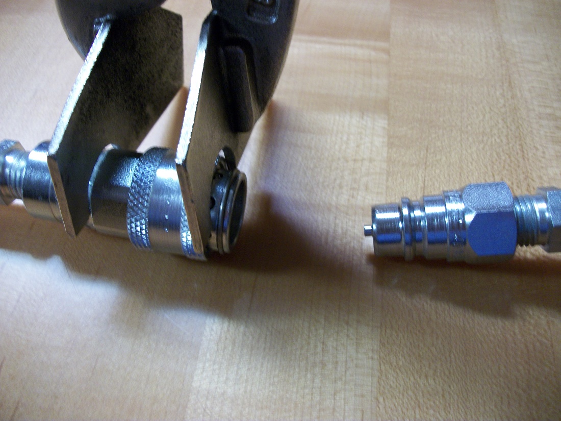

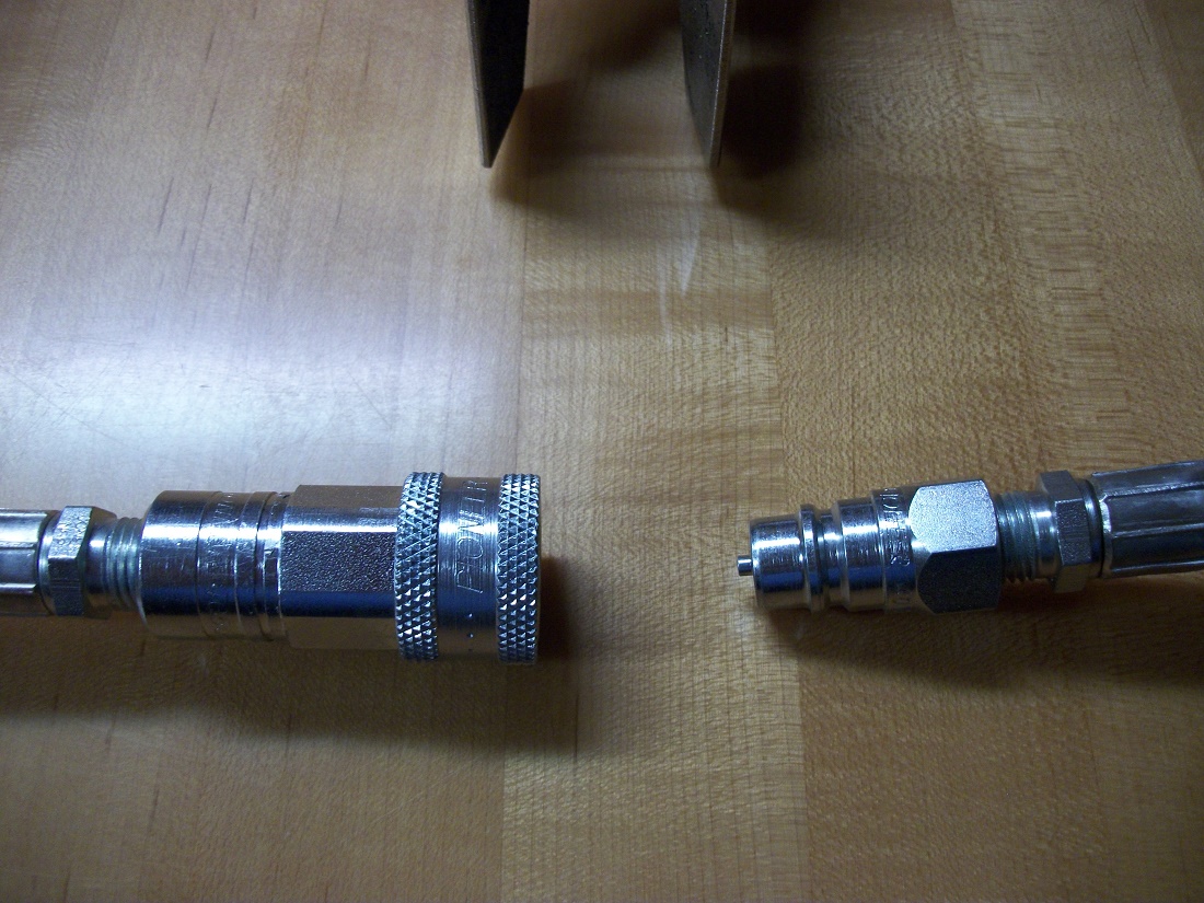

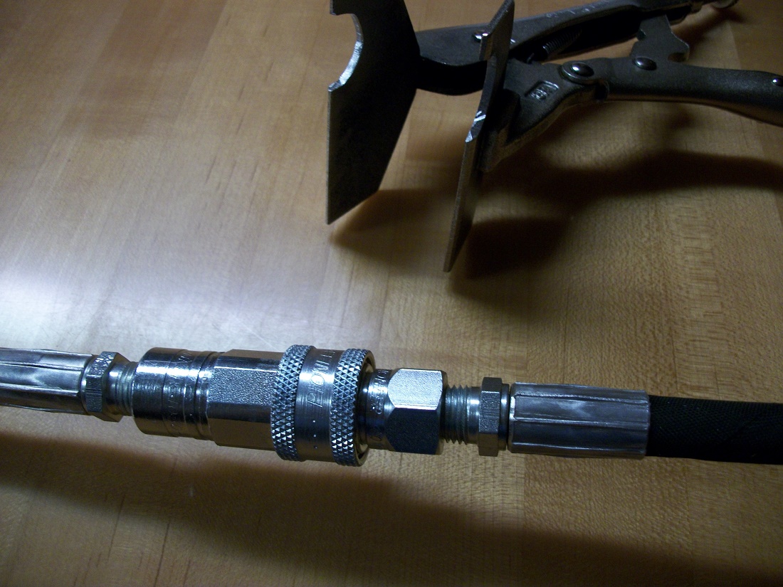

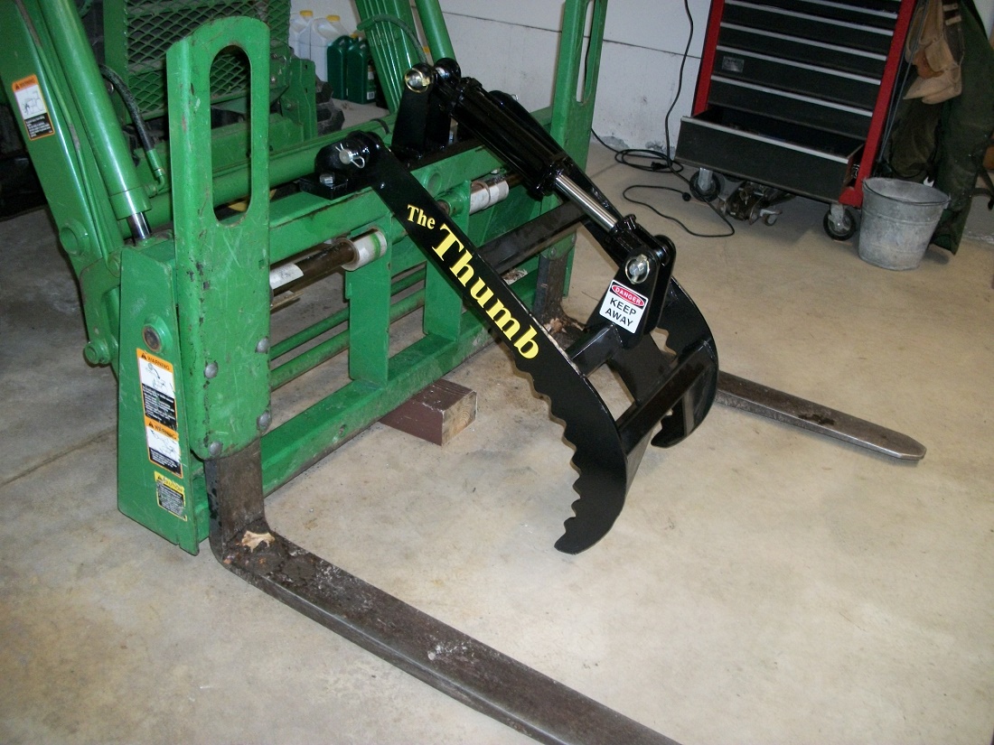

This past year, have been working on adding a thumb (The Thumb) to my Deere forks to hold brush, logs, and spruce trees while moving them around.
Have the 3rd SCV rear remotes and ran two hyd lines to the front of the FEL, with disconnects at the FEL mount, and also at the bucket/fork quicktach point. Did not secure the hyd. couplings so found it challenging with 80 yr old hands to pull back the female coupling sleeve while pushing the male into the female for connection.

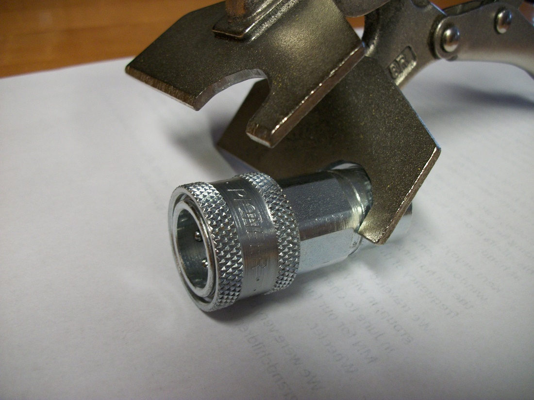

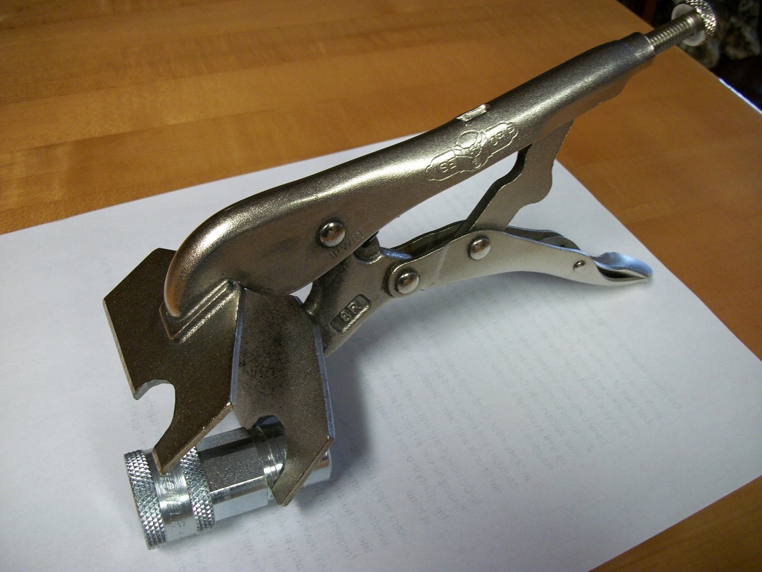

Thought of a pliers of some kind to pull that sleeve back, and today fashioned a model 8R Vicegrip that has flats for sheet metal work to fit that female coupling (1/4" Pioneer couplings). Using angle grinder, managed to get something to fit and it works quite well with the vicegrips locking when the sleeve is pulled all the way back.

Thanks, and no plan to patent.. go ahead.. with my blessing. :)
With my angle grinder, making the two notches in the flats turned out easier than I expected.

These are 1/4" Pioneer couplings.. nothing to do with Deere.. sorry if I misled you.
They seem to have a very strong spring in back of the sleeve on the female coupling. Sliding it back with one hand and simultaneously pushing the two parts together just seemed awkward. Would have worked better if the female coupling was in a header as is usual, then no problem. But I could not figure out a way to make that header and put it in the appropriate location near where the loader attaches to the tractor frame, and where the forks attach to the quick attach on the loader arms. Until then, the modified ViceGrips will do well for me to hook up the hoses.
