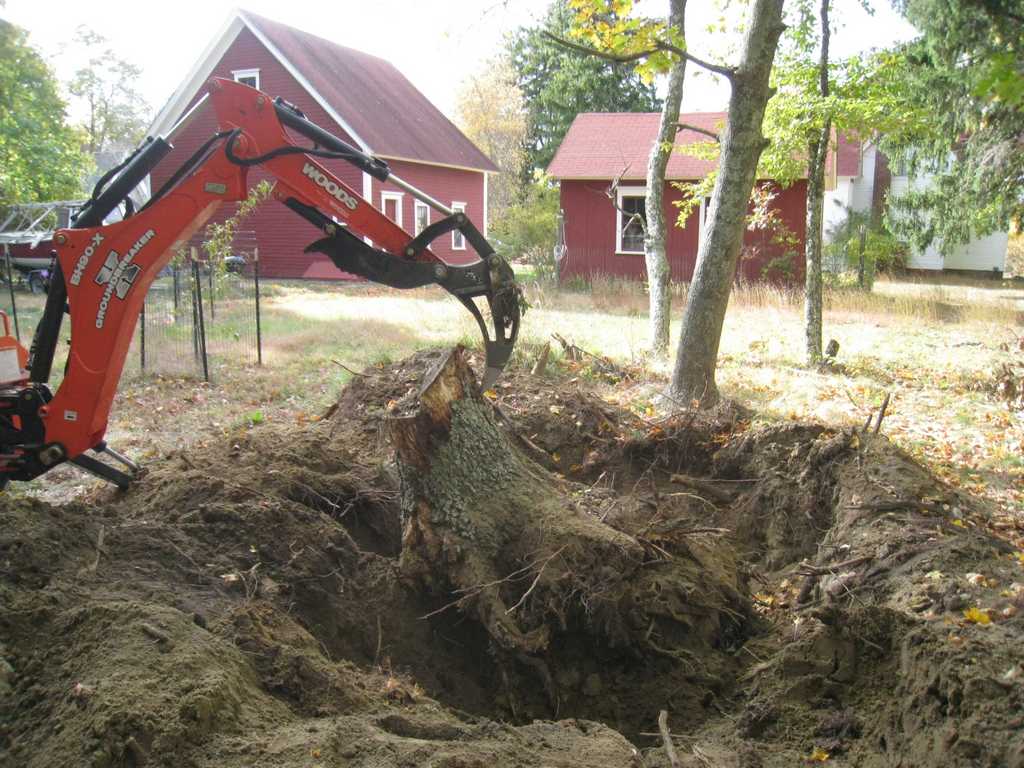

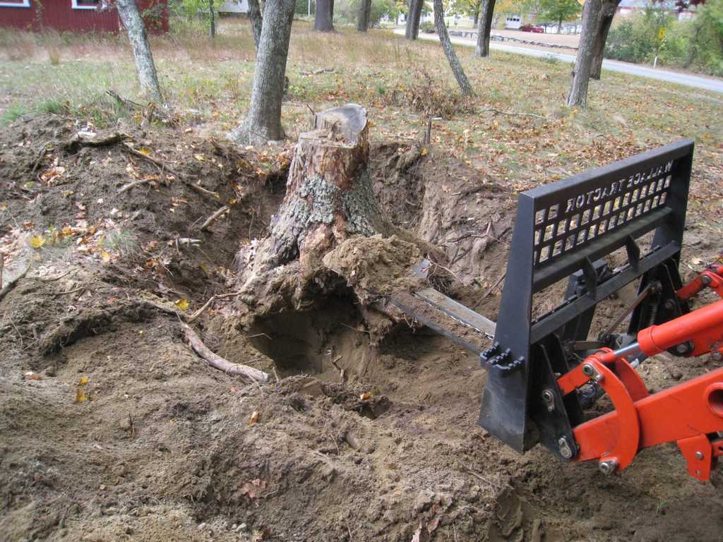

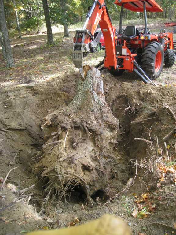

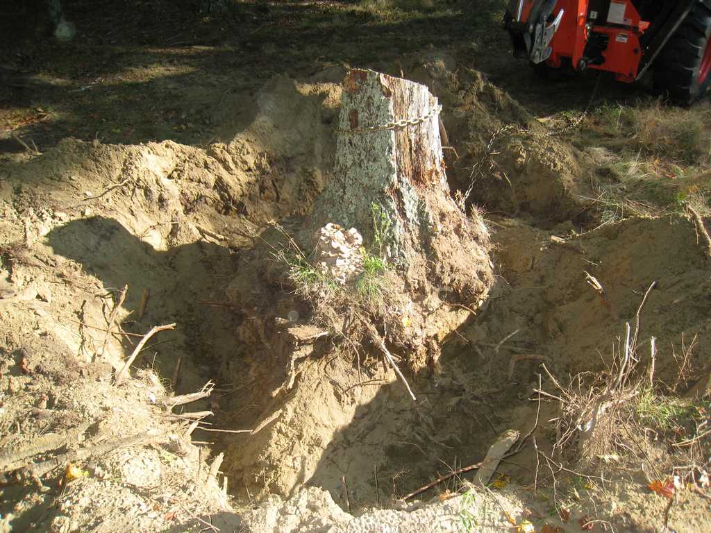

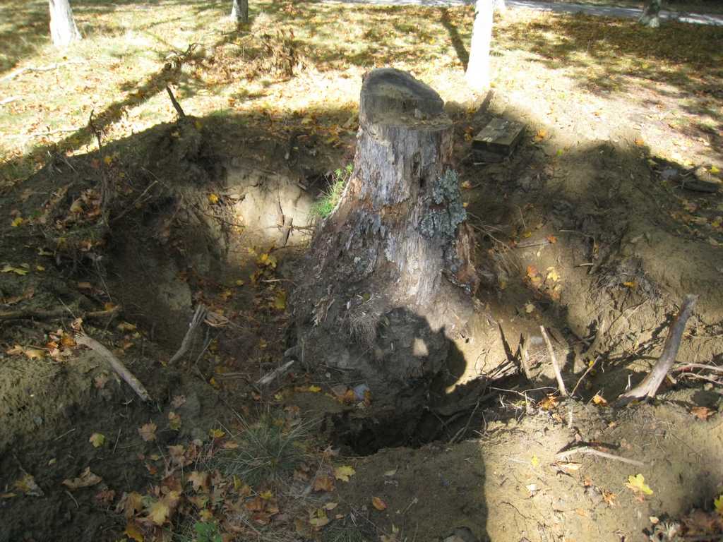

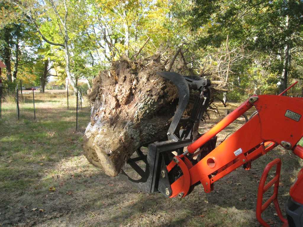

OK, I got a chance to use the ripper on a big stump yesterday so I'll post on my results. Recall that previous use has been on whole trees where the "stumps" came out with the rest of the tree. This current project is a fairly large oak stump from a tree I felled last year. Photos of the stump below.
I started by digging on all four sides with the ripper. No problem getting through the roots at all. In this case the scoop plate (not sure what else to call it) on the upper half of the ripper was very useful as I needed to dig down about four feet to get to the last lateral roots. The scoop plate allowed me to bring up about the equivalent of two or three human shovelfuls of dirt each time. The trenches on each side of the stump got somewhat wider as I dug down as my technique to maximize the amount of dirt scooped included rubbing against the outside of the trench and that gradually enlarged it. By the time I was done digging around the stump the area dug was about three feet wide on each side of a four or five foot diameter stump ball.

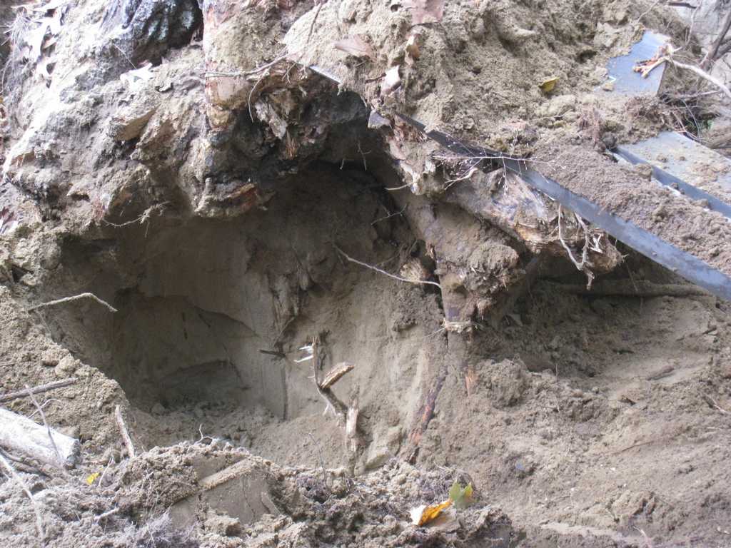

I had clearly severed all the roots at this point but could not pull the stump over when chained and pulled with the tractor. Turns out there was enough dirt around the lower roots that I had to put a shovel attachment on a set of forks and dig about a foot or two of dirt out from one side. The ripper could not do that as it digs down and I needed to get under the stump itself. Probably could have done it with a hose as the soil is sandy. I did try at one point to tilt the tractor so the ripper was at an angle but that was not as efficient as using the forks/shovel.
After fifteen to twenty minutes with the forks shovel I used the ripper to test the stump again and it pulled right out. The stump was big enough that I couldn't lift it with the backhoe easily but I pulled it up over the lip of the hole and then drove the tractor forward to get it out. I then switched to the grapple to take the stump away.
Total time was about two hours with the ripper and 15-20 minutes with the shovel. This was the first big stump I had removed with the ripper and I think it would take less time in the future as I now know how far to dig down and that the ripper itself is as good at testing whether the stump is ready to come out as hooking up a chain and trying to use the tractor. For big stumps it seems necessary to be able to dig out underneath one side so there is no resistance from the ground when you try to pull the stump over.
Score one more for the ripper with an assist from the forks/shovel. :thumbsup:

   / Added a ripper to my Woods BH90x: Trees beware #58
IT,
If a guy didn't have that attachment, and he just used a normal bucket, digging a moat around that stump about a foot further out, and he spent 2.5 hours at it, do you think he'd get it out?
John
#59
jmc said:
IT,
John
Yes, a standard bucket could do this too but there are some differences. I think the main benefit of the ripper is to take down full trees with minimal disruption of land. Because I had to dig down so far to unearth the stump I made a hole about the same size as if I'd used a bucket. However, it was a lot easier to rip through the roots with the ripper. I've done this same job with the standard 18" bucket and many of the thicker roots were hard to deal with. The ripper cut every root pretty much the first time it made contact. Still, the difference is not great. It does show that if you are out hunting trees and stumps you don't need to change back and forth between ripper and bucket.
