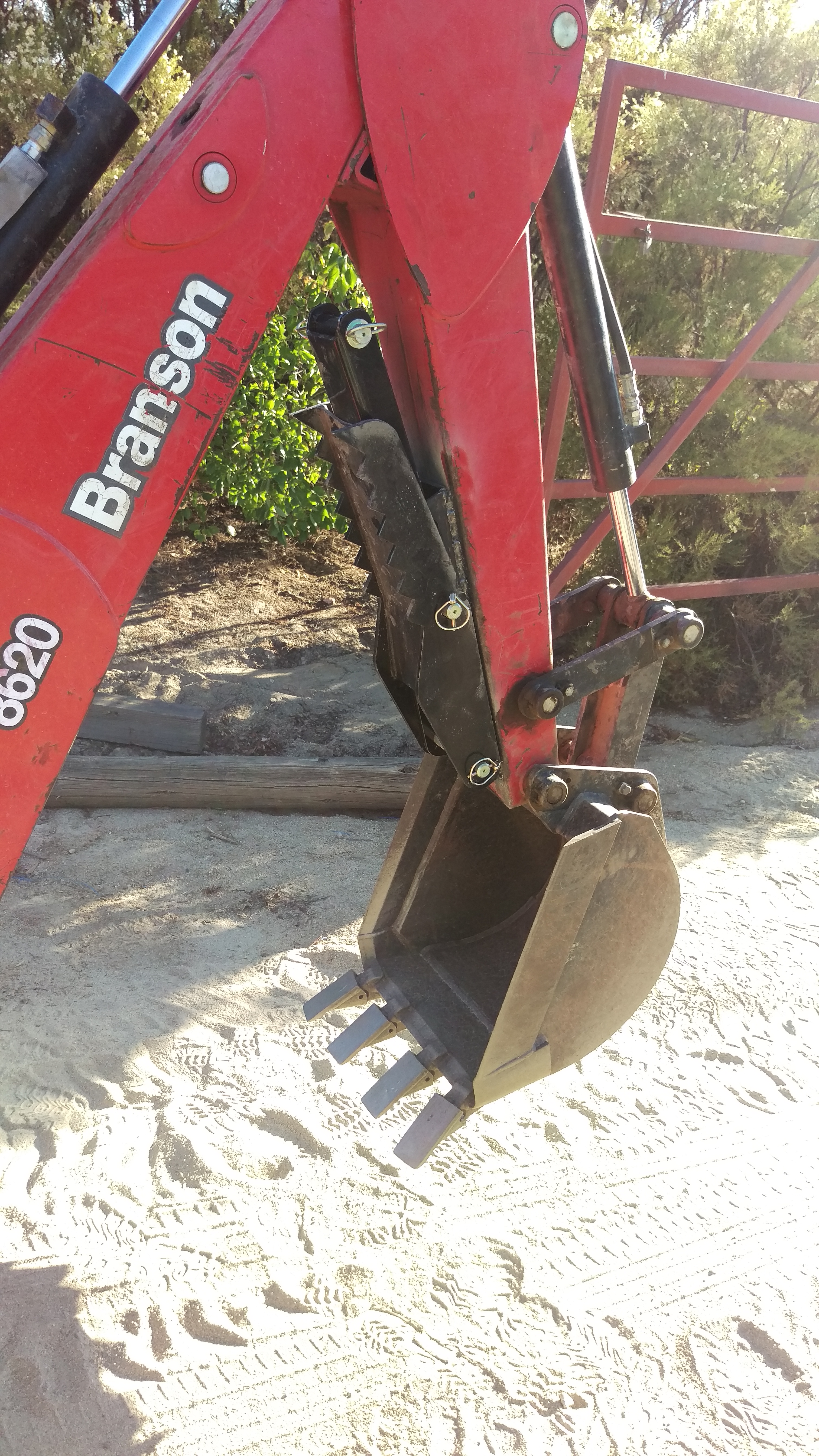

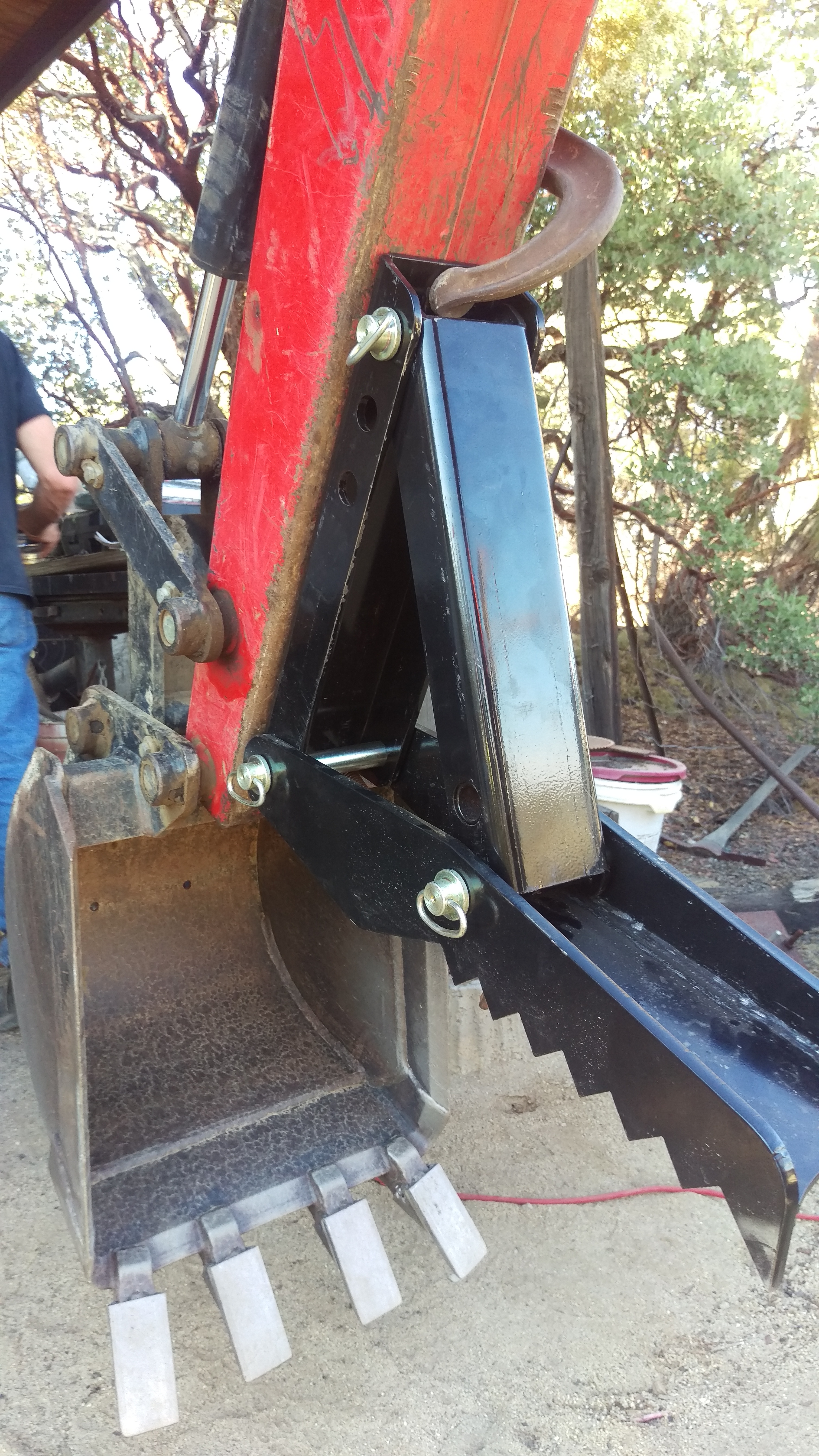

I bought a Titan 24" weld on thumb for my 8620, got it installed yesterday. Seems to be very strong and the perfect size. Ill be getting a lot of use out of this thing soon!

I haven't been around backhoes all that much. What does the thumb do for you exactly?
   / Added a 24" thumb to my 8620 hoe #3
Grabs and holds.. Good for solid objects like logs and rocks..

Similar to a grapple on a front end loader?
Nifty
yes,exactly. But manual thumbs can be put on a bh as the bucket moves and can 'squish' the load against the thumb without having to add additional hydraulics like you do for a grapple.
Hydraulic thumbs are available and are nicer and more controllable but manual versions are big sellers because of the simplicity and price.

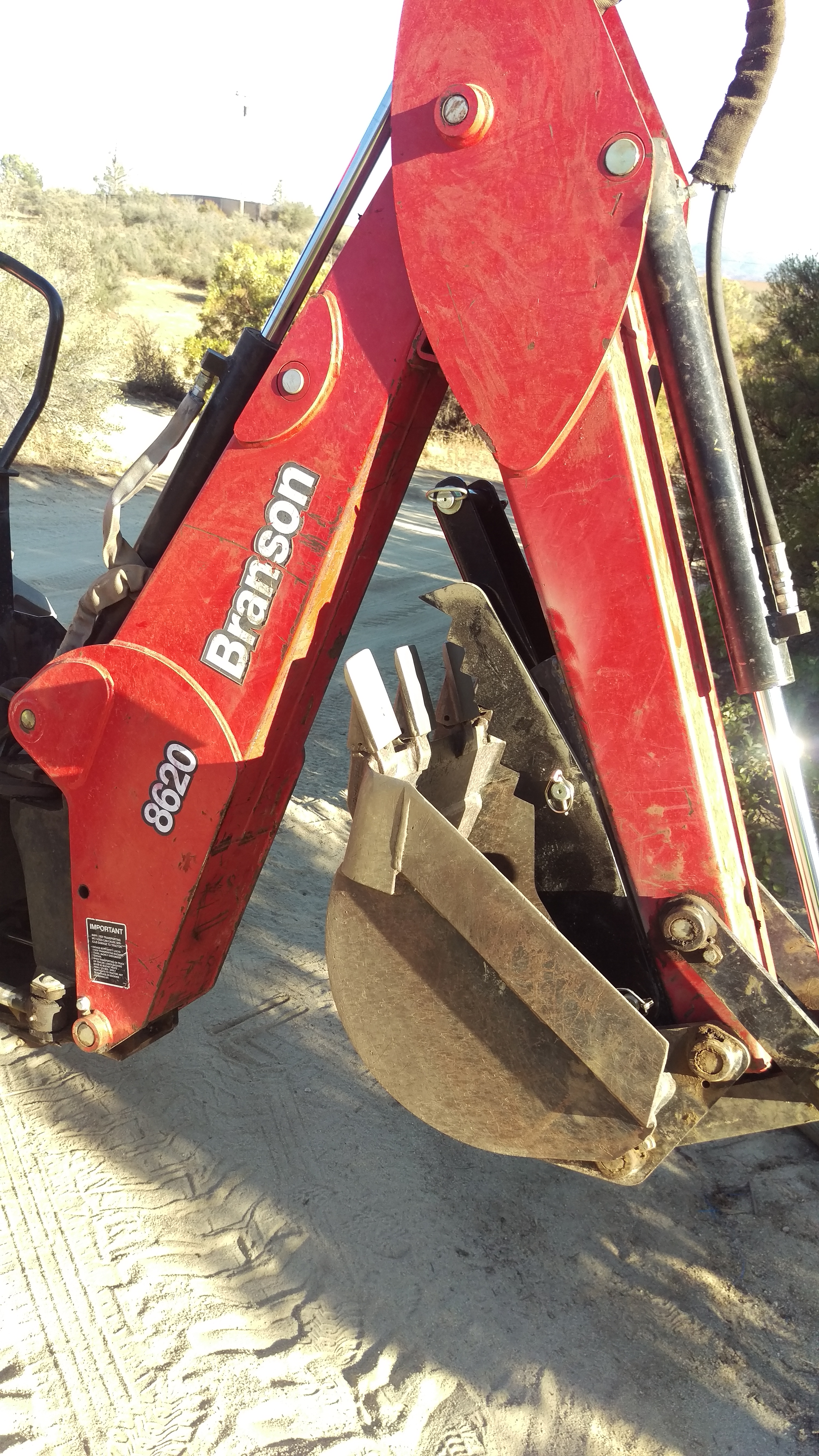

Used it a lot this weekend moving heavy rocks as I cleared for an uphill road to put in a water tank. I'll post pics later, worked beautifully.
