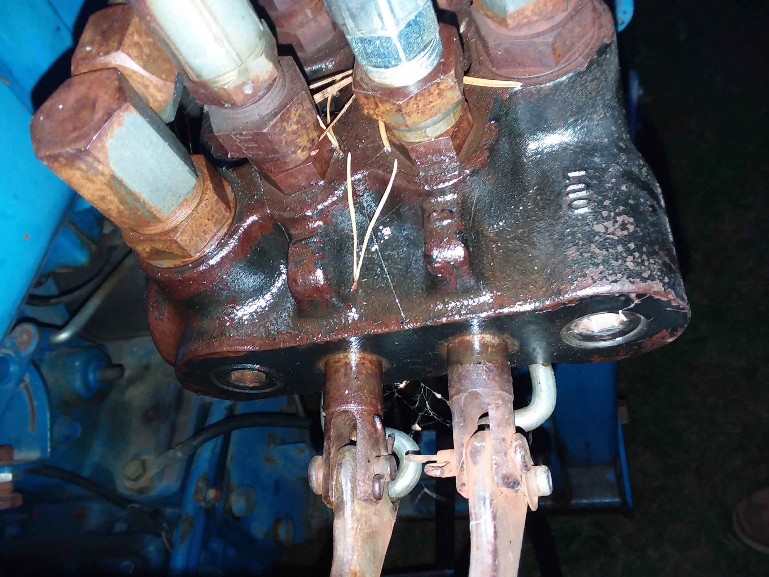

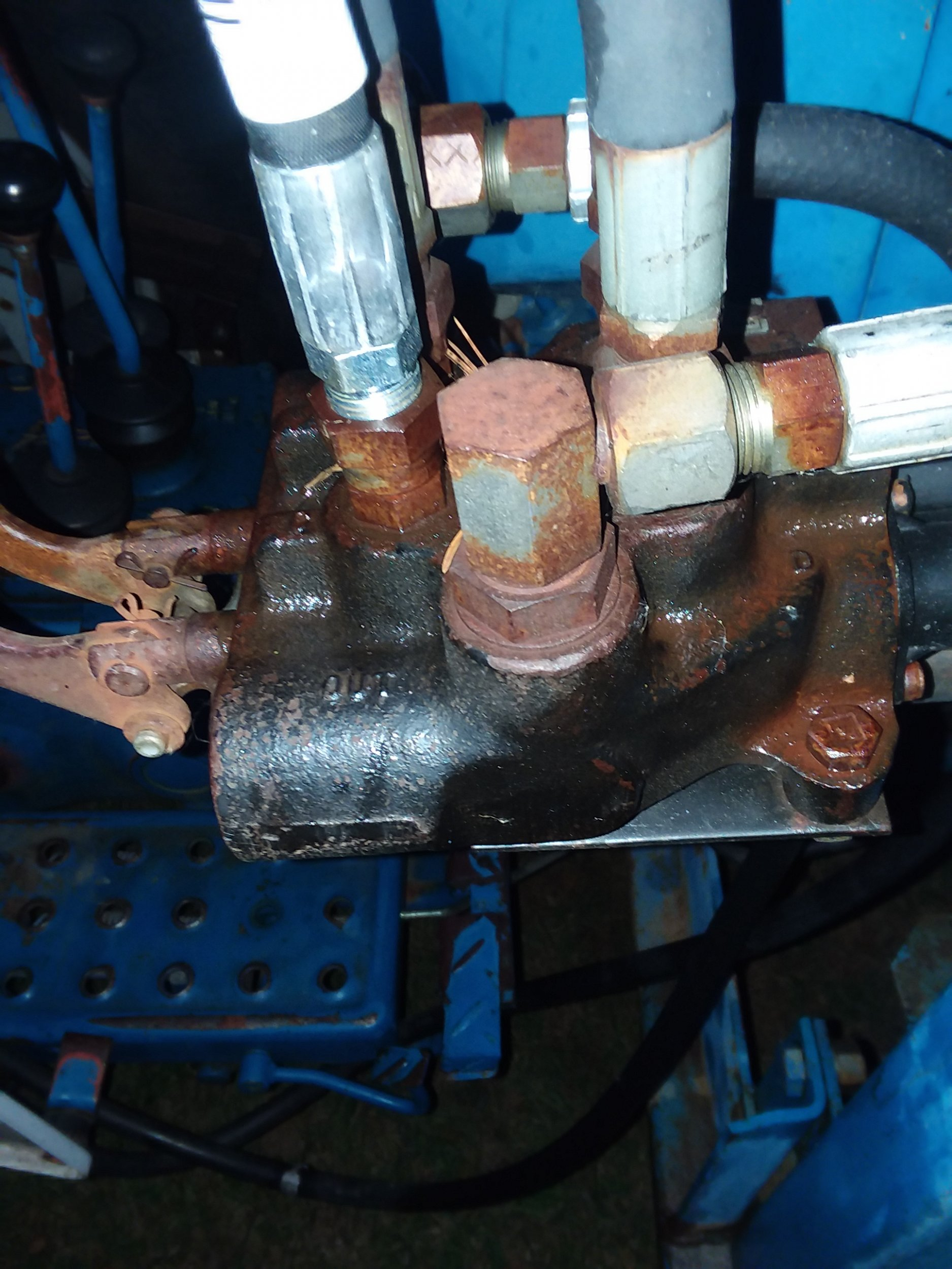

Aug 24, 2022 / Add rear hydraulics to a ford 1600 tractor #1 K kbeckett New member Joined Aug 24, 2022 Messages 1 Tractor sb4FdDWR3hxFKvn I don't know if this is even possible but i want to un hydraulic lines from my loader controller valve to the rear for 3 pt hydraulic attachments It looks like an in and out port is available on the controller. Any help would be appreciated. Attachments 20201017_182240.jpg 2.6 MB · Views: 117 20201017_182255.jpg 2.2 MB · Views: 108

Aug 25, 2022 / Add rear hydraulics to a ford 1600 tractor #2 Rich B1 Veteran Member Joined Jan 28, 2017 Messages 1,122 Location Stone Creek, OH Tractor NH TC21D, 3 Craftsman GT’s…..old but tough, AGT Industrial QH 12 You need to find the PB (power beyond) port on your loader control valve, if it has one. You can run a line from PB to the rear valve, then to PB port on the tractor near the pump. You will also need to run a tank line.

Aug 28, 2022 / Add rear hydraulics to a ford 1600 tractor #3 W Whitbread Silver Member Joined Apr 30, 2018 Messages 162 Tractor Massey 1740M I added a 3 spool valve to my 1620, here's some pictures of how i did it. Adding rear remotes to 1620
