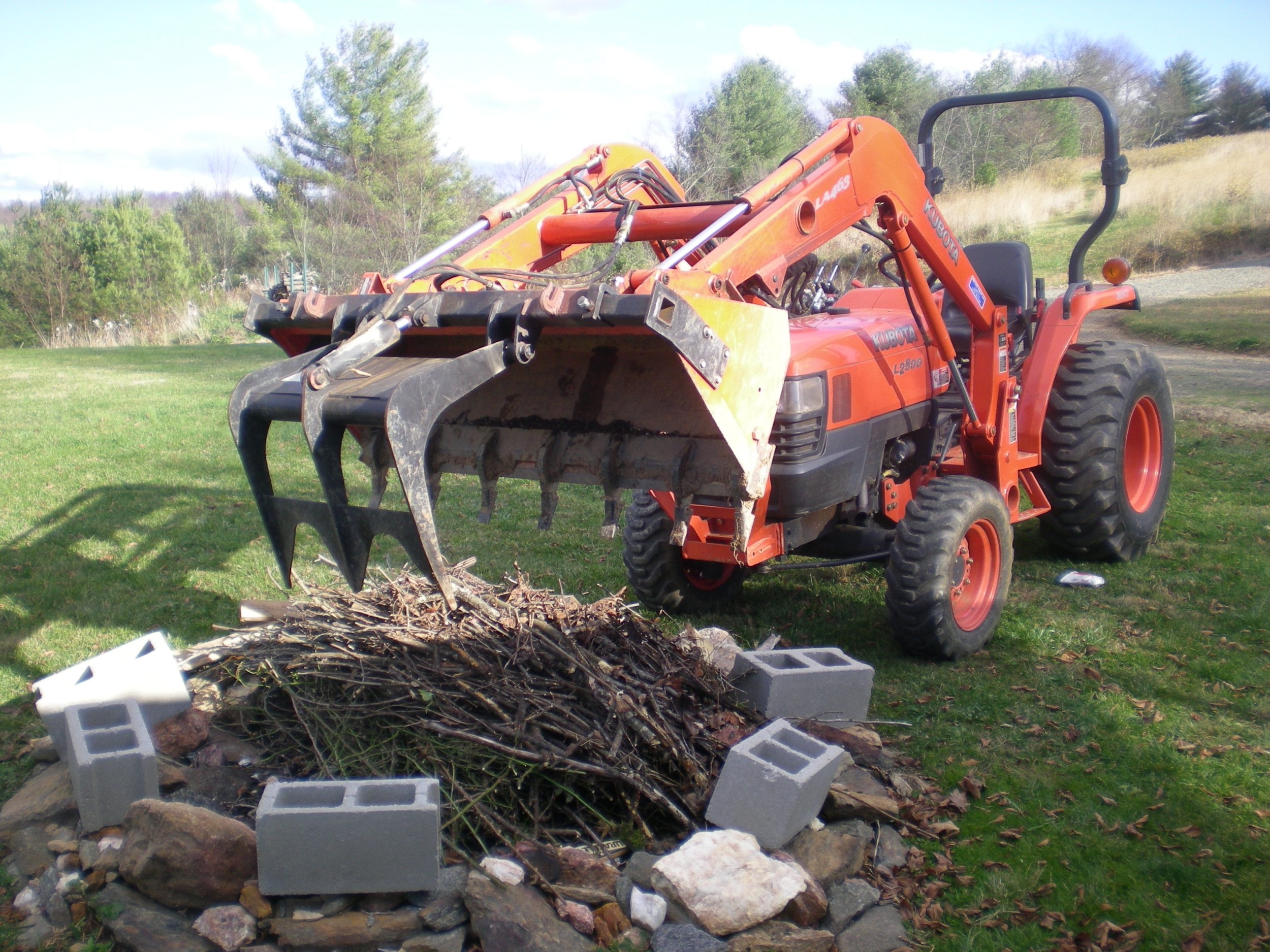

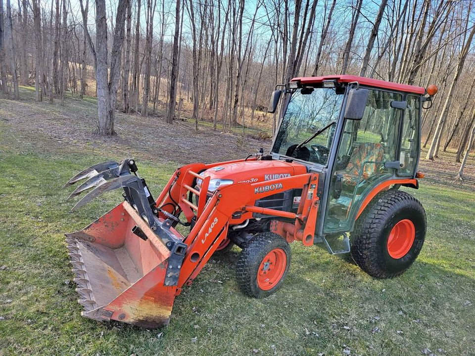

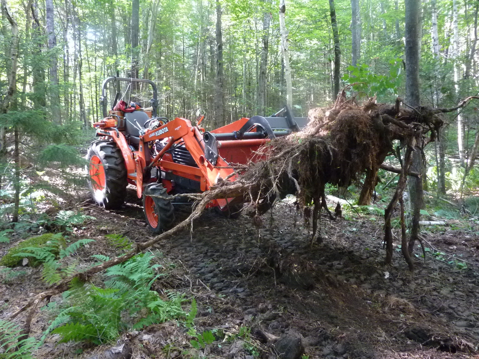

I would like to understand what would take to install a grapple to my bucket, similar to this Kubota B3030:
I suspect I'd need to install front hydraulics and buy the grapple? Is this correct?
And should this be done by the dealer or possibly a DIY project?
My end goal is to be able to move brushes and tree limbs with ease.
Thanks in advance.

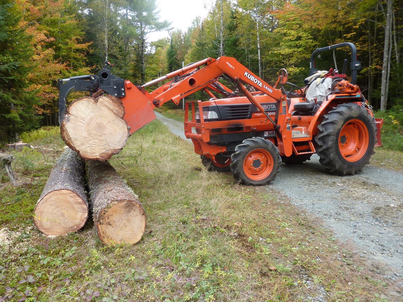

This is how I did mine back in 2011. It is on an L3010. Much cheaper than a kit but more work.
Finished 3rd Function Valve Project

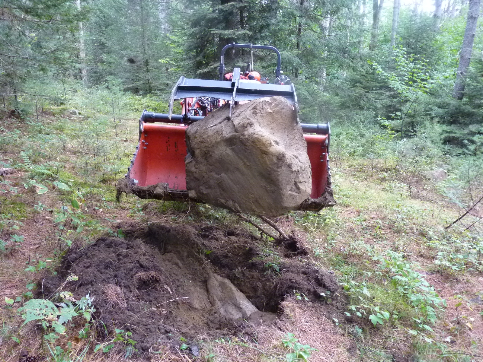

Very impressive. But for someone with limited manufacturing resources, a $925 pricetag for a kit is not that bad, really.
But I have to ask: what is the capacity of your loader? :oops: :oops: :oops: :oops:
My LA504 has a pivot pin capacity of ~1,000 pounds. I suspect you are moving a lot more than 1,000 lbs... I have a lot of ash tree logs to move around.. I hope my FEL can work as good as yours..
   / Add-on Bucket Grapple for a Kubota 3200 - DIY or Dealer install? #10
LA504??? This is the WR Long valve kit... the one above was for the photo you posted...
I would also recommend a tooth bar in combination with these grapples...
