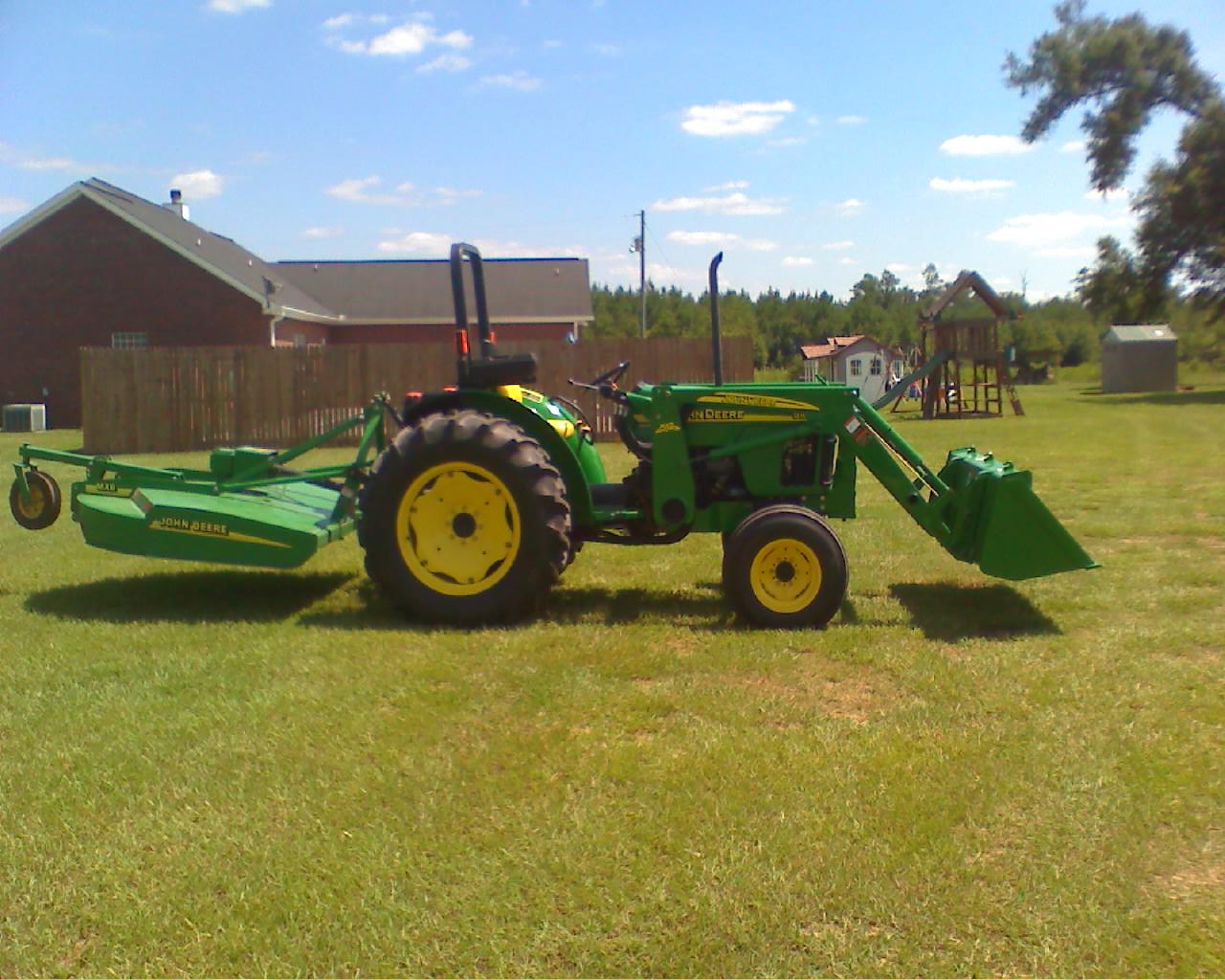

I worked for years on the dairy farm with 2wd tractors and loaders, only time we had real trouble was with baleage on Ice conditions. Set of tire chains and a ton of concrete all but cured that problem, We still have trouble with the 4x4 at times, I would get a heavy ballast for anytime you are doing heavy loader work but for general use you should be fine with just the mower on back. I'm guessing you don't have much ice trouble in Mississippi.

My 2008 Mahindra 5525 (54 hp engine, 45 hp pto, 2WD, power steering, partial constant mesh tranny, 5370 lb without FEL) has the ML250 FEL (6-ft wide bucket, 10.5-ft lift height, 2980 lb lift capacity at the bucket pins). It's comparable to your 5105, but is about 1000 lb heavier (without the FEL). No problem so far using this rig. I have the skid steer quick attach option on the FEL (which I like and strongly recommend). My rears aren't loaded, but I'll fill them next month in preparation for hayfield plowing.

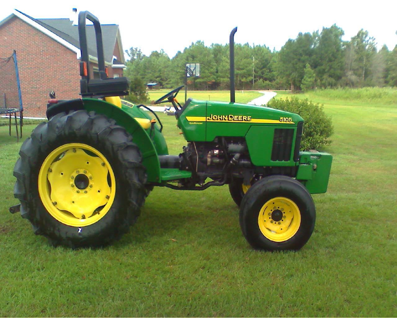

I have a 2WD 5105 John Deere with approximately 250 hrs. Unit has 14.9-28 rear tires loaded with water and two remotes at the rear of the tractor. I use this tractor for basic gardening/farming. I got a really good deal on the tractor and have been contemplating adding a FEL. I have a neighbor that has a 2WD 5205 with 16.9-28 rear tires also loaded with water. I have used this combination multiple times and the only thing I have noticed is that with a bucket full of material you can lose traction. I added a box blade to the rear and it helped significantly. The area I operate in is basically flat with well drained soil. I am trying to decide if it is a good idea to add the loader to the tractor I have or look for a different unit with the loader already on it. I realize the benefits of a 4WD unit, especially with the loader, but my main use for the FEL would be to maintain roads primarily by pushing limbs out of the way when mowing. I am curious if anyone is running a FEL on a comparable 2WD machine with good results or has done what I am considering and wound up swapping machines. Any advice or recommendations?
Here's my advice: It would be better and not much more expensive in the long run to just buy another tractor like this. Why spend 4-5 grand on a loader when you could have a good 64HP 4x4 tractor and loader together for 7 grand? I think this is a great deal:
