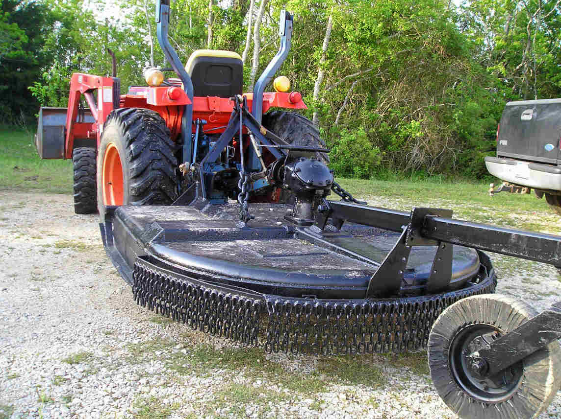

Rob,
This is my Servis-Rhino 5' mower. The chains are attatched to a bent bar that is bolted to the mower frame every 6" - 8". The chains are free to move. I hope this helps.
jb

Great, more good ideas and thanks Jimmy, for showing me that photo of your Rhino chain guard. That gives me a good visual of what to do.
So the consensus is to leave the chain as separate dangling strands, without connecting them at the bottom. I see that Rhino guard is like that too.
Another question, how far apart should I place them? I see schmism has his (appears to be) about 2" center to center in his sketch. I would like to do that too.

Glad I could help. It's too dark now but I'll try to remember to take a few measurements in the morning and send them along.
