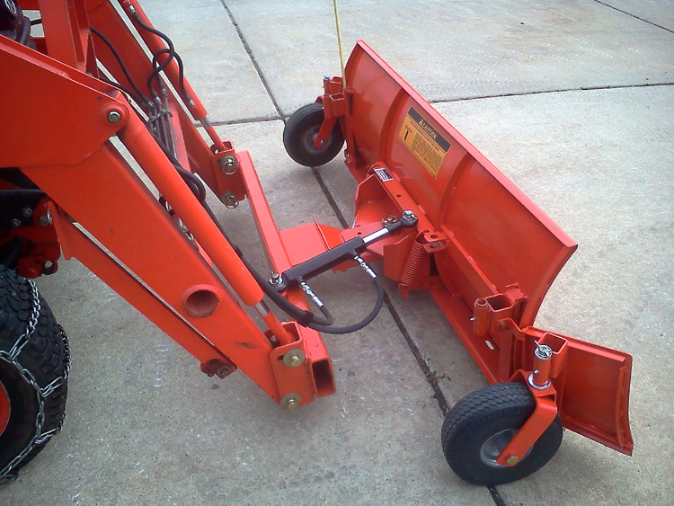

For those of you that are having issues plowing gravel driveways you might consider using gauge wheels. The picture shows the plow that I used for several years with homemade wings and gauge wheels that have solid rubber tires. With the loader in the float position and using the curl function I would angle forward to scrape the cement garage apron and then tilt back to have the plow ride on the gauge wheels for the gravel part. This plow was only about 6 feet wide and didn't weigh that much so heavier plows will have to use wider tires (so as not to sink in unfrozen gravel) or just double up the tires on each side. I moved and had my drive asphalted this summer so I now have a new plow with only wide shoes on it. Can't wait to try it.

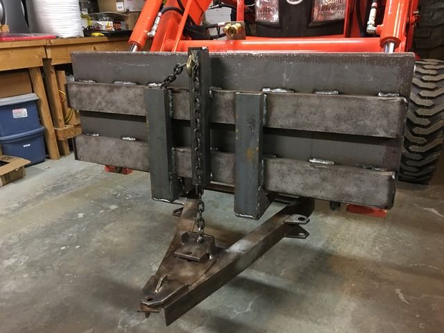

Well, I finally finished welding the quick attach conversion up. It was my first time welding. A few welds look pretty good, then, some look downright ugly. But, in the end I believe that the pieces are sufficiently stuck together.
Now it is a matter of blasting and painting them. Not sure that I can do much until I get some available time with above freezing temps. Moisture tends to reek havoc in the 150' of air hose from the compressor in the garage to the blasting booth in the barn.
   / Adapting Truck Snow Plow to Quick Attach #50
ugly, but it looks sturdy. I like the backset part to keep the plow closer to the tractor rather than hanging way out front like mine.
