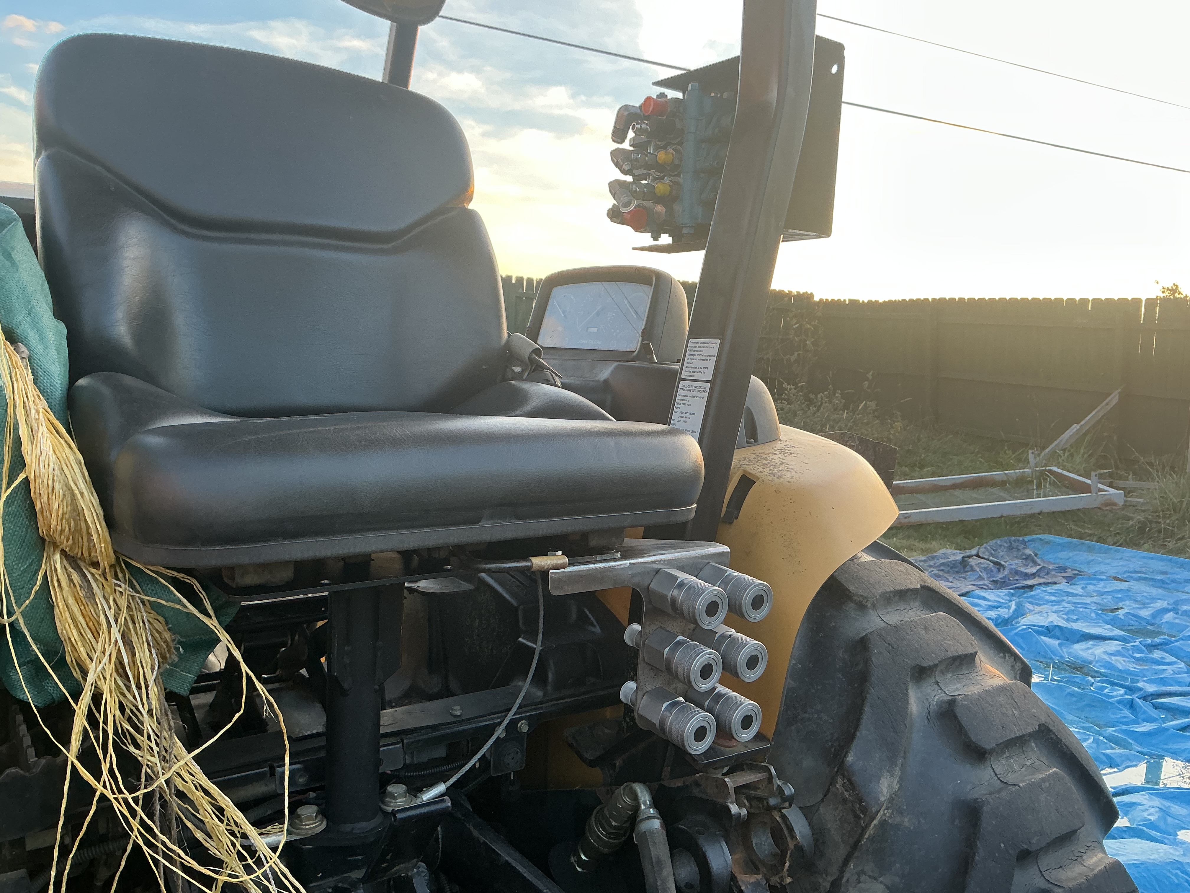

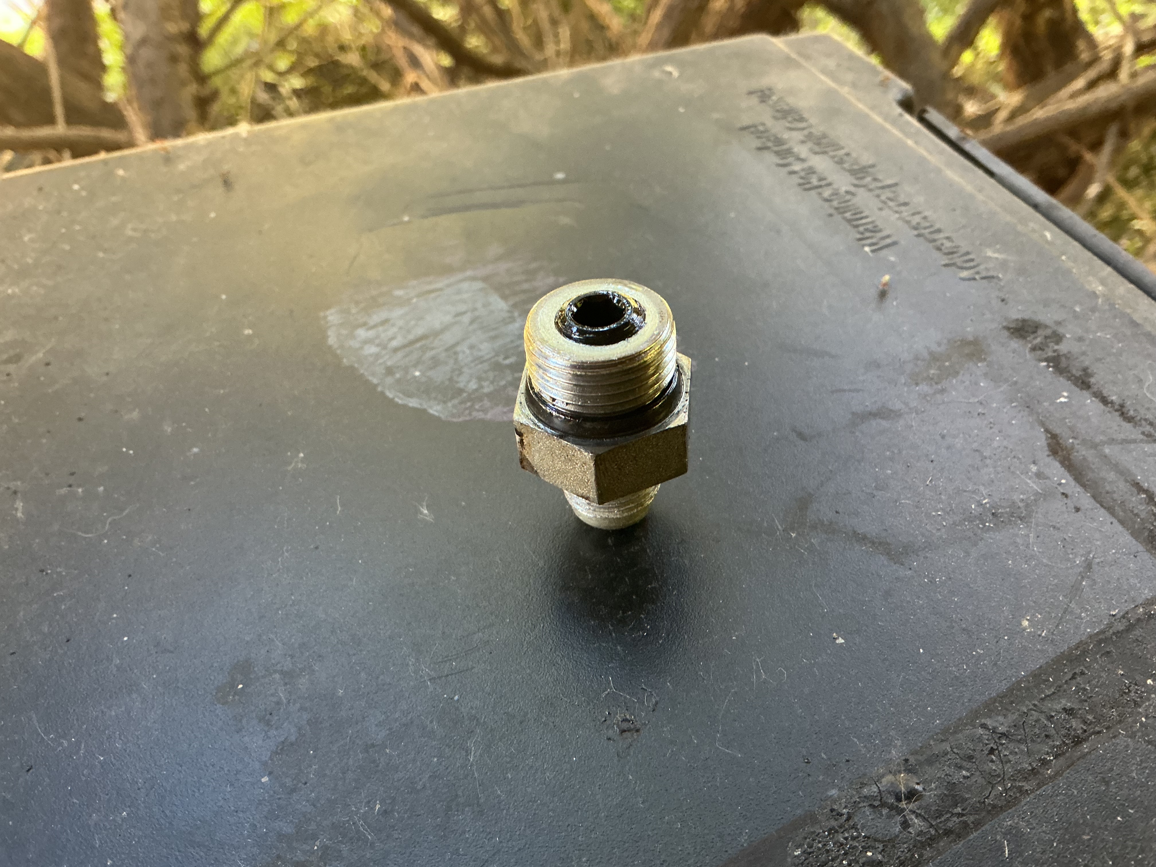

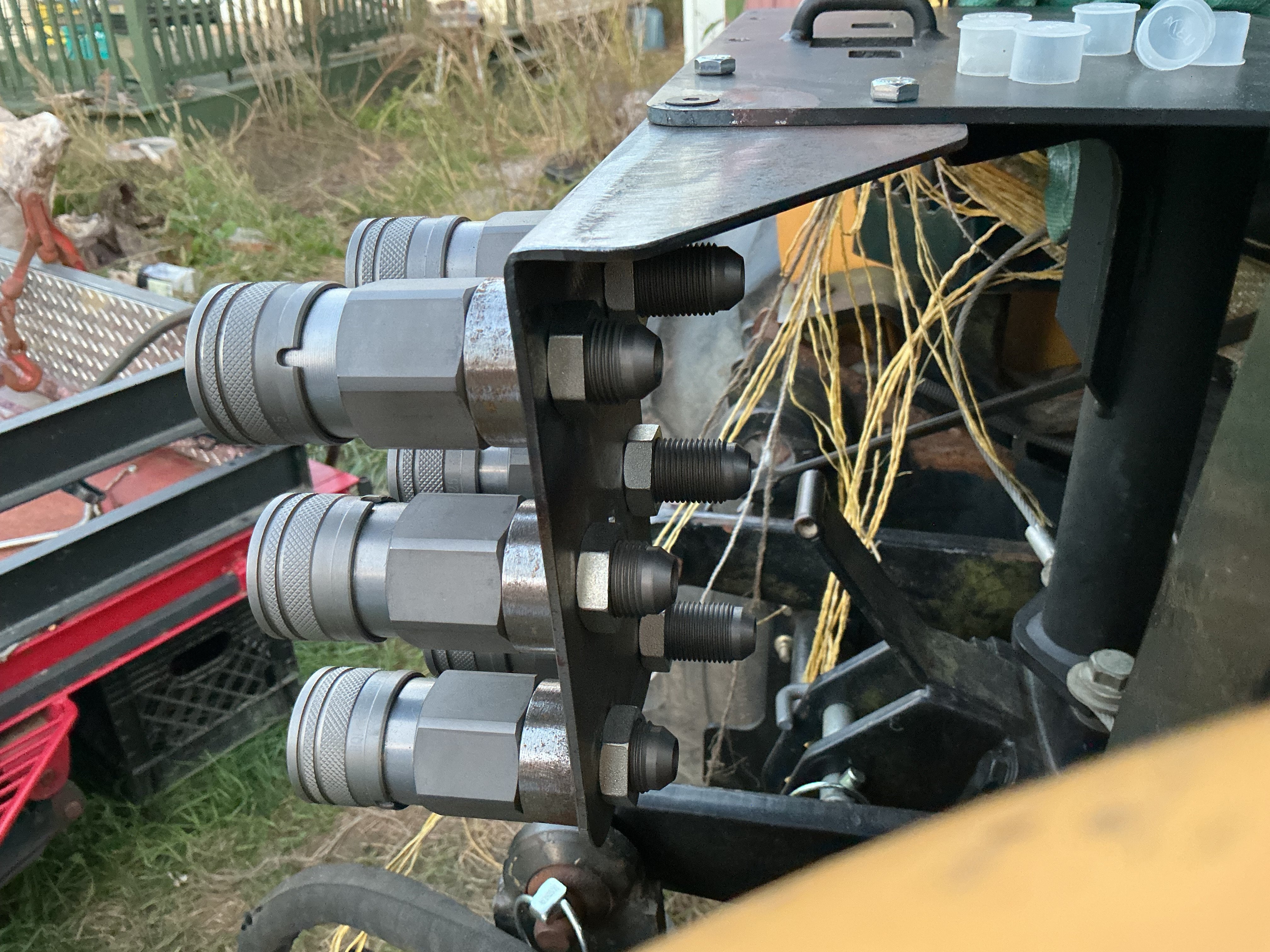

This project has turned out to be more complicated than expected and I’m barely halfway through.
I simply want to connect a control valve to the quick couplers. The control valve has six 3/8” male JIC ports with 9/16”-18 thread. The six quick couplers have 3/4”-16 male JIC threads.
So simply put, I want to connect a steel line to a device with a 3/8” male JIC on one end and a device with a 1/2” male JIC on the other.
It seems like a simple process but I can’t find a way with either 1/2” or 3/8” steel lines. Is this possible.

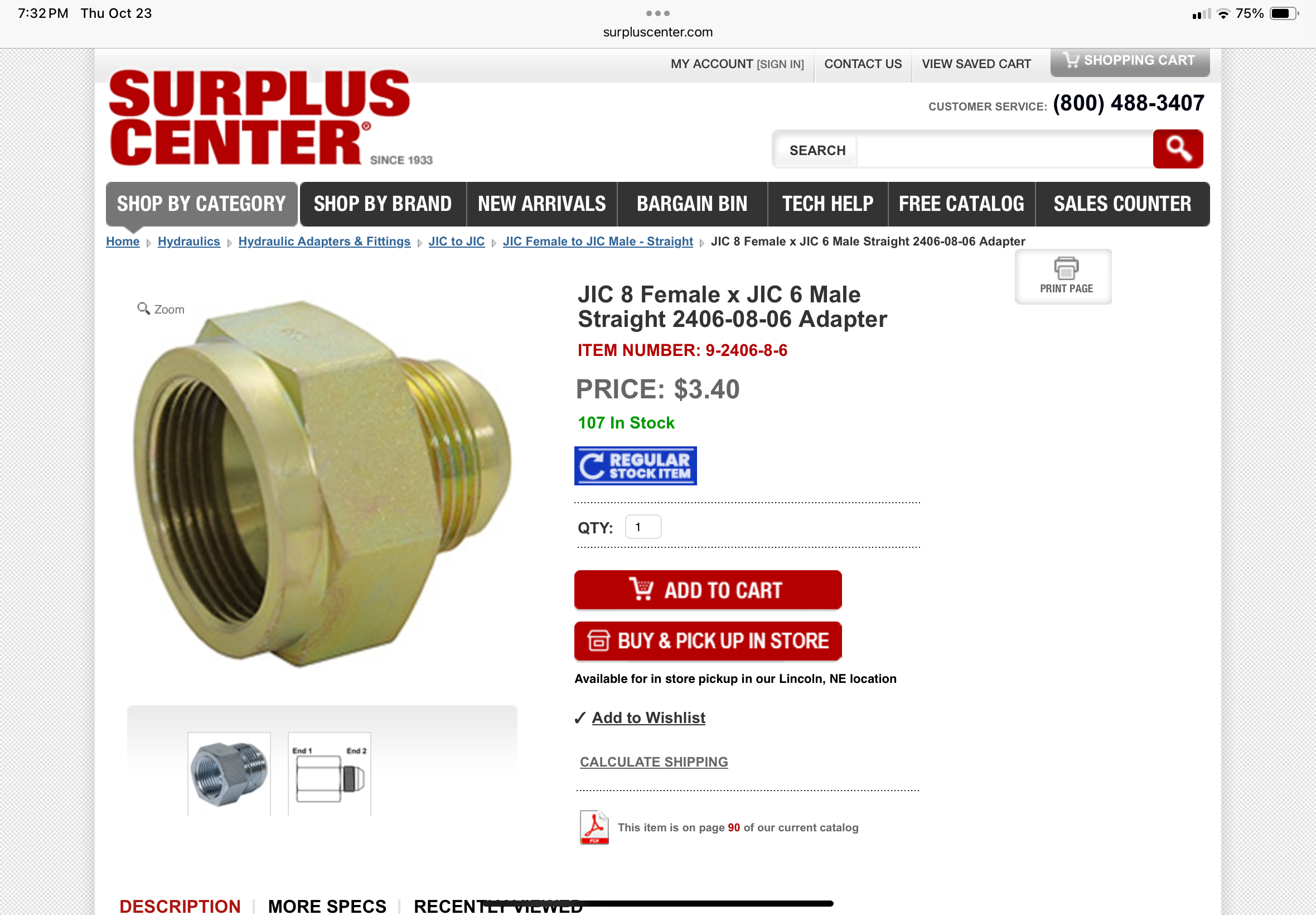

   / Adapting JIC from 3/8” to 1/2”? #4
I have ordered from them for years. I really like their hydraulic hoses.

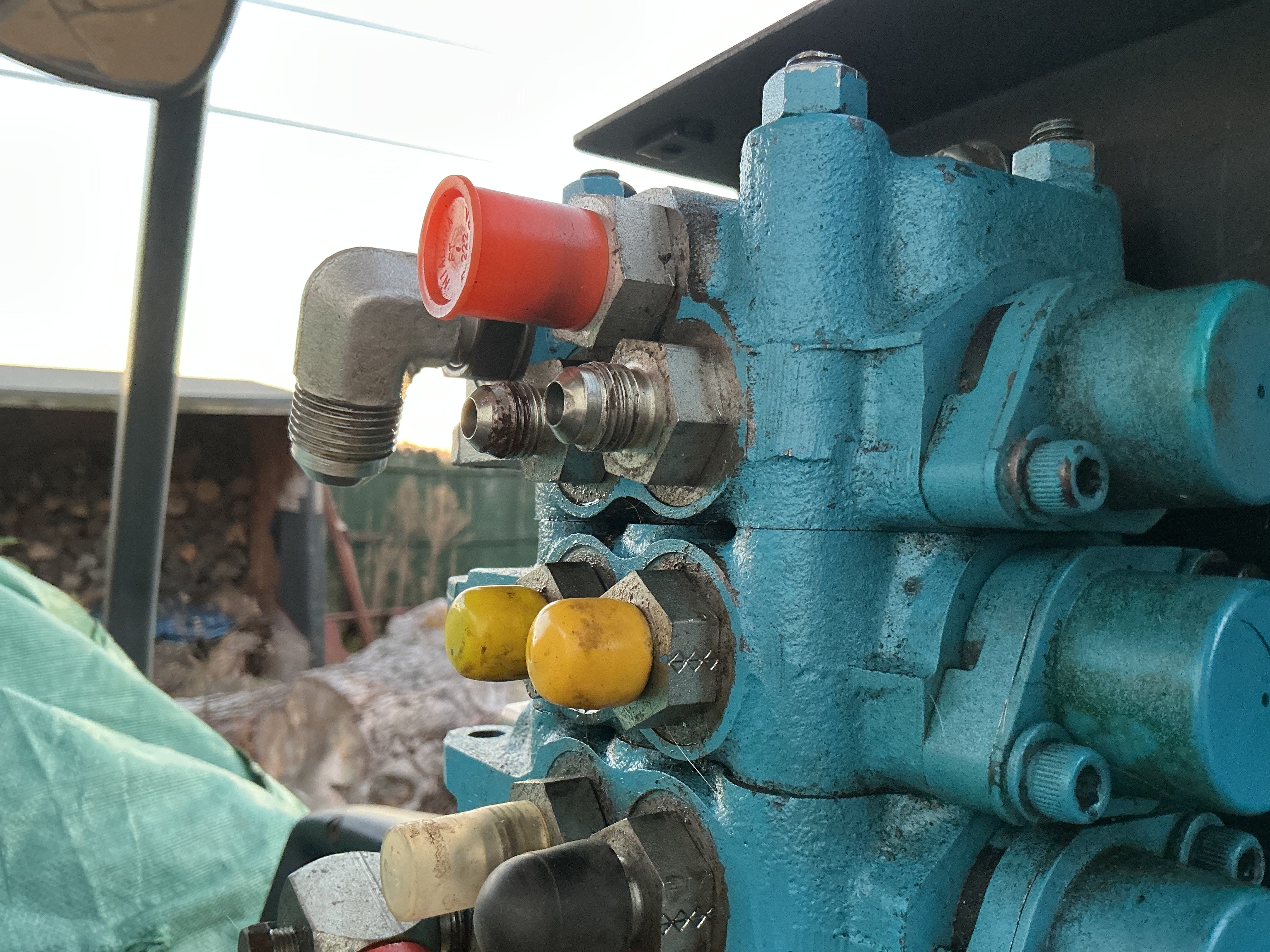

The valve has adapters screwed into the ports, they are most likely ORB/SAE ports. So, just get different adapters.
