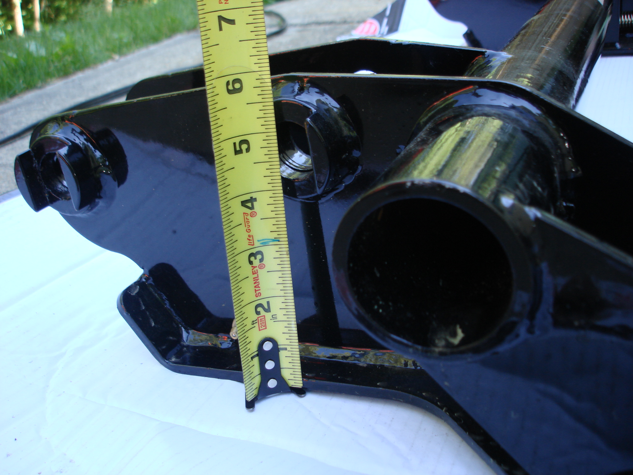

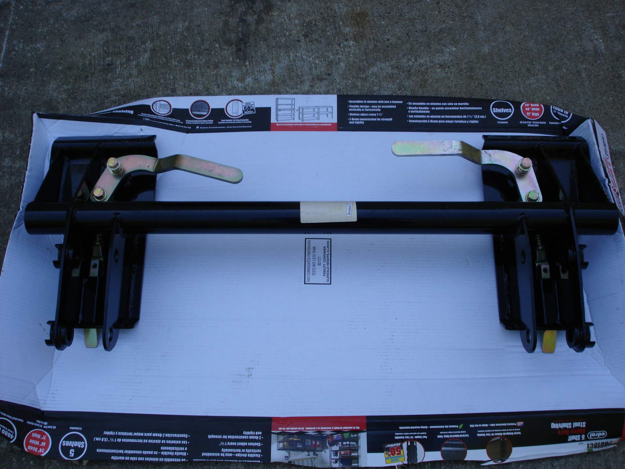

Hi Victor, from looking at the pictures of the new QA and mine, I think it's the same thing. Now...to get creative and convert my bucket... See pictures
/ Adapt KL 130 loader bucket to quick attach #14
Hi Gus, From the pictures, I think you made the right choice. You're only moving out 5 inches instead of @9 inches and the unit seems to be built more equal to the @1200 lbs. lift that we have which saves weight.
Kioti Dave mentioned a good way of getting things set up for the bucket plate. Once you get the old flanges cut, the worst is done. Or should I say you're beyond the no return point. Just kidding. :) I'm sure once you get started, it will come together without much worry.
I hope you can post a final picture when done.
Vic
