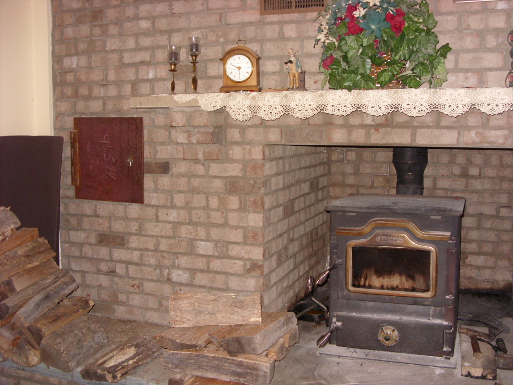

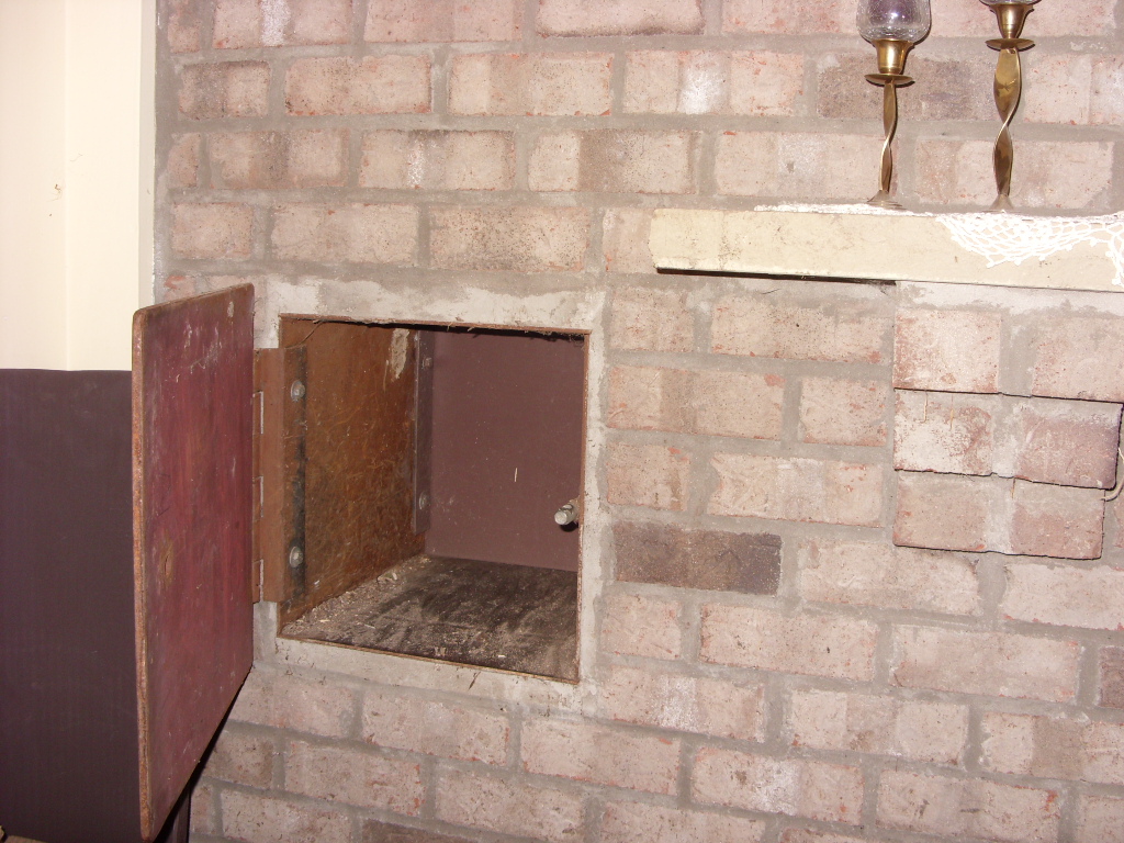

When I was building our fireplace and laying the brick up my wife asked why we couldn't do that and I replied i never thought of it . It was a great Idea. the opening is about 16"x 16"and I made a steel box with doors on both side and I put pin latches for locks(I just put hitch pins on both sides). I have a large hearth and just open the door and stack about a weeks worth of wood on the hearth. I would highly recommend some version of a door close to the stove I would do it again. I just love my wife.:D:D:D

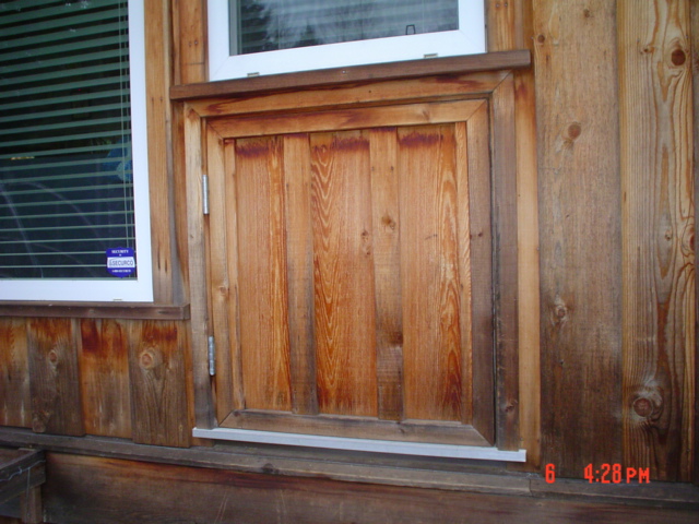

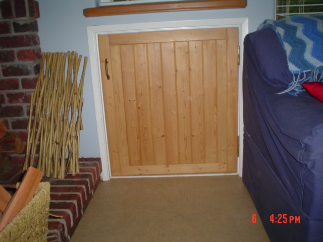

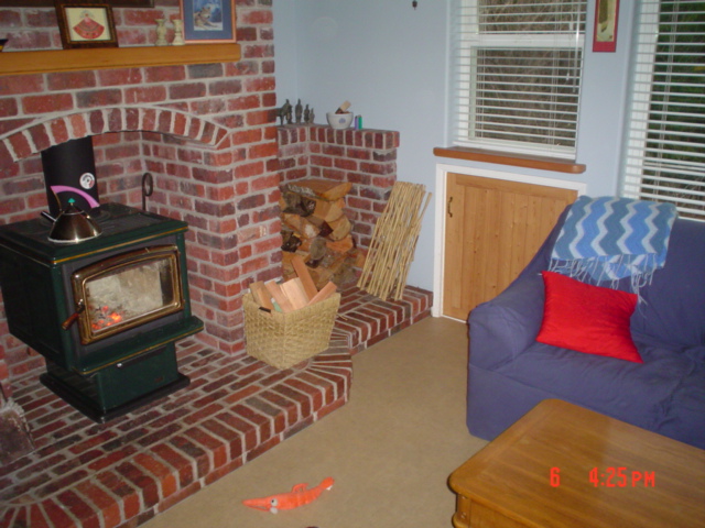

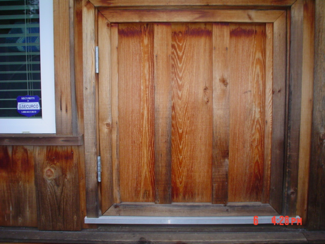

Here are a couple of pictures of my neighbor's firewood door. They had this done when they added this addition a few years ago. Sure happy with it as it keeps the house much cleaner. I think the size would need to fit your house so didn't measure the door.
