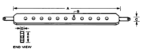

I have my Cat 2 Pat's, but no tractor. Won't be here for 2 weeks. Is there any way to hook up a drawbar with the Pat's units installed - or do you have to take them off? Doesn't sound like it's too bad to take them off/put them on, though.

/ ? about Pat's ez change install #11
Are you wanting to use this type of drawbar? (See attached)
If so, no nothing special to do to use it. However it will pivot so you may need to fabricate something to combat that.
