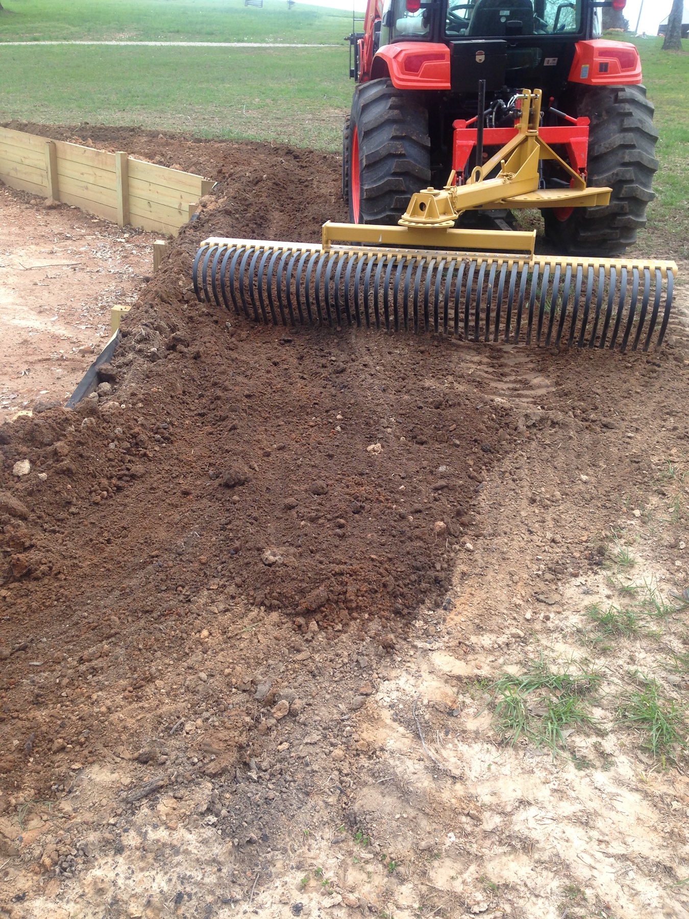

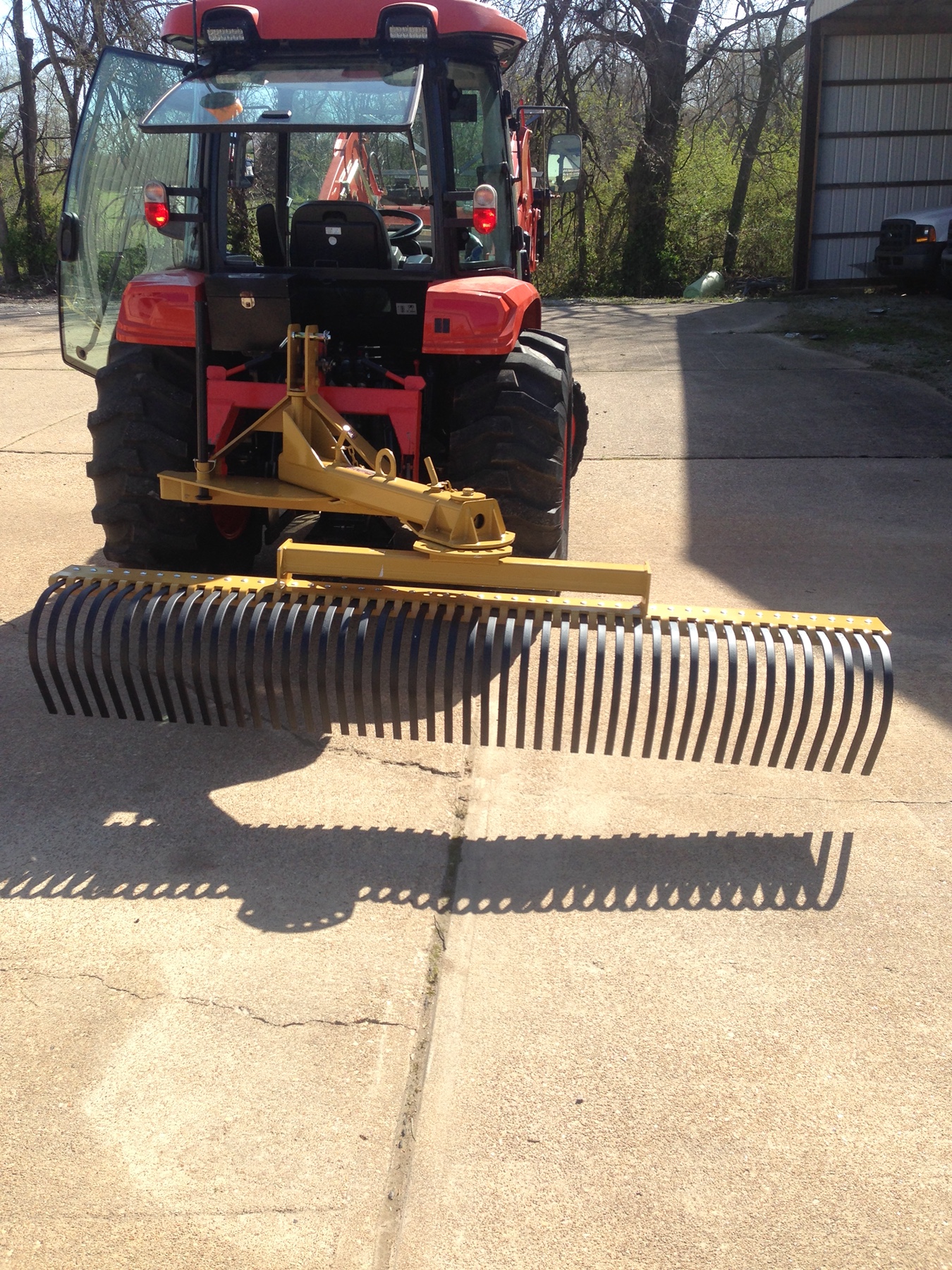

I went with this same setup, worked out really nice. IMG_3134.JPGIMG_3159.JPG

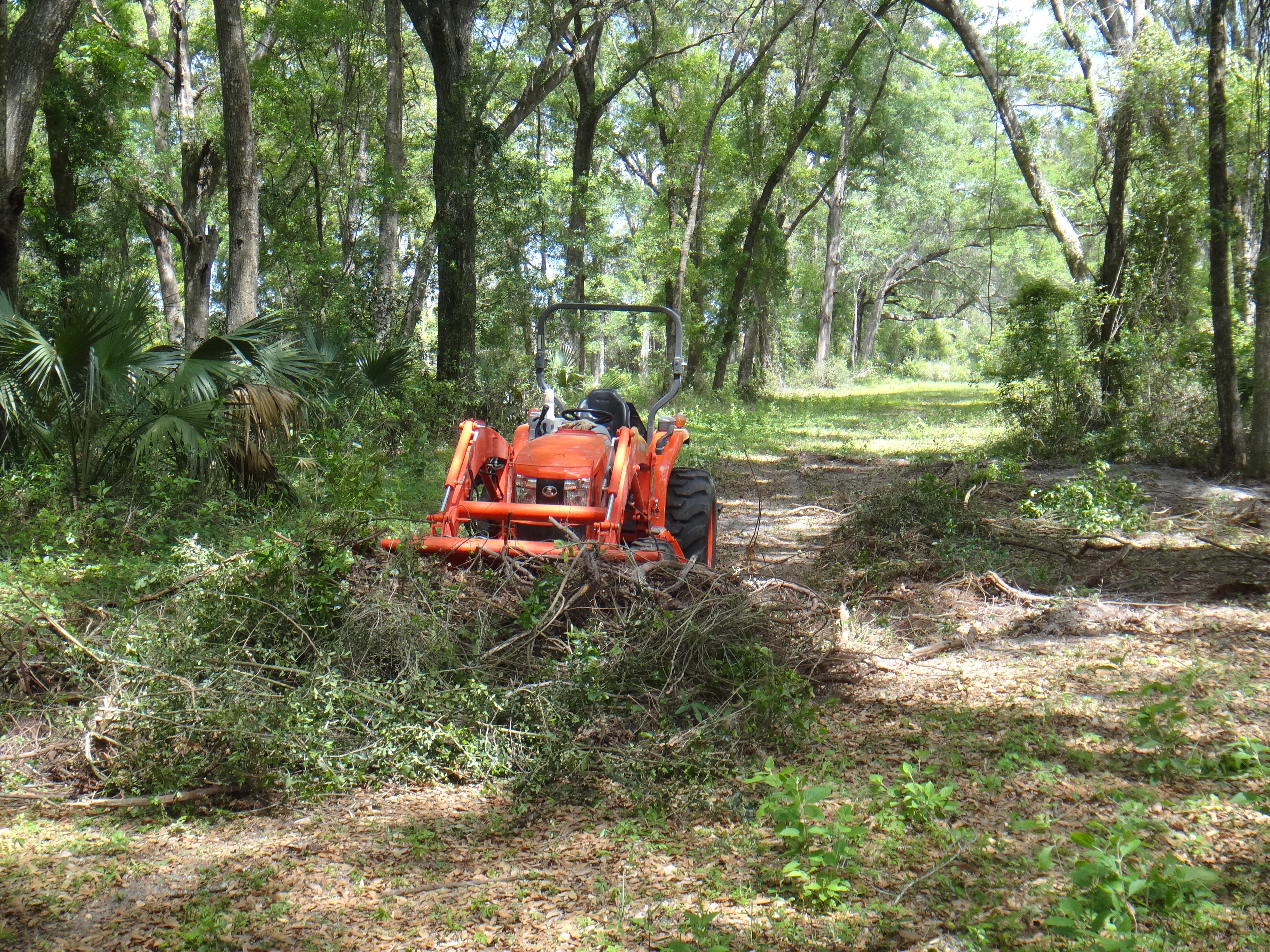

I have an ETA Landscape Rake with gauge wheels.
I have a Ratchet Rake bucket attachment.
For the two uses you have specified a Ratchet Rake will perform better for you.
You cannot see the Ratchet Rake in Photo #2 but it is on the bucket.
Pushing brush is better than pulling brush. You have infinite collection space in front and line-of-sight is better.
