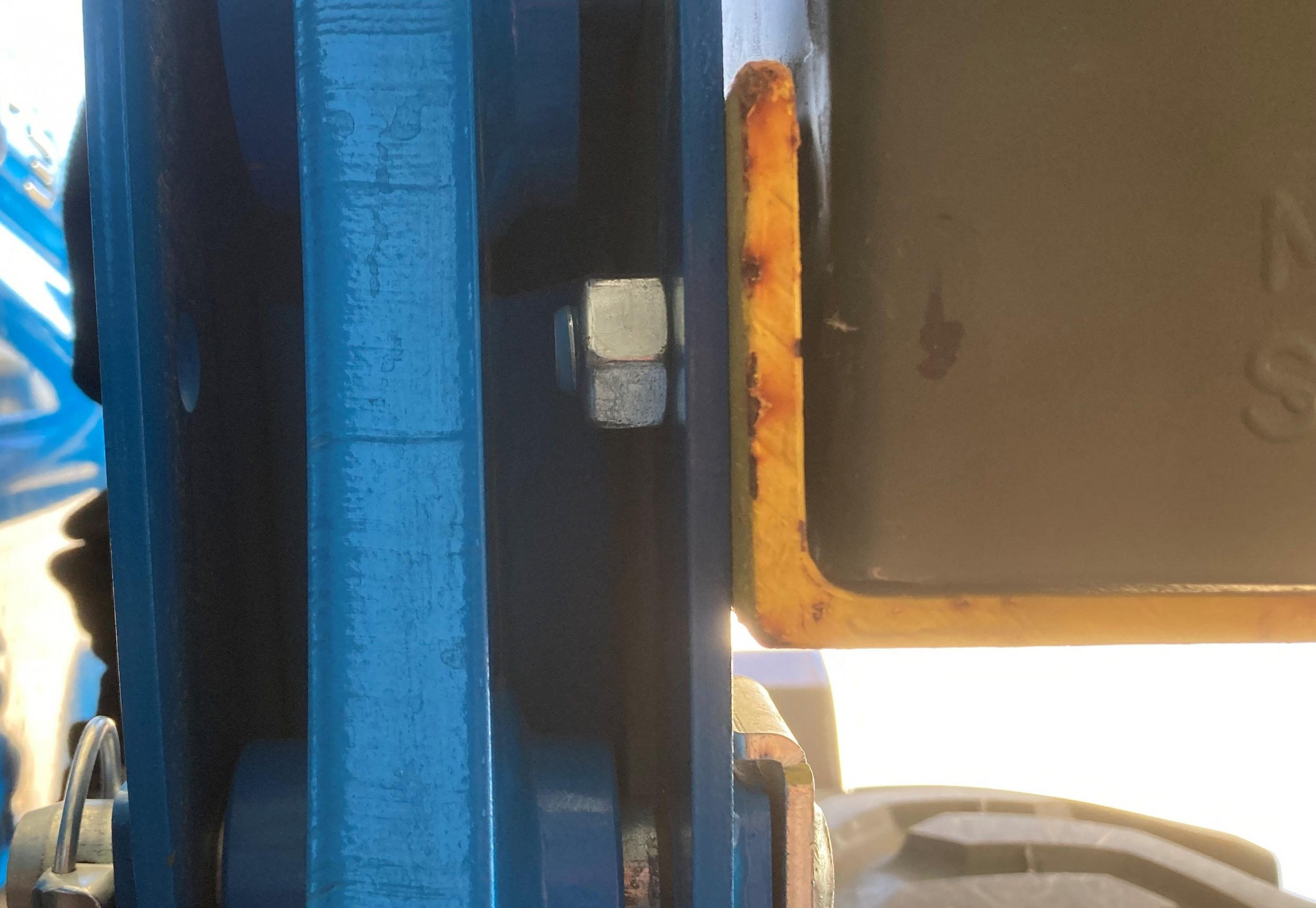

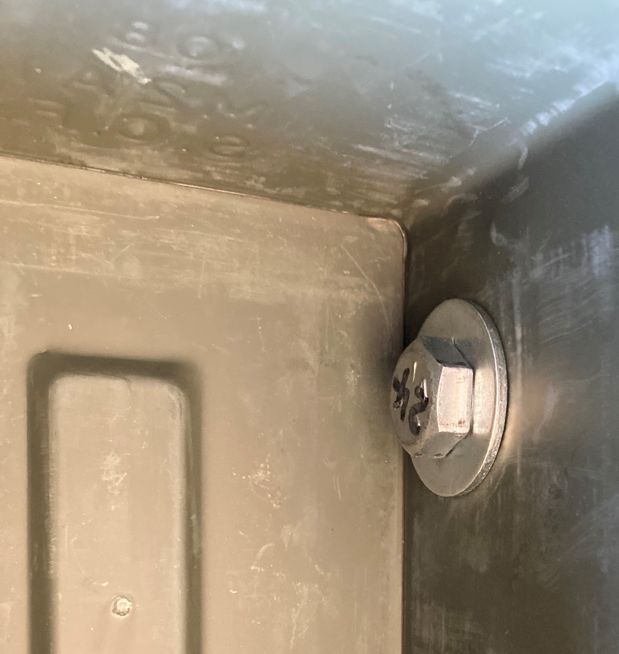

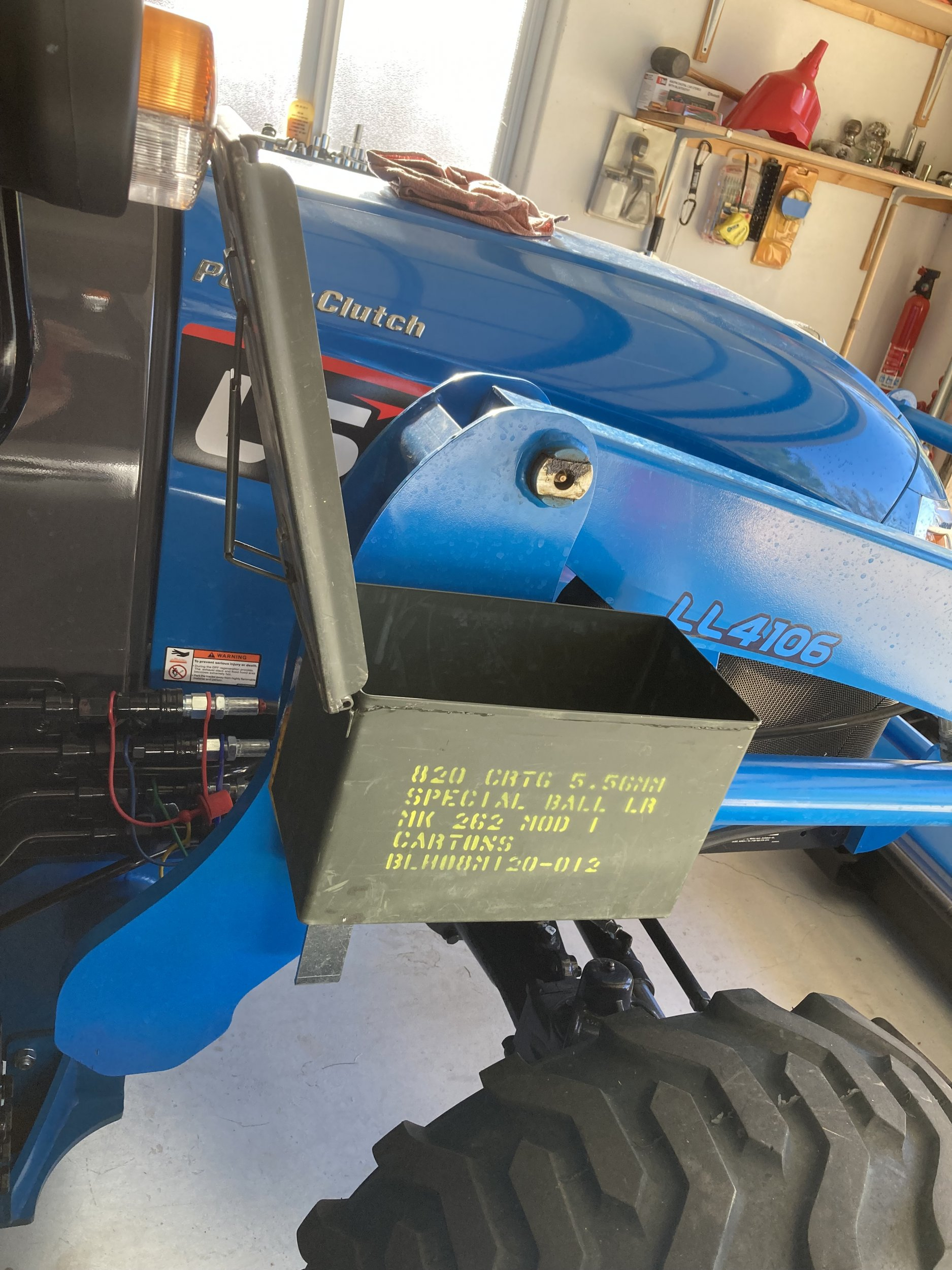

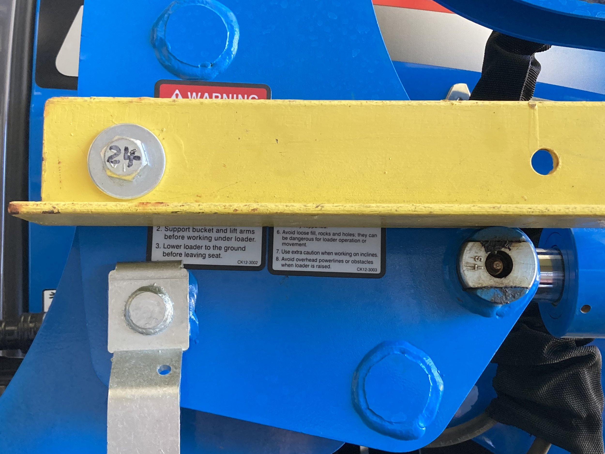

SWReeder... Sorry it's taken me so long to get to this. This is my first effort to load pics and explain what I've done. I guess I'll start by saying for you to look @ the rear of the loader boom on the right side. There's an existing 5/8" hole, which is just about level w/a grease zerk and it's protective metal "stub out." I used that hole to mount a fairly heavy duty piece of angle iron and an ammo can. One end of the angle iron is held on w/a 2' X 5/8" bolt and a wide/large flat washer. The ammo can has a 5/8" hole drilled in the side, near the back/hinged end of the can. The bolt protrudes through that hole w/a washer on the inside and another on the outside to firmly hold the can, but the one on the outside also serves as a spacer to help hold the can further away from the boom. The other end of the angle iron just rests on that grease zerk "stub out." As the bolt is only 2" long, it does not interfere w/the loader movement. The grease zerk that's supporting the angle iron is very accessible for greasing. Because the bolt & washer are so substantial, everything is held very firmly in place. I pulled the forward end of the ammo can out away from the loader a bit to bend it, and that plus the "spa
