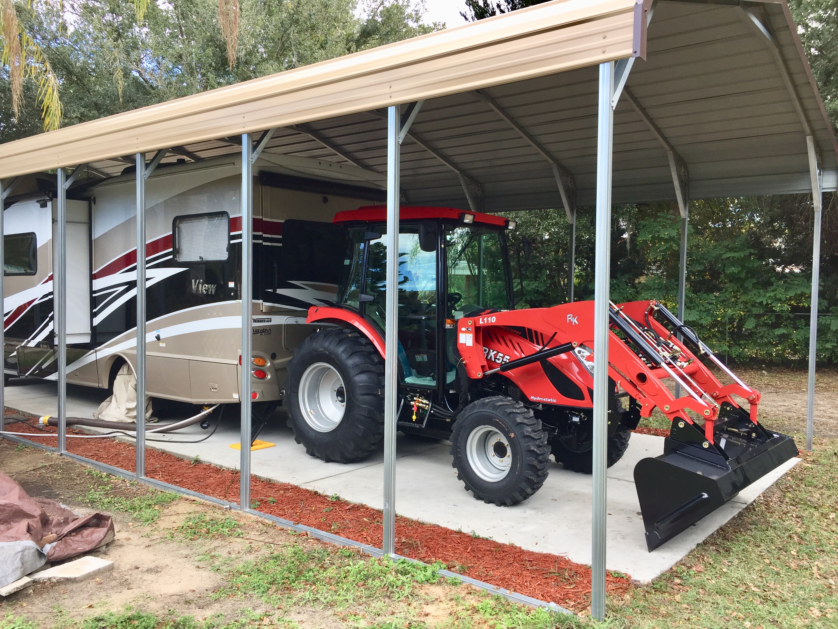

So is this a brand new tractor with a 3rd function add on by a RK tractor dealer? Sounds like someone dropped the ball on this add on, no one went through or threw the check list and testing, just let the tractor go out the door, why do dealers do that, seems like it's going on more and more everywhere, to me that's a sigh of poor sloppy service, I lay the fault at the owners feet, hopefully when the tractor left the factory someone went that check list. How about picture of whole tractor with 3rd function...........
Here ya go, sorry best angle I have at the moment. I did receive the delivery checklist with my documents and everything was checked off as inspected.
Not mad at RK - stuff happens. Just suggesting other folks with the 3rd function check their components for fastness.
