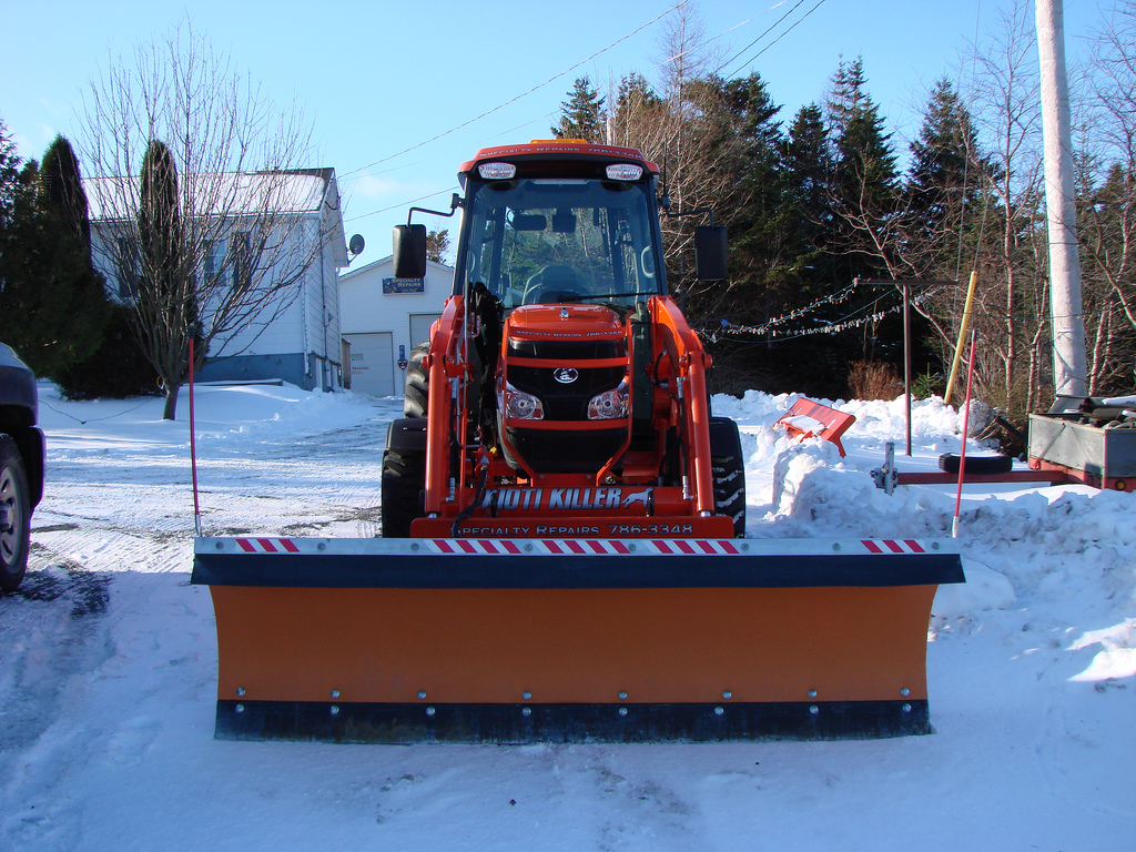

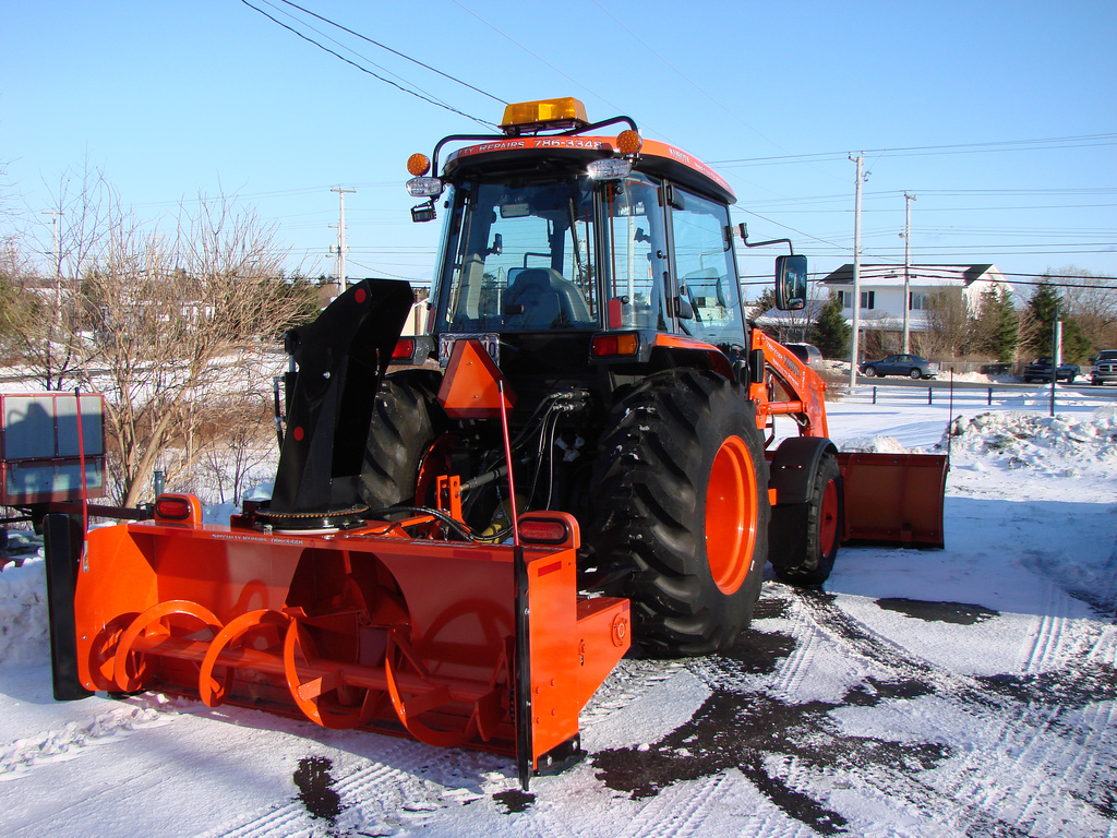

I've operated heavy equipment for years.Some of the largest stuff you'll ever see because I was involved in Iron Ore mining at the time and I've found with loaders the more weight you put on the bucket in down force the less control you have with steering.
The same is true for my little Kubota 4240. I'm not using fluid filled tires. I don't use chains and this week It's plowed about the heaviest snow it will ever have to plow and it did it with no problems at all. Yes It's in 4x4 but it never even slipped but even in float your going to find that your steering isn't responsive on a sharp turn at times.
When I'm plowing I take just enough weight off my fel to put as much weight on the front wheels and doing that combined with planning out the way I plow by plowing as straight as I can makes plowing with my little tractor a pile of fun and I enjoy it much more than plowing with my truck. In this case size doesn't matter. The more down pressure you put on your plow or bucket, the less steering control your going to have.
