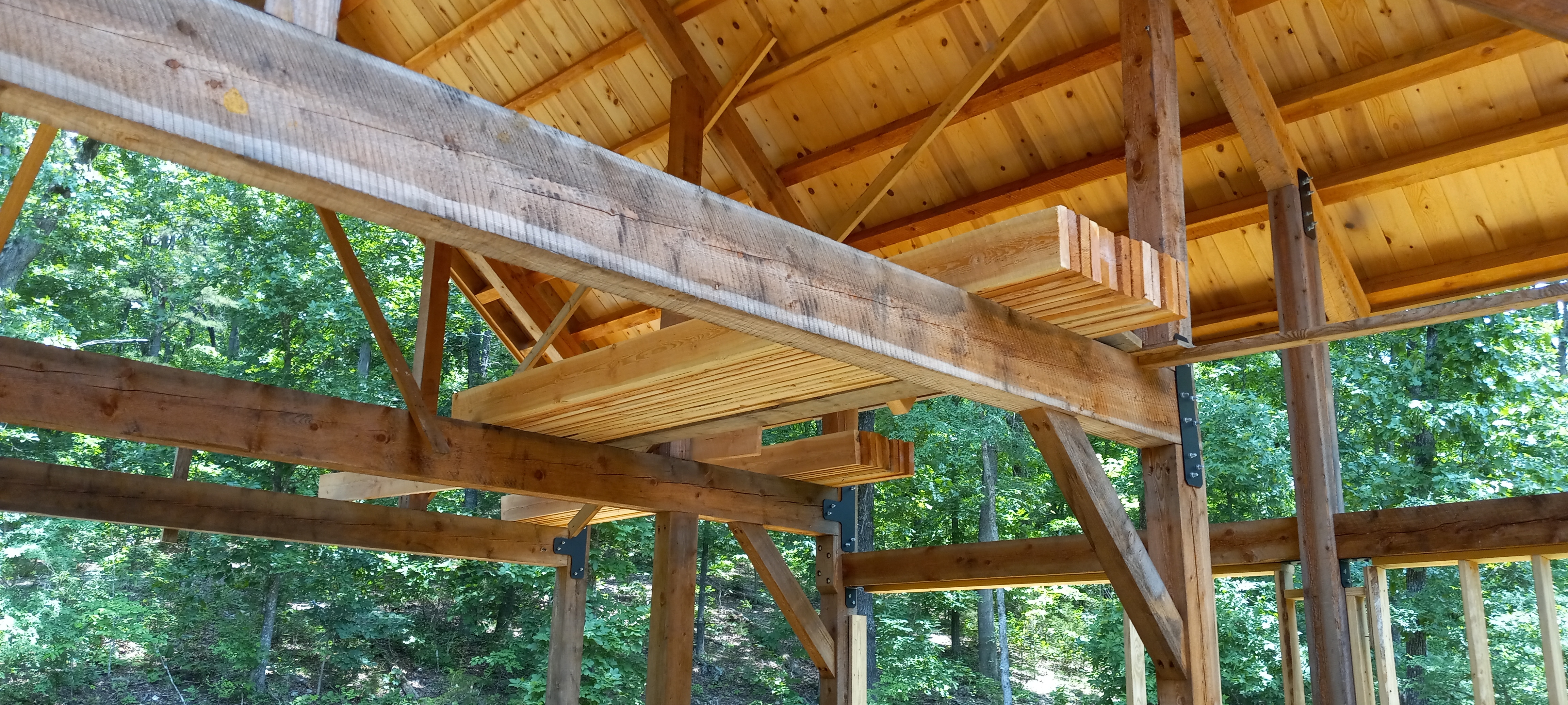

Yes if I had to do this all over again I would have burnt my last years vacation on contract or checkups before I retired. Legacy has a builder they work with who can erect them and get them as far as you want but they were 6 months booked out. Anyway I would have sold my house and just moved to my cabin. But i wanted to DIY major parts of it. Juggling two homes and the cabin being about 120 miles away makes it difficult at times. I had an old back problem flare up in January so for two months I did not work on it then 2 became 3 became 4. When I neighbor rented her cabin to me over a year ago that was so helpful. Once I'm living over there progress will go quick. I looked into a log home but went this route. Putting about 30 rough cut 2x8's up in the loft area was kicking by butt. I could only get them so high on the backside with the tractor. I had an IBC tote cage on my forks. I would put a half down boards on there then cinch the load and raise as far as I could go. Then get up on my scaffolding and slide them off one by one. You can see two bundles here and there's another out of sight.

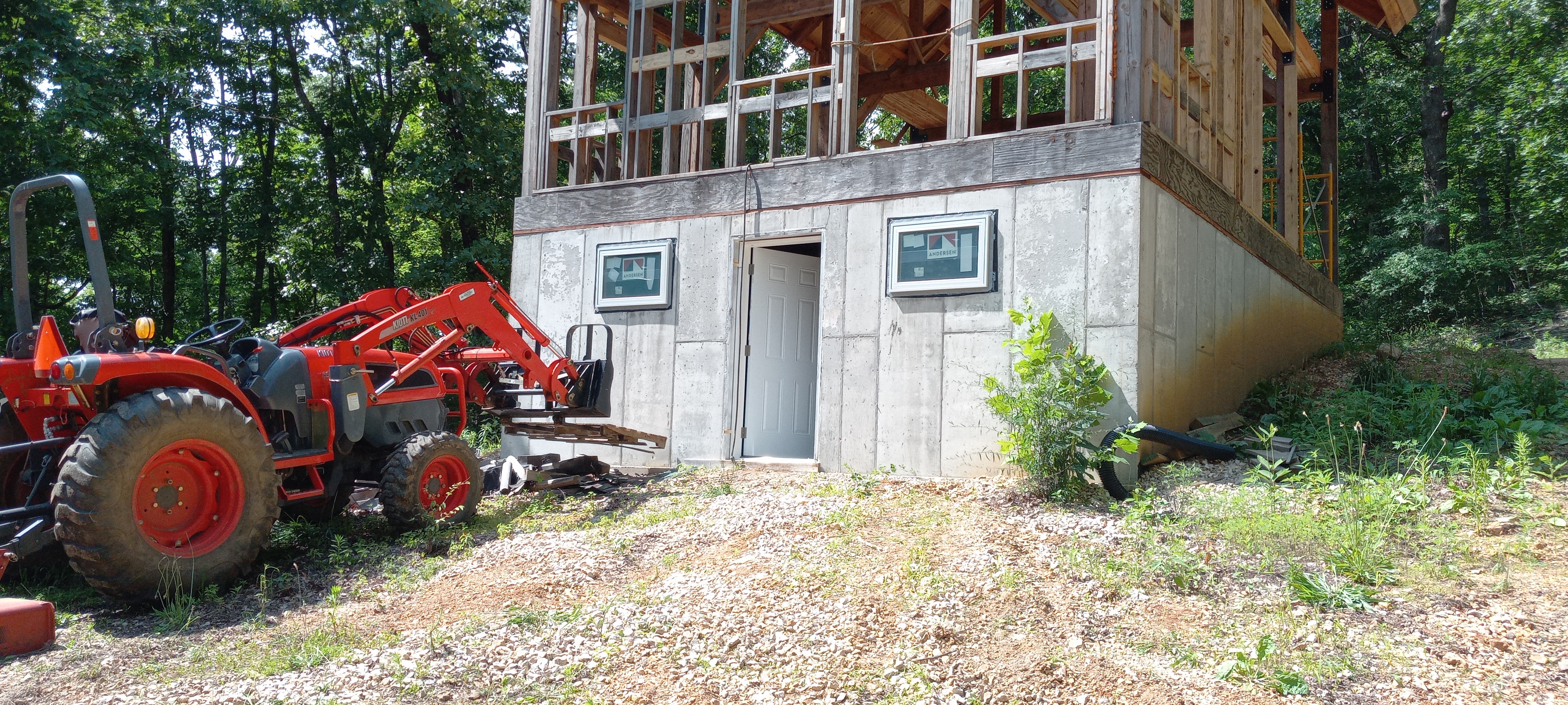

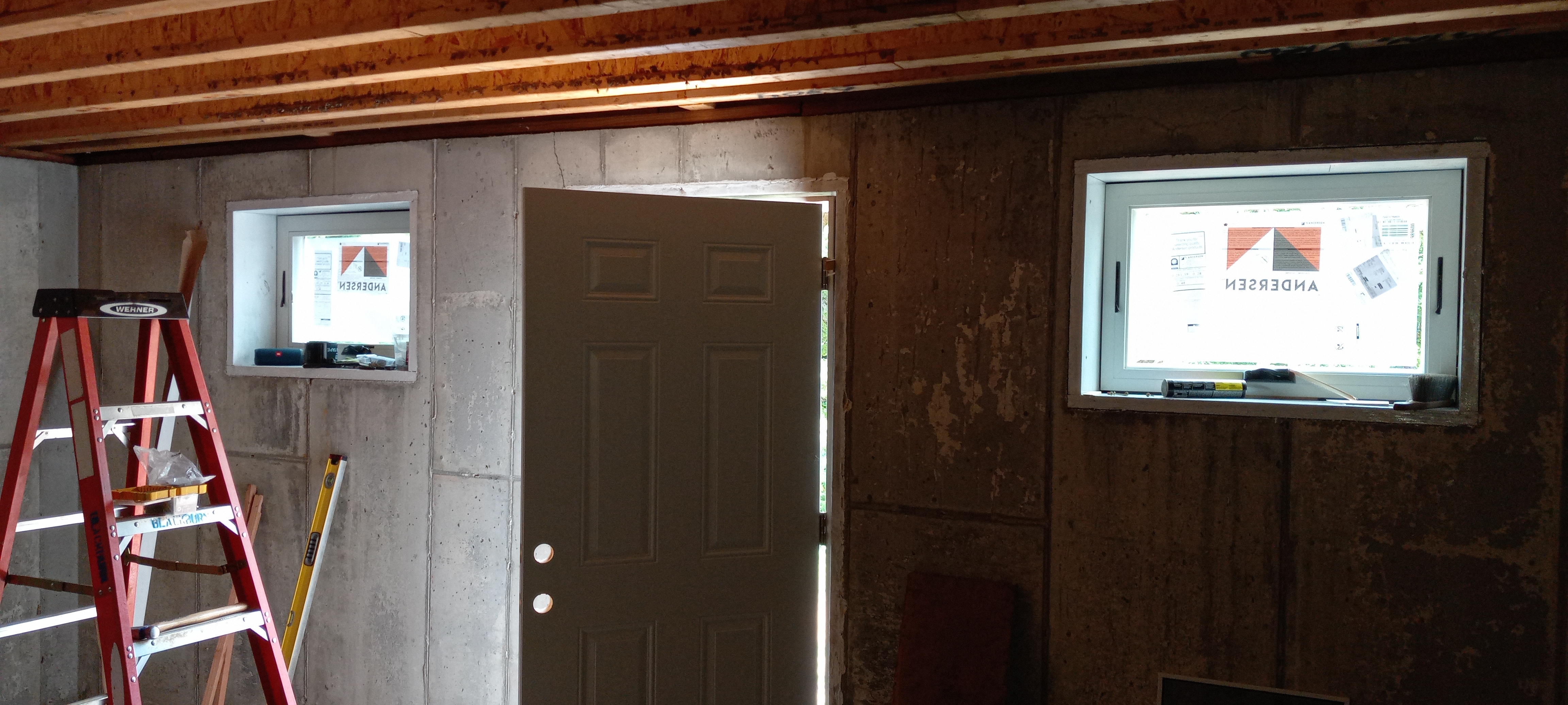

A short couple days putting basement windows in. First one went easy, second one fought me and the door...well that concrete guy didn't put the bracing on or check his walls after he poured them. I would guess over an inch out of plumb top to bottom and my 4' level has been babied. I put the hinge side level and thought how will i trim this out down the road? This door had no trim flange and I mounted it almost flush with the inside. Part of said juts make it flush with the wall but now the threshold is glued down. This will bug me. I've been looking online for like a Schlage deadbolt and entry handle all three (actually 6) keyed alike. I hear you can order them from build.com and say you want them keyed alike. I may talk to the local locksmith tomorrow so I can get a lock on that door when i go back. Currently that concrete wall will not have any siding but I have considered some fake rock type panels. Those used to look janky many years ago but now you have to be right up on it and still think it's rock. I found some 1.5 inch GRK screws and tried out Eddies suggested Big Stretch caulk.
Thanks for this thread. It is fascinating to read.
Good luck on the door. That would bug me, too.
If it were me, I'd pressure apply a bonding agent to that crack above the non-hinge side of the door. (E.g. Sikadur crack repair kit.) I have the concern that the crack will get worse with time.
Some of the faux rock panels that I have looked at are plastic, which I personally wouldn't use on a gorgeous house like yours, and some are cement. FWIW: James Hardie makes a faux shingle siding panel, and it can be applied over a couple inches of densified insulation, e.g. rock wool.

Good eye. That crack showed up maybe a couple months after the pour? I was considering anchoring a piece of metal across it. As you said it will likely get worse. There was plenty of rebar so something shifted. Having poured foundations during the summer as a teenager working for my dad this guy had some weird ways of doing stuff. I have to pour 3 -30" piers about 10' out for the deck on this end of the house. I already have the Sonotubes for it. I'll do that myself with a helper or hire someone else.
