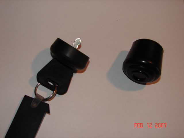

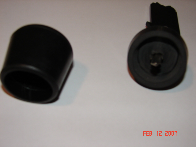

****, you solution my not be a "Rube Goldberg" but it merits a picture!
How did you attach the rubber cup?
--real turn off---funny play on words.
Here's two pictures that I hope help. I used a 1/16 drill bit to make the small rectangular opening, 1/4 inch long, for the metal part of the key. Make sure it's centered in the cup. The key will fit in snug but I guess you could use silicone seal or other glue. The cup was just cut shorter to make it just clear the dash but go over the raised portion of the switch. I imagine it would also keep out dirt for those working the fields this summer.
I realize it's a crude setup but when I found my ignition switch froze, I was none to happy. The snow was piling up and needed moved. It's a quick solution to the problem but it works. After the snow is gone, I'll try to make something more professional. key 1.JPG
