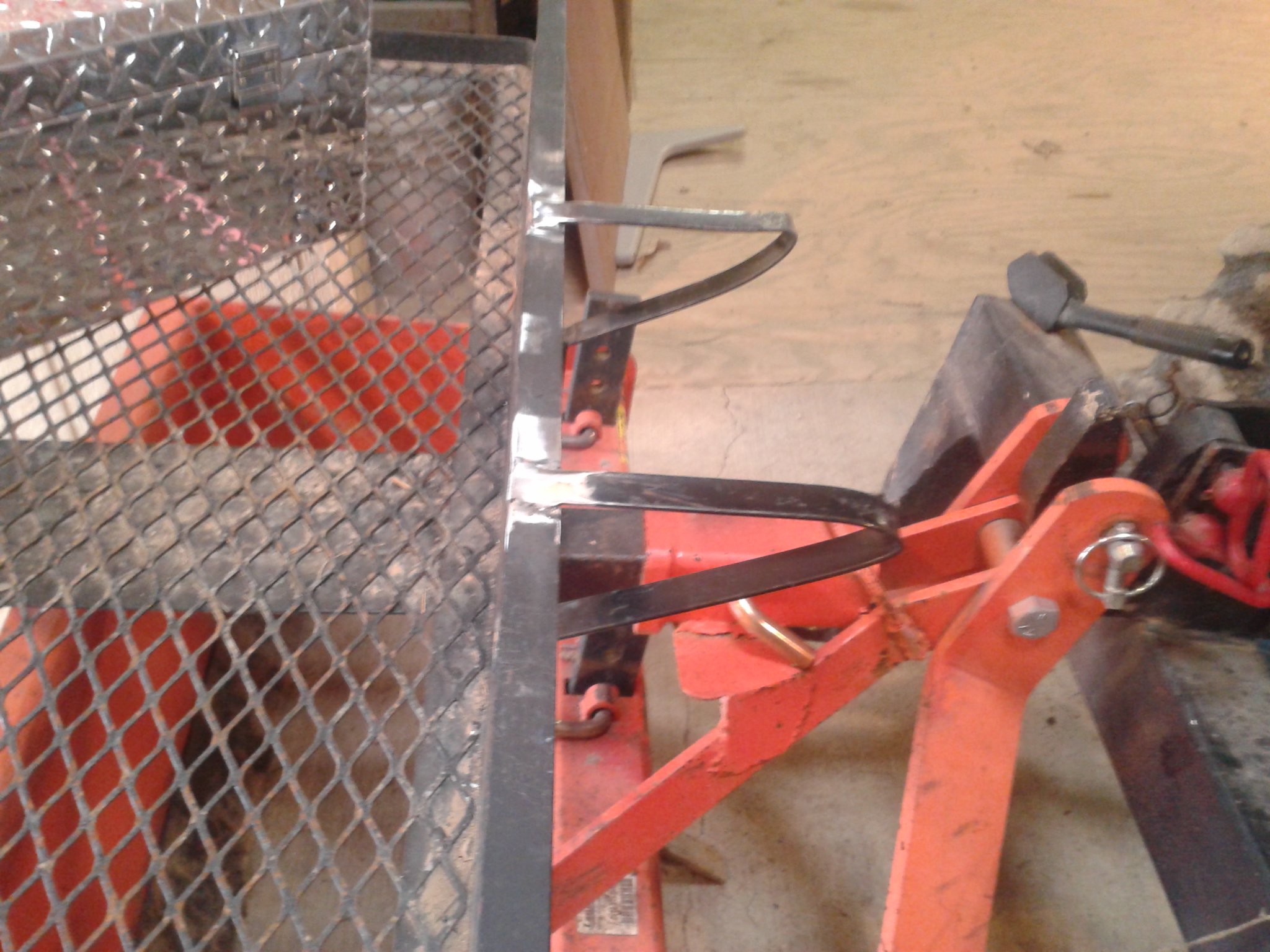

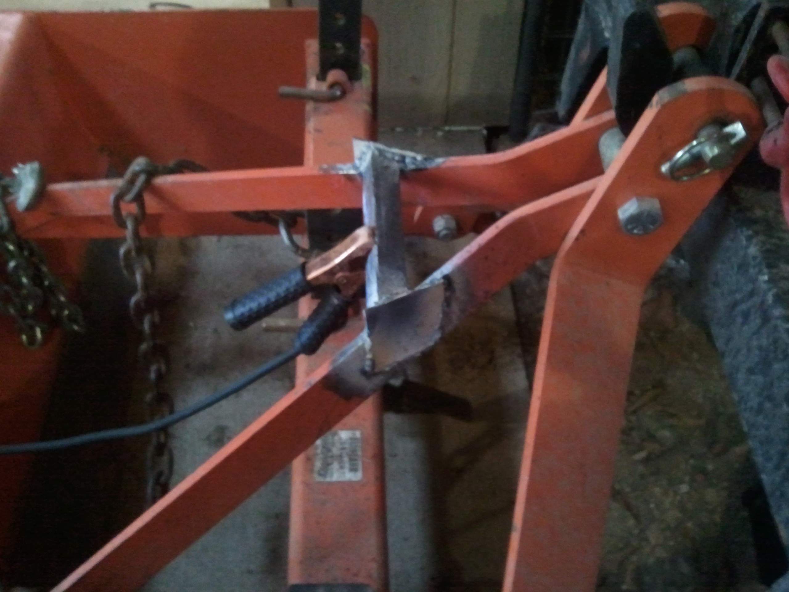

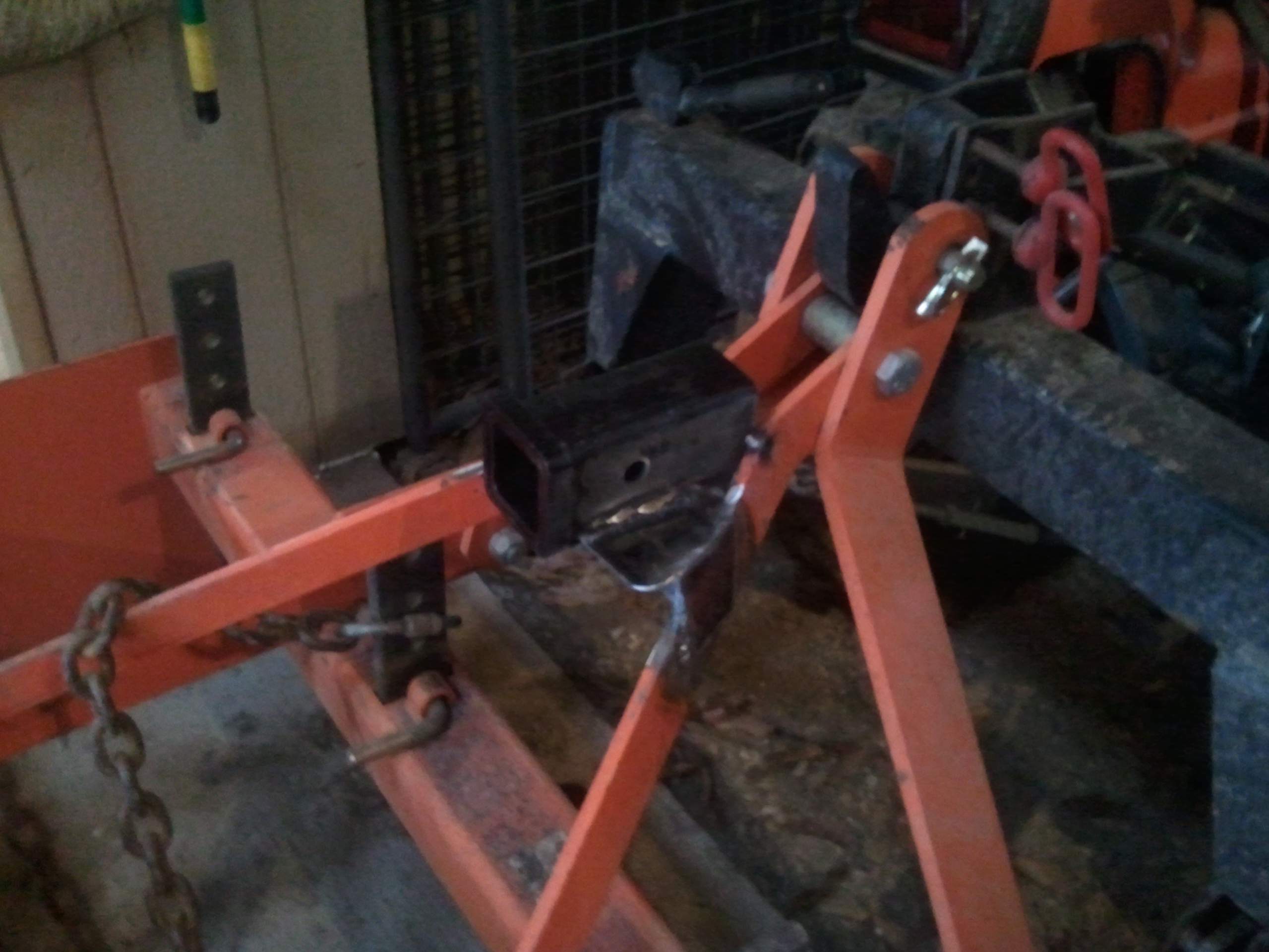

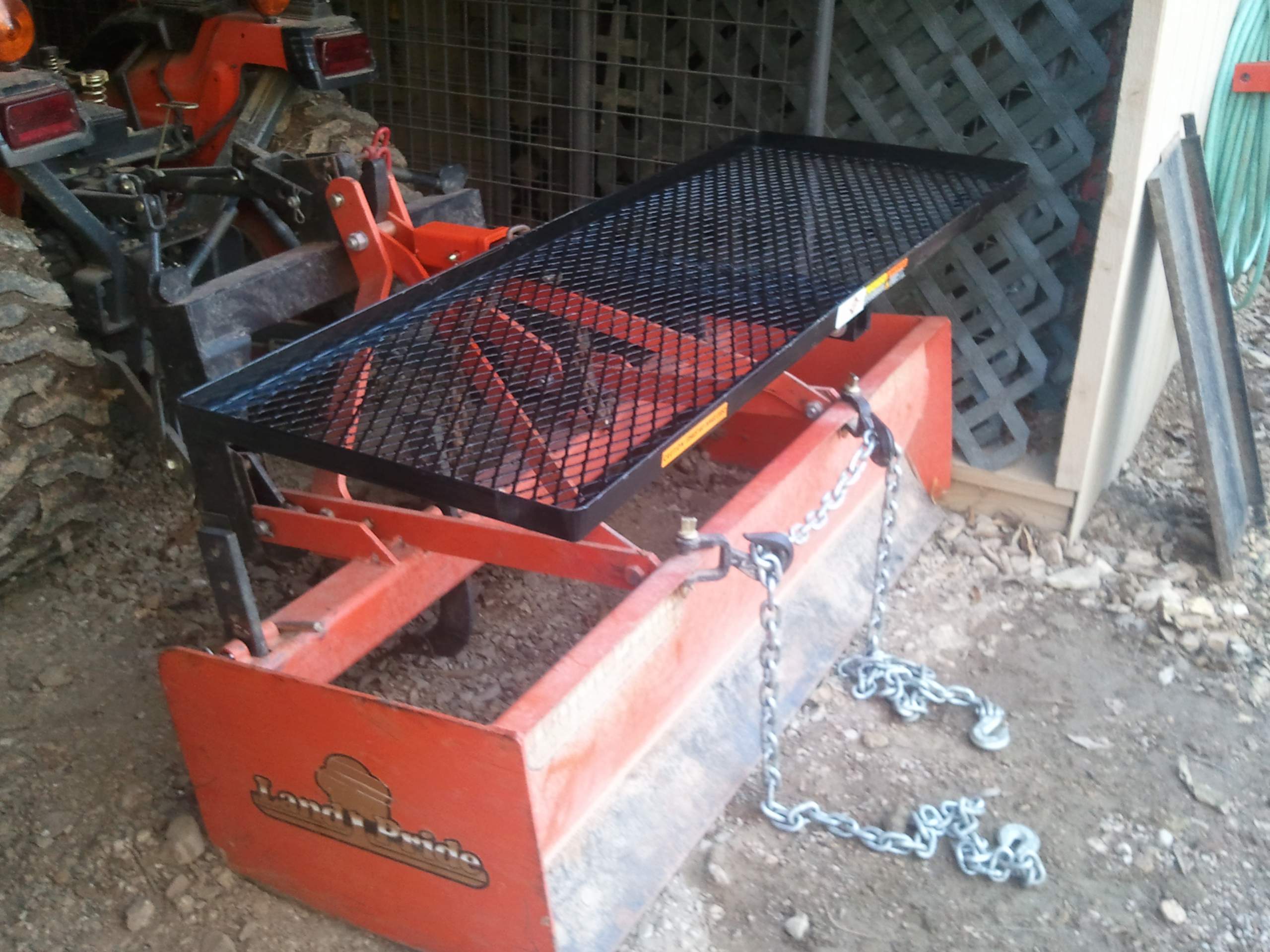

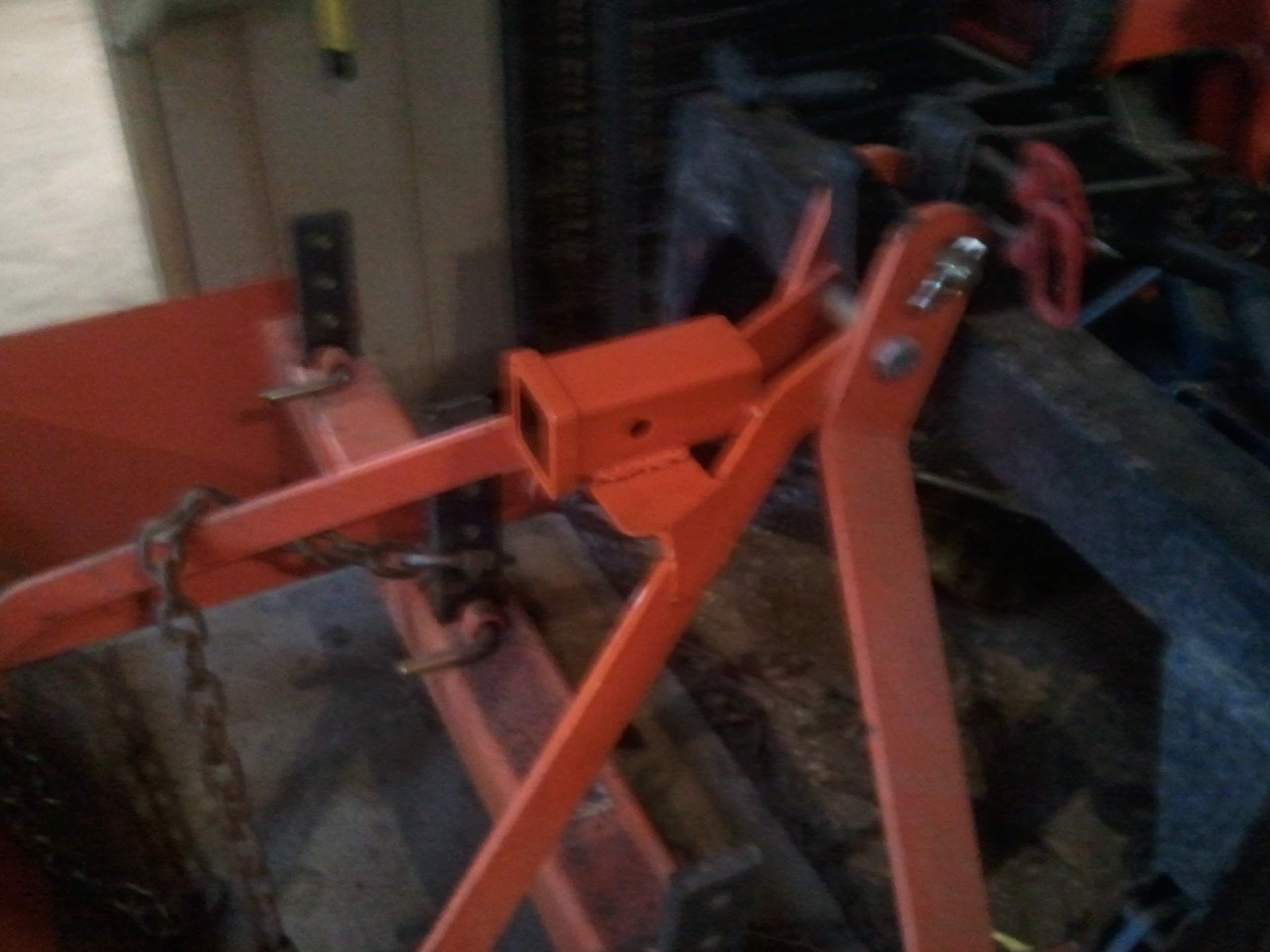

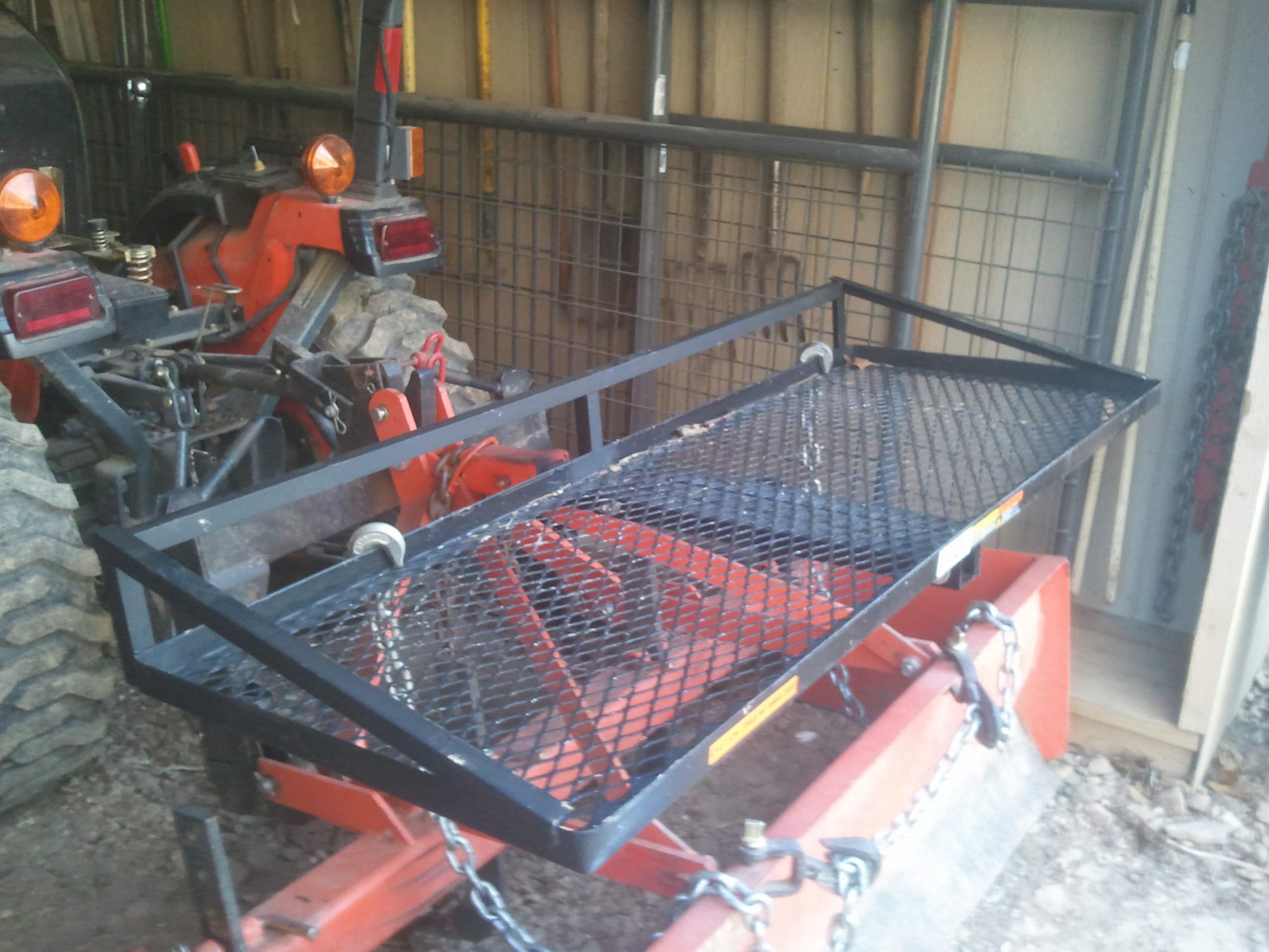

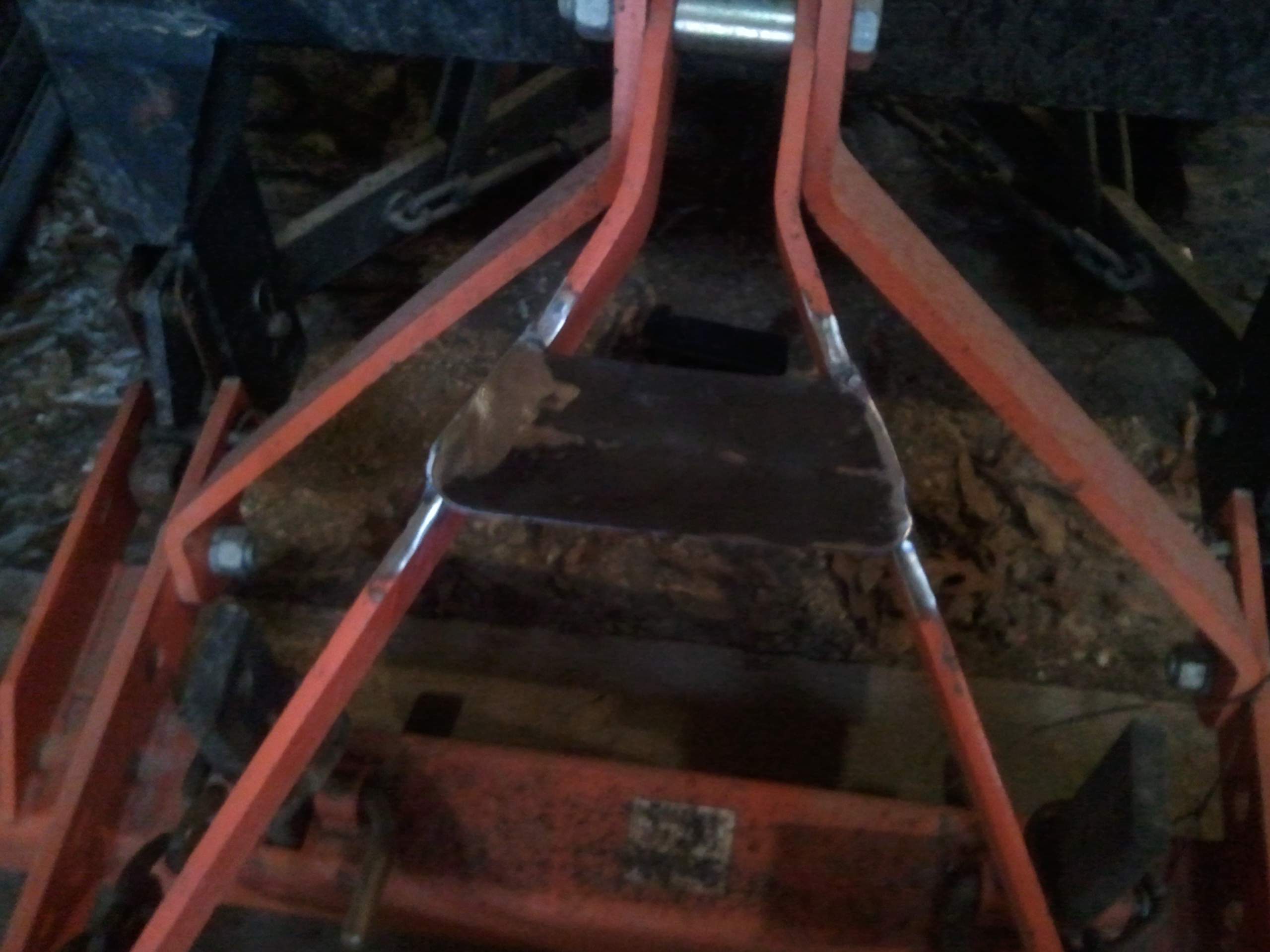

i had a need for a rack. as i would go back in the woods with the saw,gas can and what ever i might need in the bucket. then see a tree or something needing to be pushed on and dump it what was in the bucket on the ground. i got my first welder a little Hobart 140 and i pulled this out my back side. so laugh away as it has been 35 years since the last time i have welded anything.
2011-12-22 12.14.58.jpg2011-12-22 14.32.01.jpg2011-12-22 14.46.34.jpg2011-12-23 15.16.42.jpg2012-01-02 15.07.52.jpgIMG_20130330_165310.jpgIMG_20130330_171405.jpg
it did start to sag so i use part of exhaust clamp and i had to paint the tool box black after the first time i was backing up with the sun clearing off it . not pretty but it works

Awesome idea! We area thinking of doing something similar. Thanks for the ideas.
Have you noticed it obstructing any sightlines other than the glare?
Andy
   / a rack and tool box for the box scaper
not that much, the tool box is the only thing in the way but i can see over it and around it.like everything else just got to know where you at i have about $100 in it, the rack itself i found for $50 and the toolbox i got it on sale for $30,plus the cost of the tube, i had the steel. it also makes a god work bench when back in the wood. when it start sagging i just put the u of a muffle clamp on the back of the tube. the most weight i have had on it was 4 bags of 80lbs of concert and some tools, i have also filled it up with fire wood. it works great for me as the box scrapper still on the tractor all the time, as a weight box for the front loader. copy away and let me know of your improvements. it was my first time/try of making something for the tractor besides putting D-rings on the side of the bucket for strapping thing in
