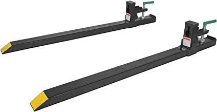

Hey there Ken. I guess I do not understand your setup. I am trying to picture what you have there but it isn't working for me. Do you have a picture of the forks on the bucket that you can share? That way I think I could envision the PB added onto what you show me and it would be more clear to me.
And yes, I agree the PB is a real brush, small tree KILLER ! I love it.
This is similar to what I have.
oh ok.....well yeah I could see these being a real problem if you had these mounted at the same time as the PB. I find it critical to be able to find that perfect "roll" angle of the bucket so that the edge teeth of the PB is doing exactly what I need it to do.
Sometimes I have them angled down into the ground a little so I dig deeper to rip out roots etc, these forks would make that impossible. Dumb question.....why not just take these off when you are gonna be doing some brush clearing? I suspect most folks do not use their PB too often once a job is finished.

I don't normally have the forks on, but they are useful for moving some larger bits of tree trunk.

My forks are like the ones pictured and they work with my PB on, I used them a few weeks ago and had no problems, they fit the same as my tamers do.

I like the forks I got for my bucket, so far the pallets I have moved were easy and not overly heavy maybe 250-300 pounds total.

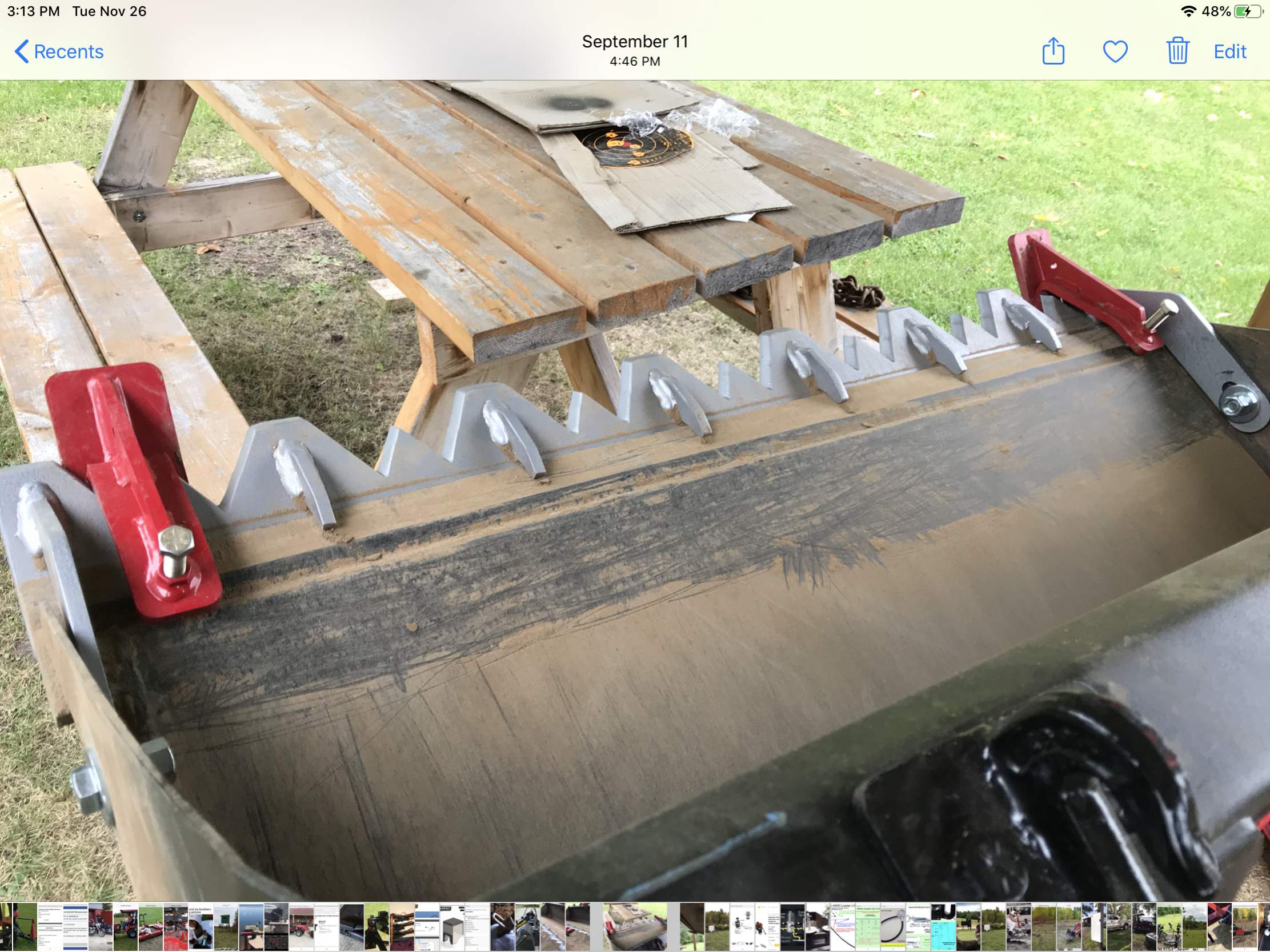

Better pic of tamers on with the Piranha bar.
That's what I need right there !!!! Very nice. I see the bolts that hold the tamers on are right on the edge where the bucket starts to bevel down and get thinner. Did you have any trouble or do you have any trouble keeping them on nice and tight?
   / A Quick Review of my New Piranha Bar #29
With what I have done they have stayed tight, I was hoping you would catch the bolt and bevel part mine just catches it so the bolt does not travel or wonder it grabs on the bevel, if it was more on a flat surface I would of taken and drilled a counter sunk hole for the bolt to sit in to keep it from wondering or moving.
