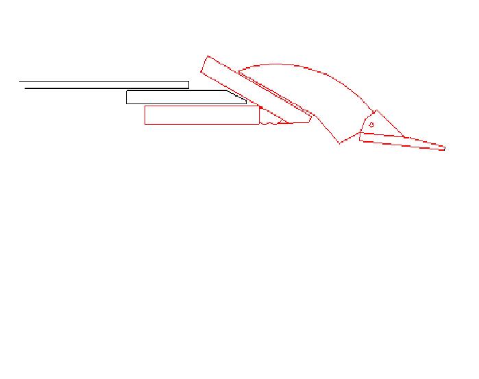

I'll stop in at the store and get the parts numbers. Spacing is about 7-1/2" center-to-center. The outside edge of the outer teeth are just about flush with the edge of the bucket. To mount the bar, I used some angle iron that I trimmed to suit.
Attached is a sketch of the bars I welded into a "V" and welded the teeth to. At each end the short piece of angle was welded onto the same surface as the teeth. I trimmed the lower part of the angle off where it protrudes into the bucket, and cut the leading edge of the angle iron at an angle. It's harder to explain than it was to do.
The end teeth are actually on top of the angle iron. This makes them 1/4" higher than the rest. This doesn't cause any problems when using it. It would be a simple matter to cut an extra 1/4" off the bottom of the weld-on teeth if you want to.
A 3/8" bolt on each end has worked out fine, especially since the "V" sandwiches over the bucket cutting edge. I have hooked into things that don't move with one tooth, and picked the one back wheel off the ground even with the weight of loaded tires and a RFM attached....................chim

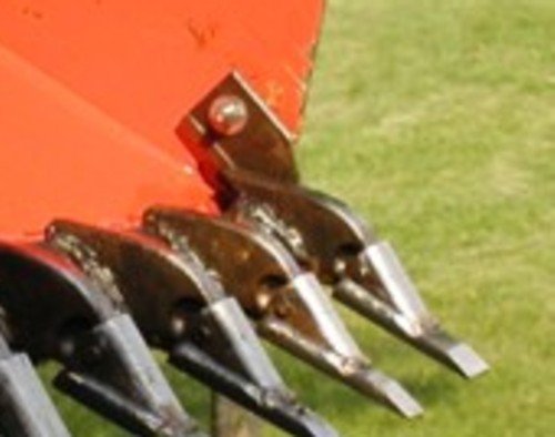

The teeth on mine are almost parallel with the bottom of the bucket. They are slightly lower than the cutting edge. The sketch in my previous post is fairly close to how it looks. Works fine. The only operations I've had better luck without the bar is scooping up crushed stone. It works best for me to remove the bar so the factory cutting edge slips under the edge of the pile.
Stopped at Binkley & Hurst this AM and got the following info:
Weld-on bases for teeth = 12L6DW-8-2A-H..........$9.95/ea
Replaceable teeth for above = T41166................$3.08/ea
Roll Pin = 38-32028...........................................$0.79/ea
The bases listed above are already drilled for the roll pins, but the larger ones I saw were not. The roll pins on mine fit very tight. You'd best assemble the base/tooth/pin before welding. You really need to smack the beejiminy out of them to get the roll pin in. As another poster noted, it would be a job to work between the teeth with a hammer. Good luck, let us know how it goes. Any? just ask...............chim

You're quite welcome. Judging from the info on your profile, fabrication should be a snap. Attached is a blowup to show the attachment angle and tooth shape...............chim

I attached similar teeth to the bucket on my old tractor a few years ago. I just welded the tooth holder right to the cutting edge. Then I attached the tooth to each holder by peening the tooth into that dimple shown in the photo, and avoided the drilling step. The whole operation took me about a couple of hours and saved the steps of fabricating the new tooth bar.
This approach worked well, but is a real lazy man's way and you'd loose the option of detaching the bar if working in loose material ( like snow or gravel ).
