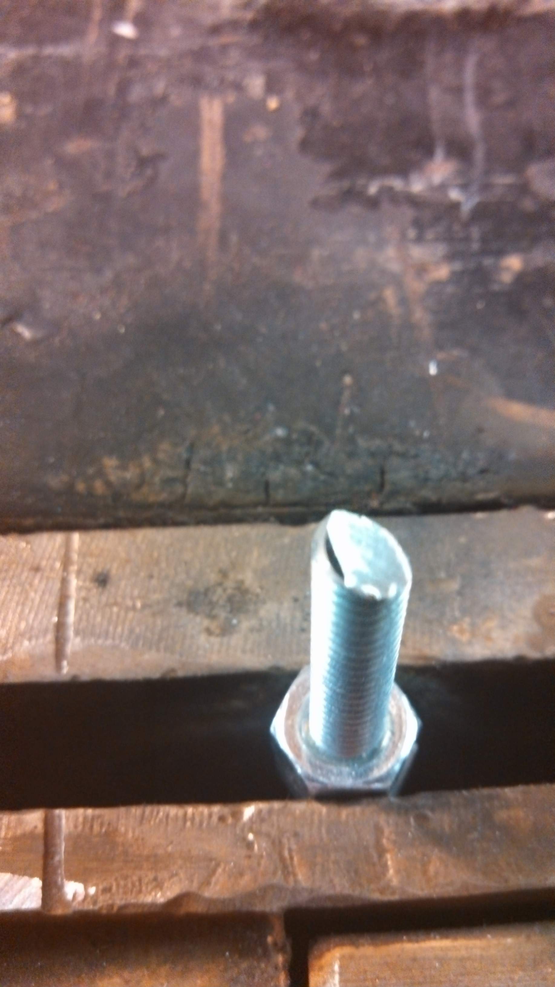

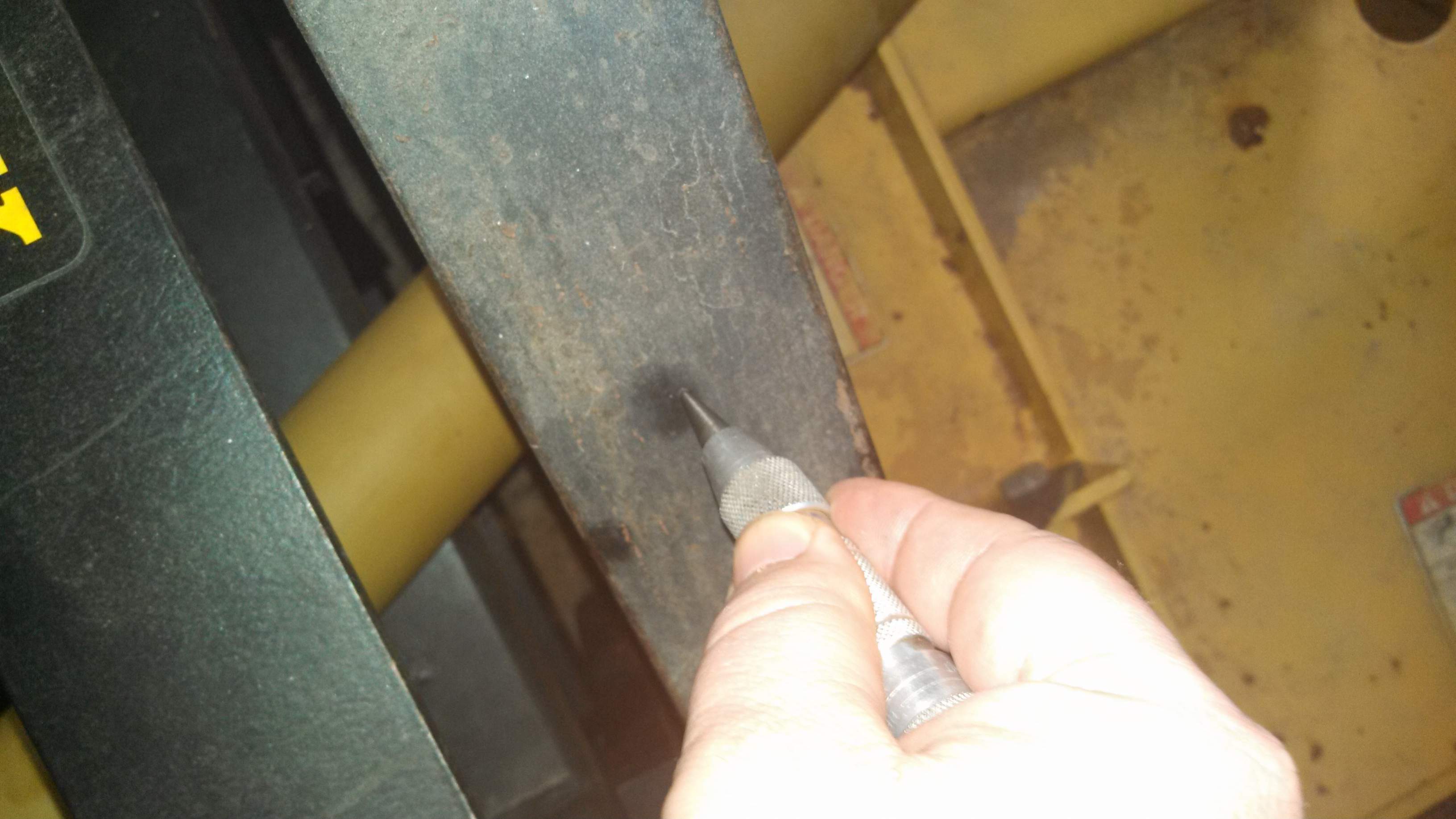

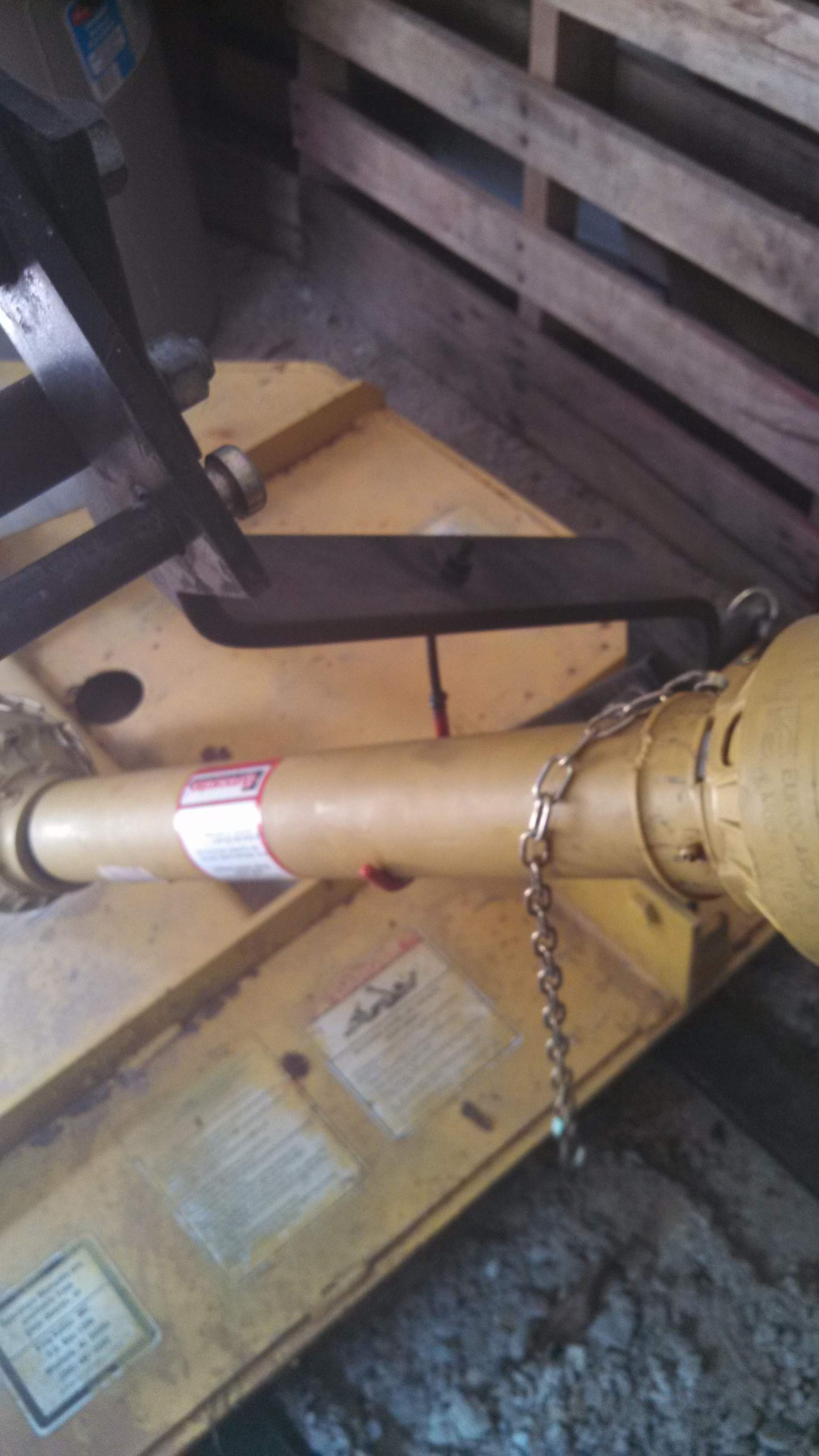

I decided it was time to build a PTO shaft hanger for my rotary cutter today.
I looked around for materiel's, and didn't find much.:mad: I did come up with a screw in hanger of abut the right size, and a piece of 1/4 inch all thread about 2 inches long..

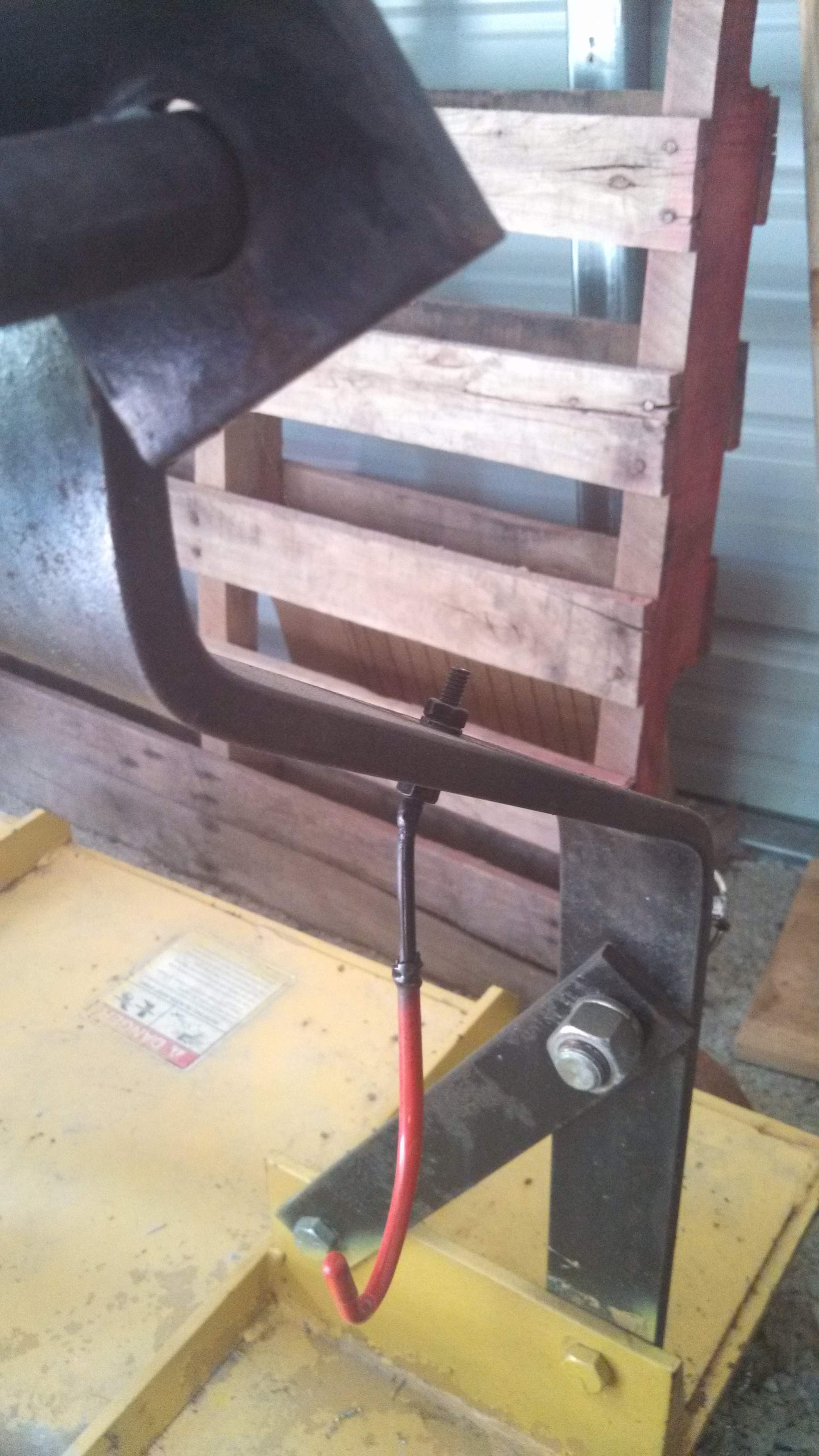

I cut the hanger on an angle and likewise one end of the all thread to more or less match the angle of one of the rotary cutters supports.IMG_20140512_142501_263.jpg
I drilled the support, to receive the all-thread.IMG_20140512_135958_480.jpg

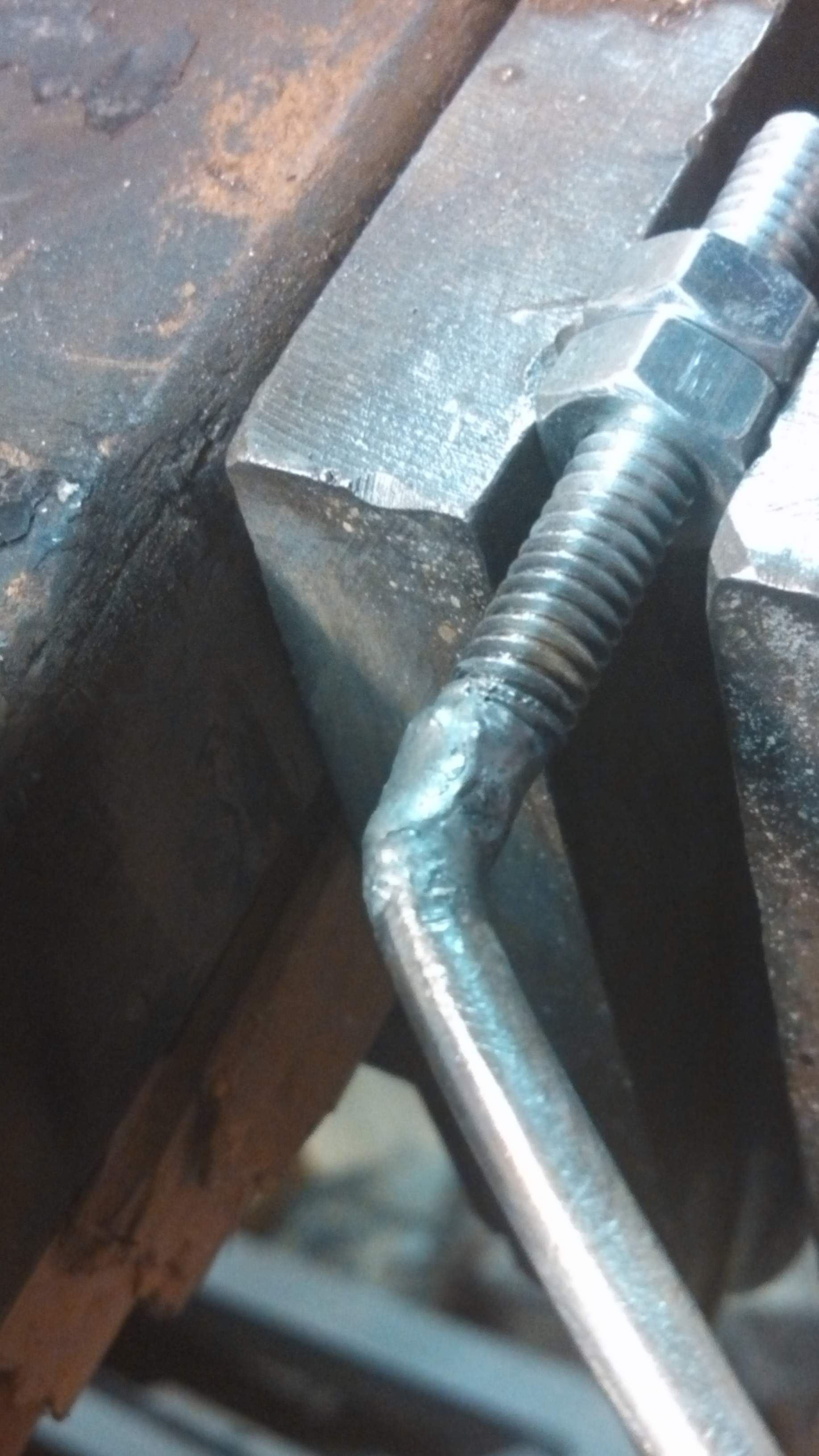

Next I clamped down the two pieces of metal to get ready to TIG weld them together. How do you like my Rube Goldberg Clamping arrangement? Pretty ingenious huh?:)
Here it is after being TIGed. It is lousy cadmium plated hardware.. I filed some of it off, but you don't get rid of all of the contamination., but it turned out OK.IMG_20140512_150217_505.jpgIMG_20140512_150450_072.jpg

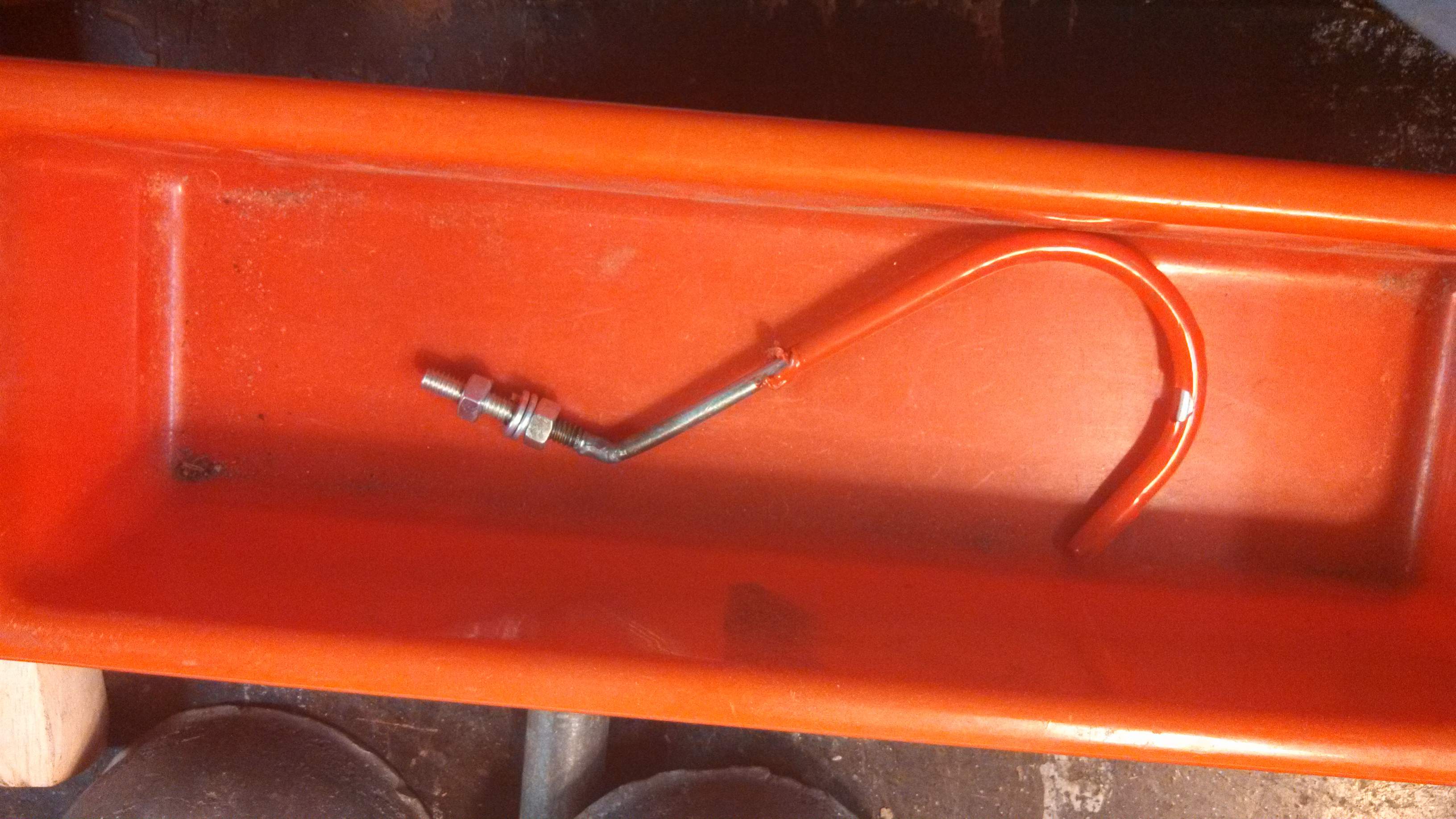

Here it is installed on the support of the cutter with a spot of black paint.IMG_20140512_151355_453.jpg and here is the PTO shaft resting on it.IMG_20140512_151419_169.jpg
It is probably not the sturdiest hanger ever built but if it breaks, I will just drill a larger hole and make something bigger.:) It is a 0$ project, except for a few cents of argon for the welder and some scrap.

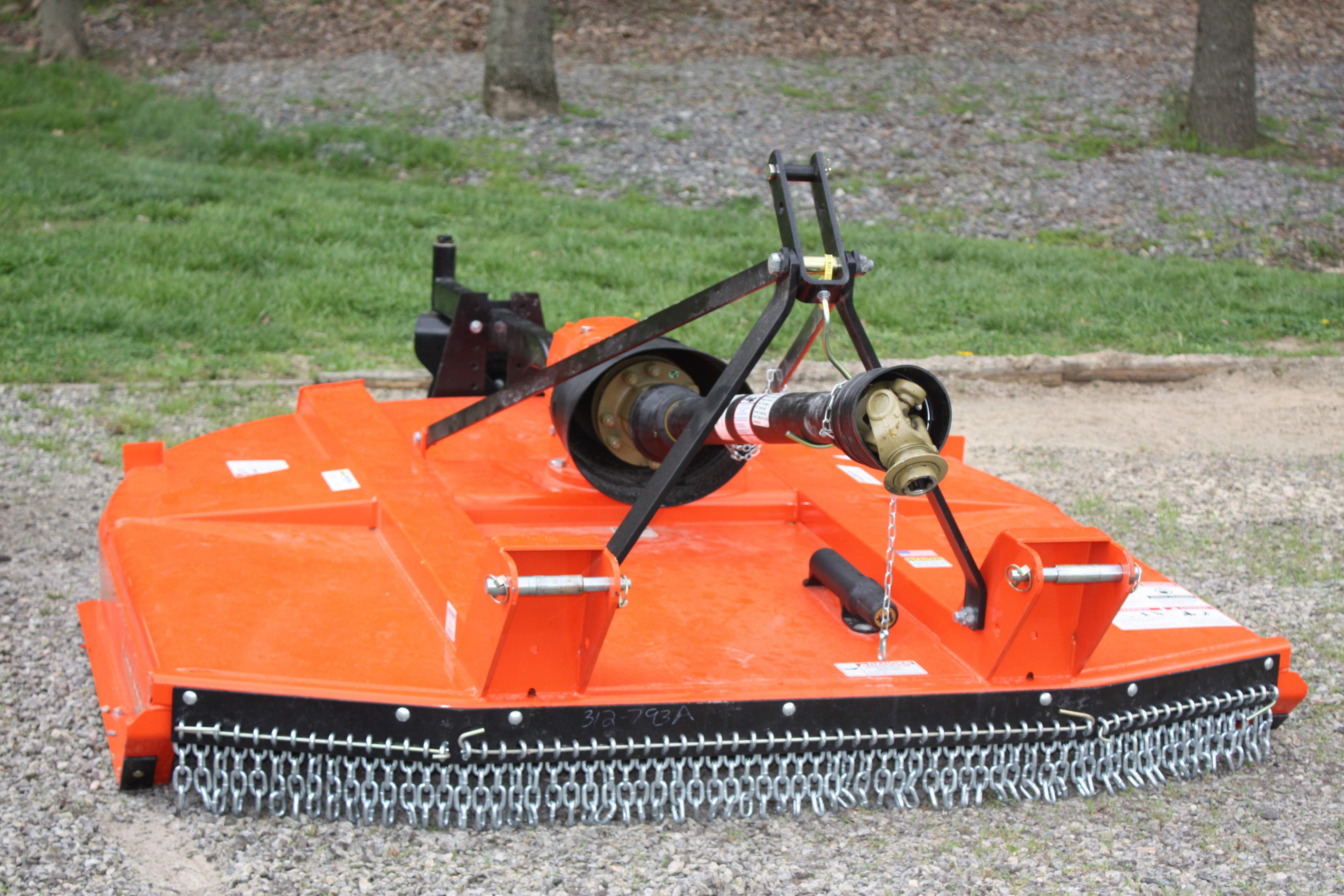

   / A PTO shaft hanger for my rotary cutter #2
Looks good to me.:thumbsup:
   / A PTO shaft hanger for my rotary cutter #4
Thanks TripleR, yours was my inspiration. :thumbsup:

   / A PTO shaft hanger for my rotary cutter #5
Mine came that way; fabrication is something I have to leave to my brother or sons, wish I could help.

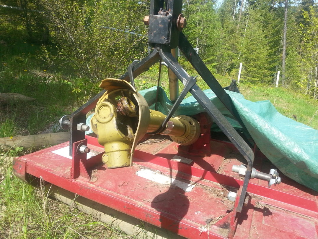

   / A PTO shaft hanger for my rotary cutter #9

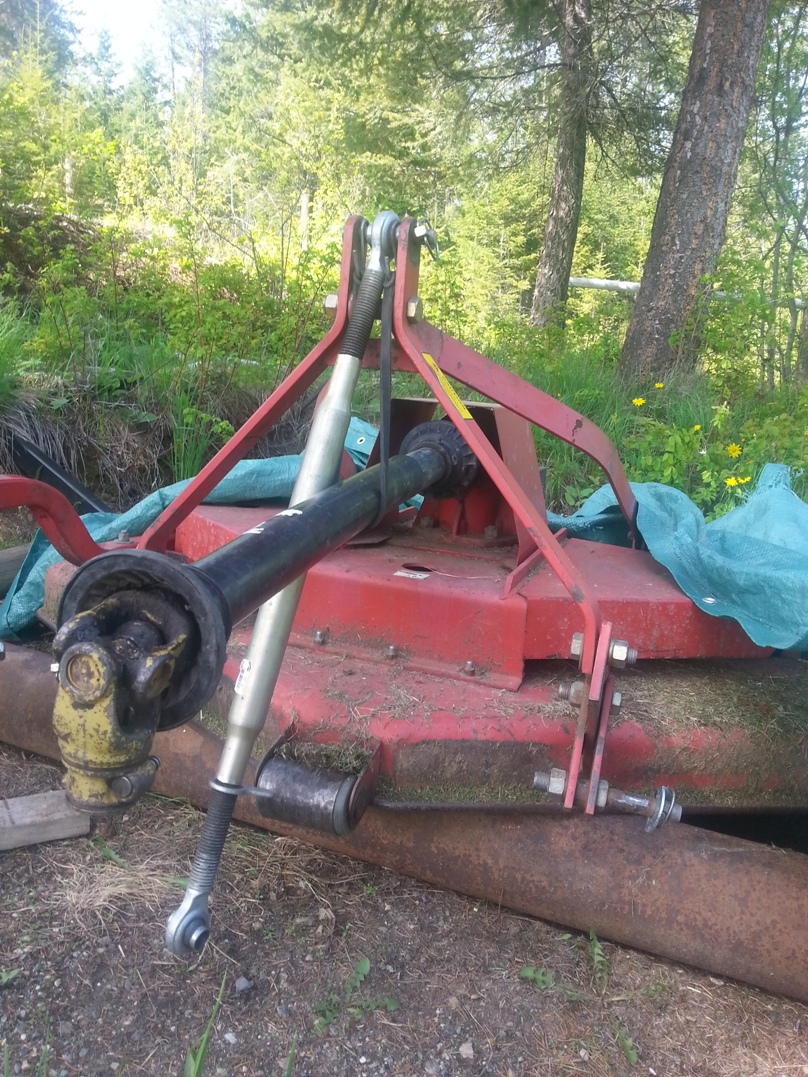

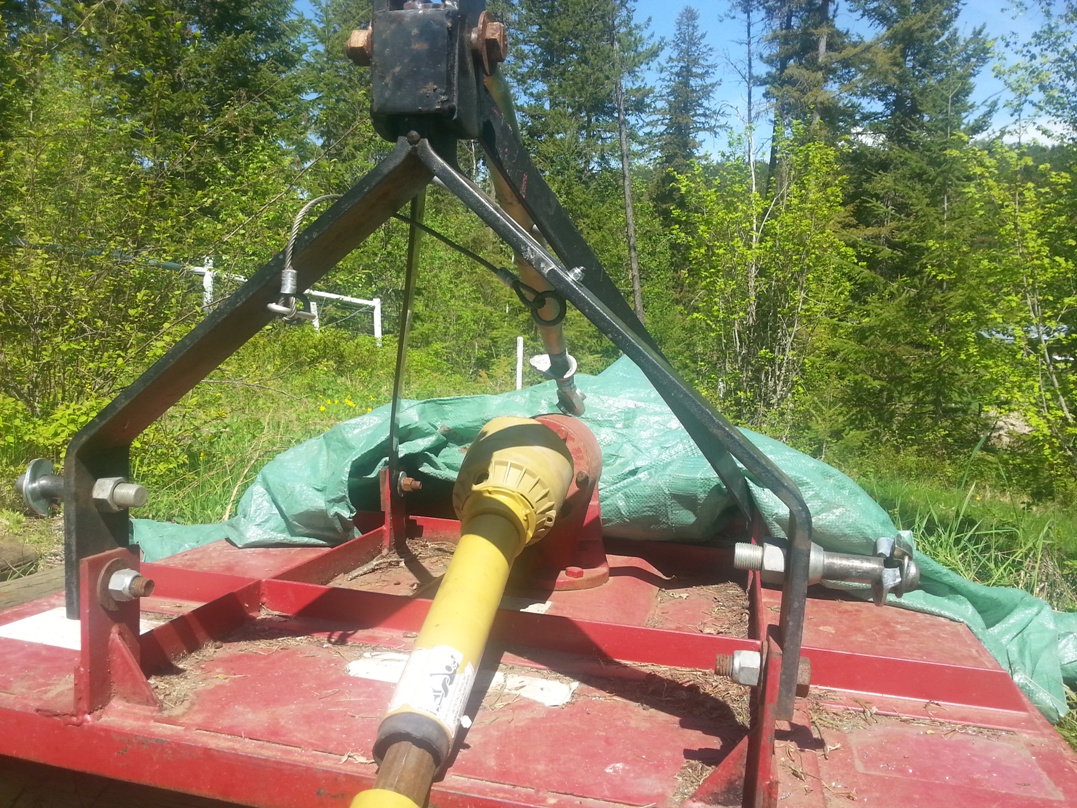

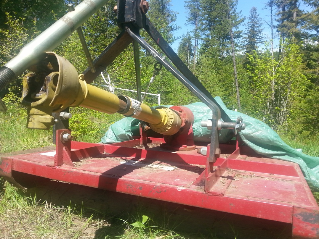

Here are mine:
All it takes is lack of imagination and fabrication skills=no problem for me. :eek:
Seriously though...your hanger looks great and now I'm determined to finally do something like that. I've used the bungees long enough and lost a few when I forget to store them after attaching the mower. It's only been 10+ years...no use rushing into this stuff. :)
Here are mine:
View attachment 374892 View attachment 374893
Hey, whatever works.:) You must have some sort of quick hitch, I see you have some bent washers for the ends of your 3pt pins. I made up some of those when I was using the Carters version of a Quick Hitch.
