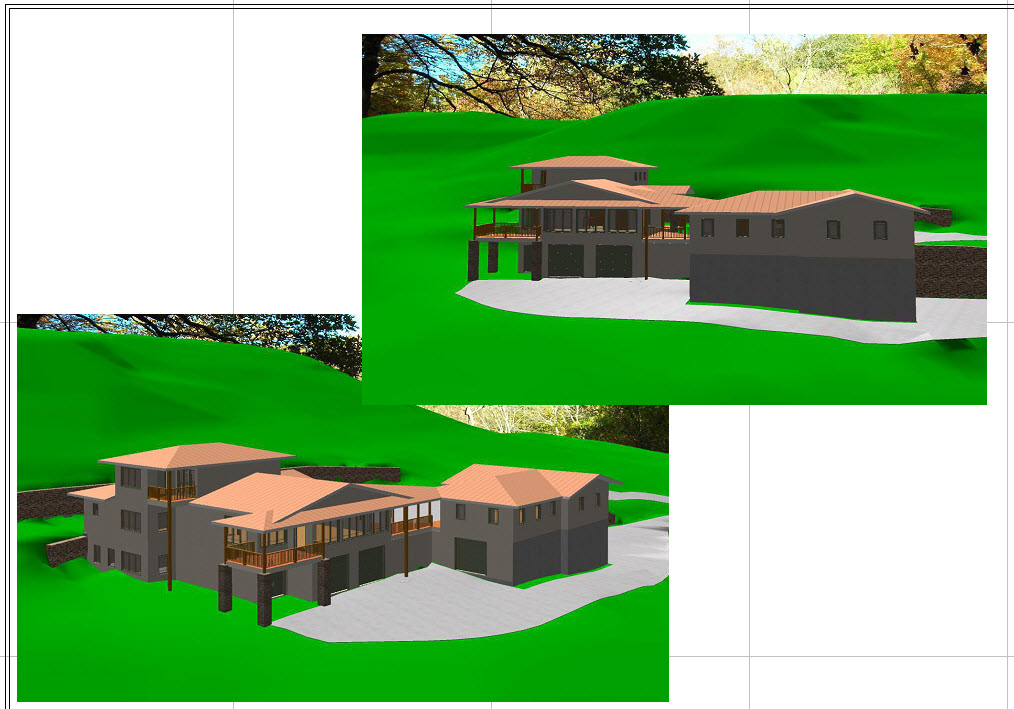

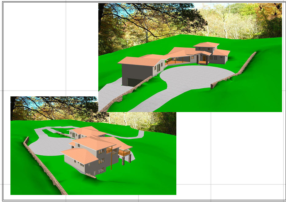

OK, I posted something in another thread, so I might as well put it here too. This is a rough look at the site plan and the exterior, without anything in the way of architectural detailing. It's a 2-building setup that has the main house with a small second story "library" that allows a nice lookout view of the land, and a separate shop building for Woodworking, metal work and car work.
There are changes that have happened since I took these screen shots, but they are pretty close.
I know the risk of posting plans on TBN :laughing: So these are just (semi-)pretty pictures... Plans will come later on. I am currently slogging through getting the construction docs prepared for some quotes.

Dave -
Impressive looking place. What program are you using? Are you able to manipulate sizes/shapes pretty easily?

Scoutcub - thanks. I used Chief Architect. I started back in Version X1, skipped over X2 and picked it back up in X3. I got the upgrade to X4 included with the X3 upgrade so it wasn't too bad. Pricey software compared to what "normal" people are familiar with but I use high end 3D CAD software all the time at work, so it actually looked cheap to me :D
I started the design process by myself and worked through a dozen or more concepts, with a couple themes static throughout (the second story section was a key one for some nice forest views). After I hacked through that for a while (probably a year) I hooked up with an Architect through the Chief forum who helped refine things for me. He gave me some very good ideas that really helped clean up some troublesome areas. Having the talent and background certainly does help, no question... From there I finished things off and have been working with a structural engineer to sort out those details. I've been working on the design on and off for probably 5 years now.
