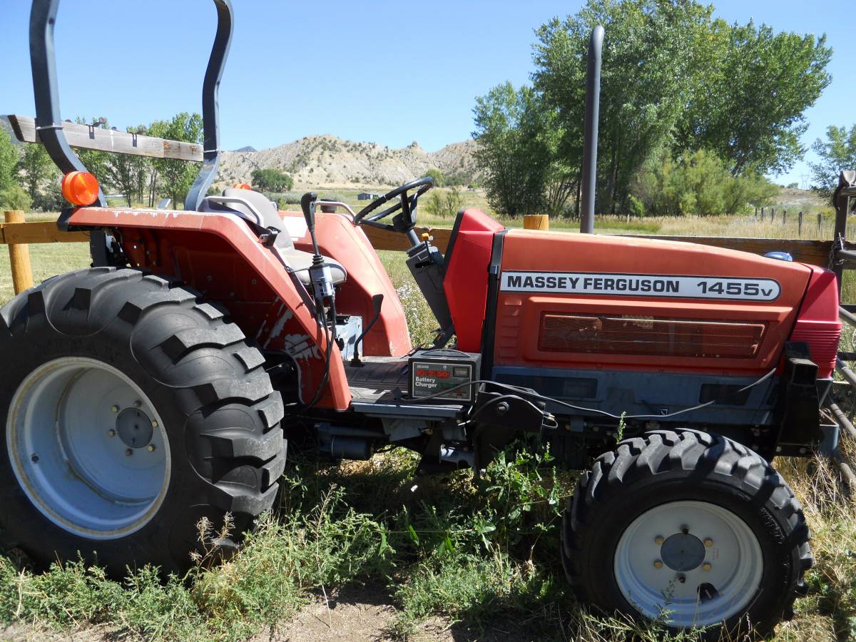

A few days before I was going to head up, I checked CL one last time to see what else may have showed up. Generally, the tractors on CL are very expensive for their condition, and have a mostly unknown past, and I've not found anything that worked for me. However, this day there was an hour-old ad for a 2003 Massey Ferguson 1455v with loader and 480 hours.
Here's the picture off CL:
Not a lot of other details, but $12k price and low hours had me interested... Specs showed it was very comparable in size to the 40hp tractors I was considering. I contacted the seller and got them to send more pictures. Nothing scary in the pictures, but it was obvious that it had been left out in the field it's whole life. The owners used it for a very small (~15 acres) haying operation for their own horses, and that was it. It had a 1040 loader, which was not mounted and had hardly been used.

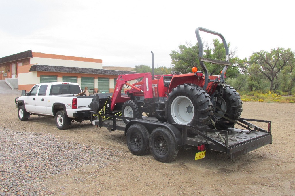

After some discussion, I decided to head up and check it out, and bring it home if it was acceptable. Since I was the first caller, and they had several more, the price was not negotiable. I feel like I still got a pretty good deal. :)

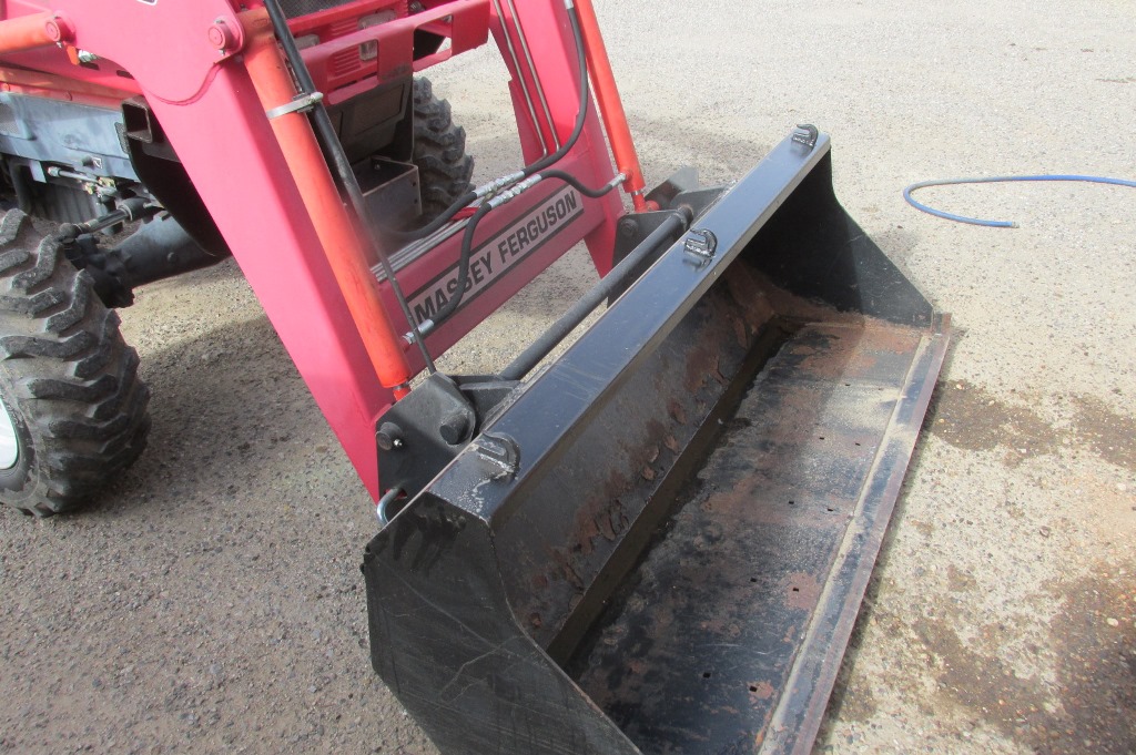

I also bought three weld hooks off Epay, and welded them on the bucket. Buckets should just COME with hooks... You can also see in this pic that the bucket uses the Global or Euro style QA system. I have a set of pallet forks on order, and it is really easy to remove and install the bucket, and you only have to un-latch the pins... They auto-latch when you roll the bucket back. :)

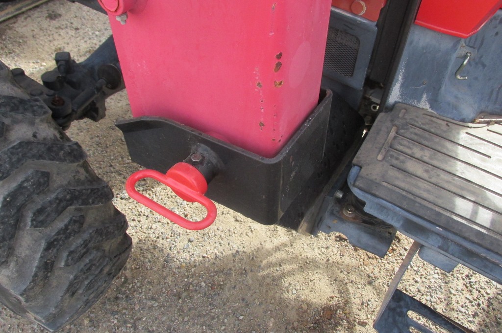

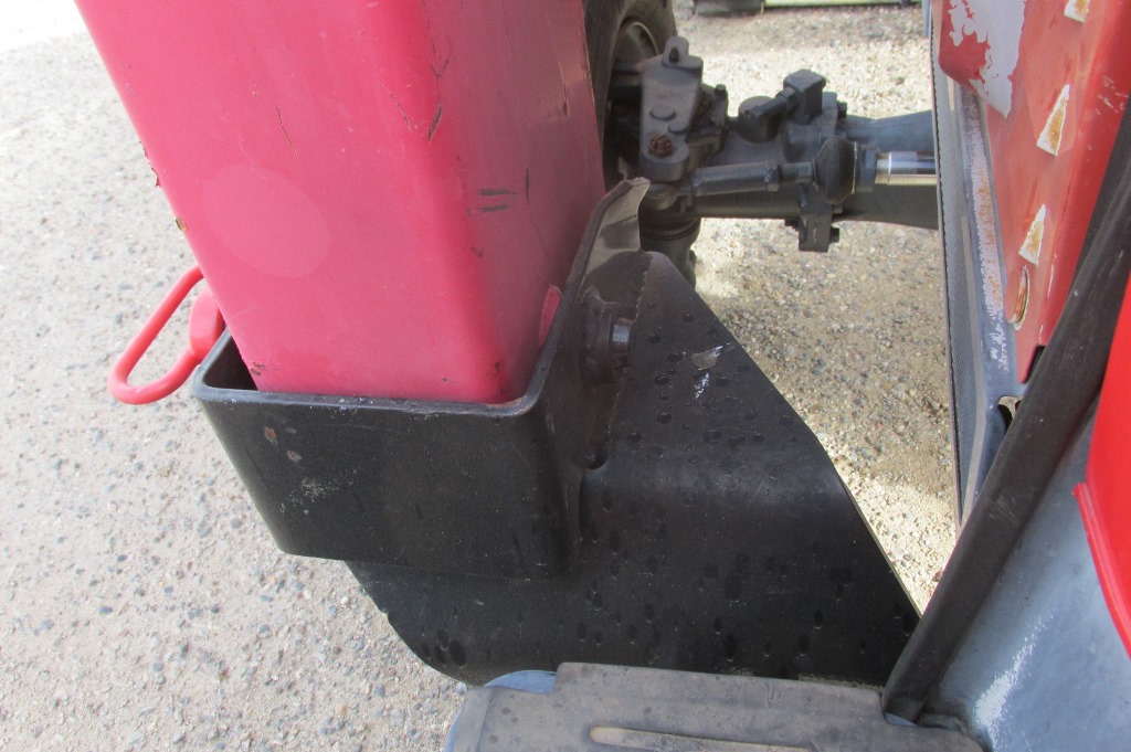

And finally, they couldn't find the pins that attach the loader uprights to the tractor, so we put in some smaller dia ones and just zip tied them in place for the ride home. I bought two 1" red handle pins that are JUST long enough. Drilled them for the retainer bolt. Much better!!

I don't know how it was done, but the front cross piece of the loader was bent upwards in the middle, so the headlight holes were all distorted... Possibly from it hitting the front "bumper" of the tractor when they were removing it, or from trying to block it up for some reason...
Hmm, I don't have a "before" picture...
Anyway, a little hi-lift jacking to pull it back down, and large C-clamps to straighten the flat sections, and it looks good again.

Pushing fence post in the ground, maybe? I have seen people use their loader that way.

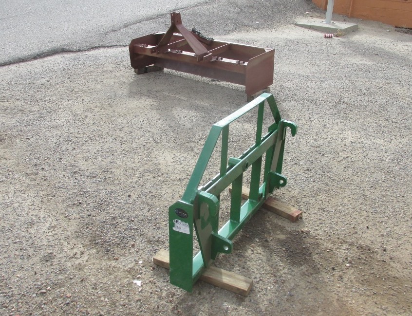

I ordered a set of pallet forks from Titan Monday, and they arrived this morning. I'm going to improve the looks of the pallet fork frame and my box blade right after work. I figure a teaspoon or so of gloss black in a quart of sunrise red should be pretty close to MF red... :)

Looks like you got a couple front lug bolts missing.
   / A loving home for a neglected MF1455v
#9
Not missing. Those are the two studs, and they are rusty on the front axle.
The piece that was bent was the bar in front of the headlights, not the bucket. It looks like they didn't understand how to remove the loader and tried to block it up... I think the prior owner was not mechanically inclined...
