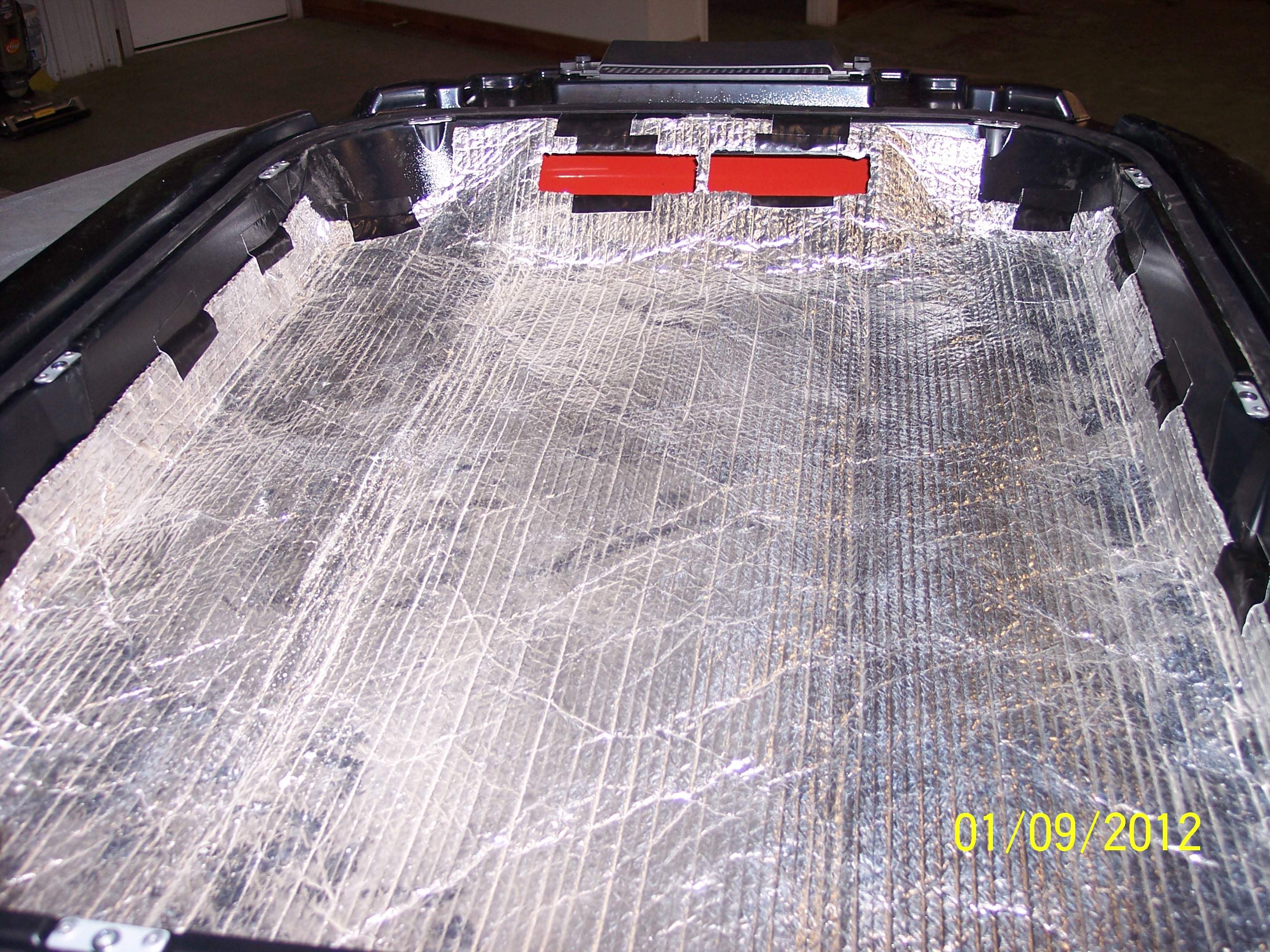

So this is tried and true by yours truly in other equipment, so I thought that I would share. By the way this wasn't my idea, but unfortunately I don't remember where I saw it so I'm sorry for not giving you credit.
This is my new L5740 Grand. Since I had to remove the roof for other mods, I thought I'd go ahead and do the simple insulation install. In some of my other equipment, the roof didn't come off, but the headliner came down and I was able to install the same way. Your just working upside down.:laughing:
I bought this at my local True Value hardware store in the home insulation section. It looks like bubble wrap made of Mylar. It's very thin, pretty cheap and makes a huge difference in your heat and a/c. I think it reflects more energy than actually insulates, but you get the drift.

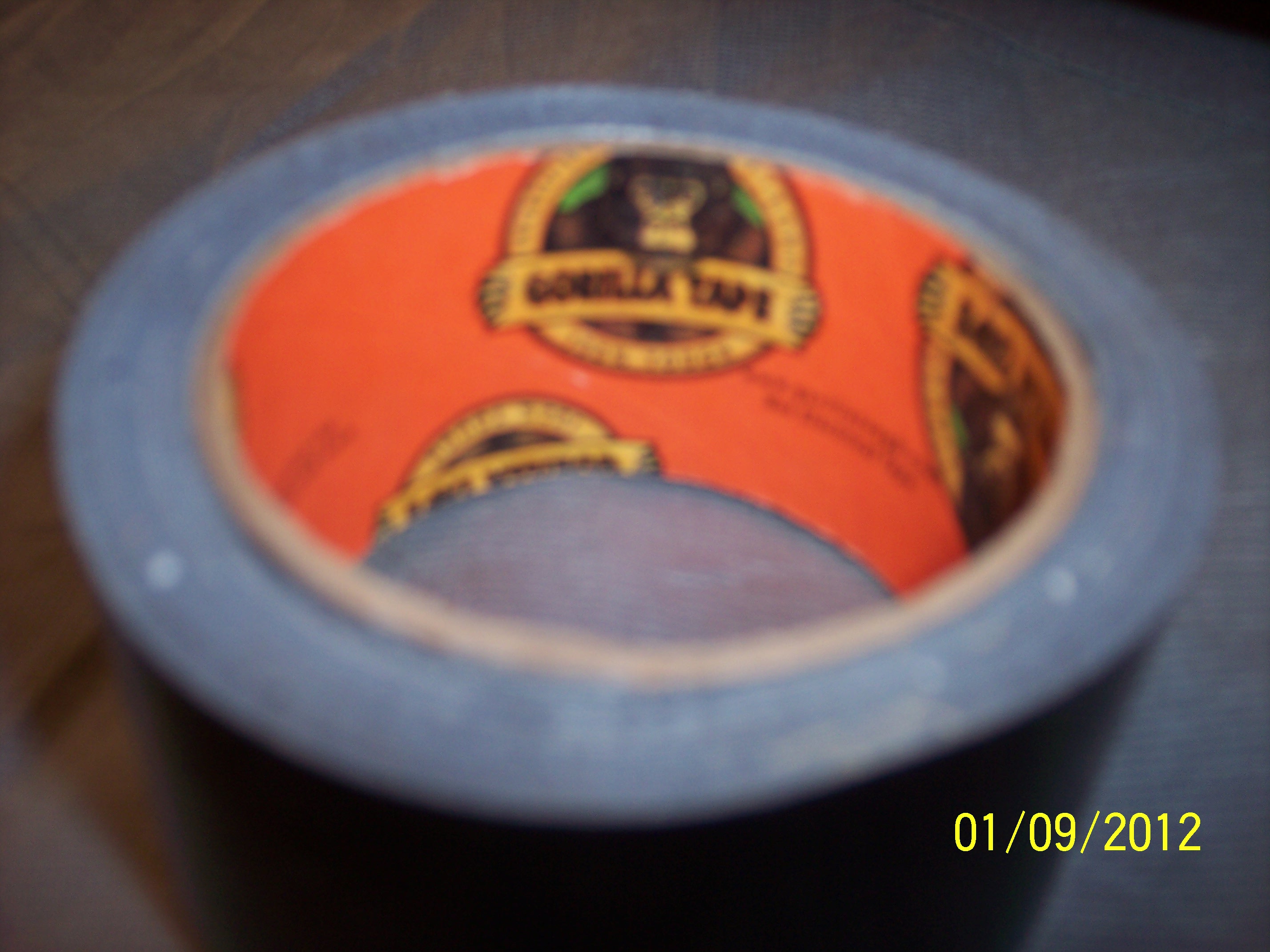

I used Gorilla tape. It is 100x better than duct tape, but more expensive.
Cut to fit and tape in place. Just that easy.
You'll notice that you have your heater and your a/c turned down the next season. In my opinion, I think they work half as hard.

Honestly I don't notice a difference in noise insulation. Probably because it is on the roof and not on the floor. I suppose you might not hear the geese flying over after the installation. :laughing:

Very true! I will say that it is definitely not a necessity on the Grand L's, but I already had the top off, had the insulation left over from my other applications so I figured why not. We do get well over 100 deg F down here in the summer and I have yet to sit in a piece of equipment that will freeze you out in those temps. But the insulation did seem to reflect a lot of the sun's energy and made the a/c work half as hard. Especially when it is mounted in your roof.:laughing:

If your cab is like mine, it is way easier to remove the whole top. I think it is 13 10mm bolts that hold it down from the inside. It's not all of the bolts. Just the ones on either side of the corners, across the front, one in the back middle and a few on the sides. If you take a bolt out it should be long. If you take one out and it is a lot shorter than the others, you can put it back in. The ones across the front are a little shorter that the others but they still have to come out. Keep track. The little short ones only hold the liner. Seriously, with a cordless impact driver or drill driver, you can have the top off by yourself in a couple of min.:thumbsup:
