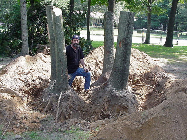

I have a BX22 and I've been working on a few stumps at my house out on Long Island The 22 is about the same as the 23 I'm not saying you can't move them but I don't think your're going to lift them out of the hole.Maybe you might want to rent a machine for the job you are doing now and purchase the 23 after the heavy work is done.Attached is a picture of what I've taken out .I removed one already and have two loose and ready to come out.It's a slow job but I'm retired and have lots of time.
Good luck

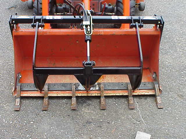

Don't know how I missed this thread, but I did. I have a working grapple on my BX22 and it has been great assistance to me for moving brush, rocks, trees, and many other things. I know that the change of the loader valve design on the BX23 has presented another dimension to this existing grapple, however after speaking to the manufacturer it looks like a mount to accommodate the new style BX loader valves will be completed in time for spring clean up work. Here is a picture of it mounted on my BX23 bucket in the closed position.
