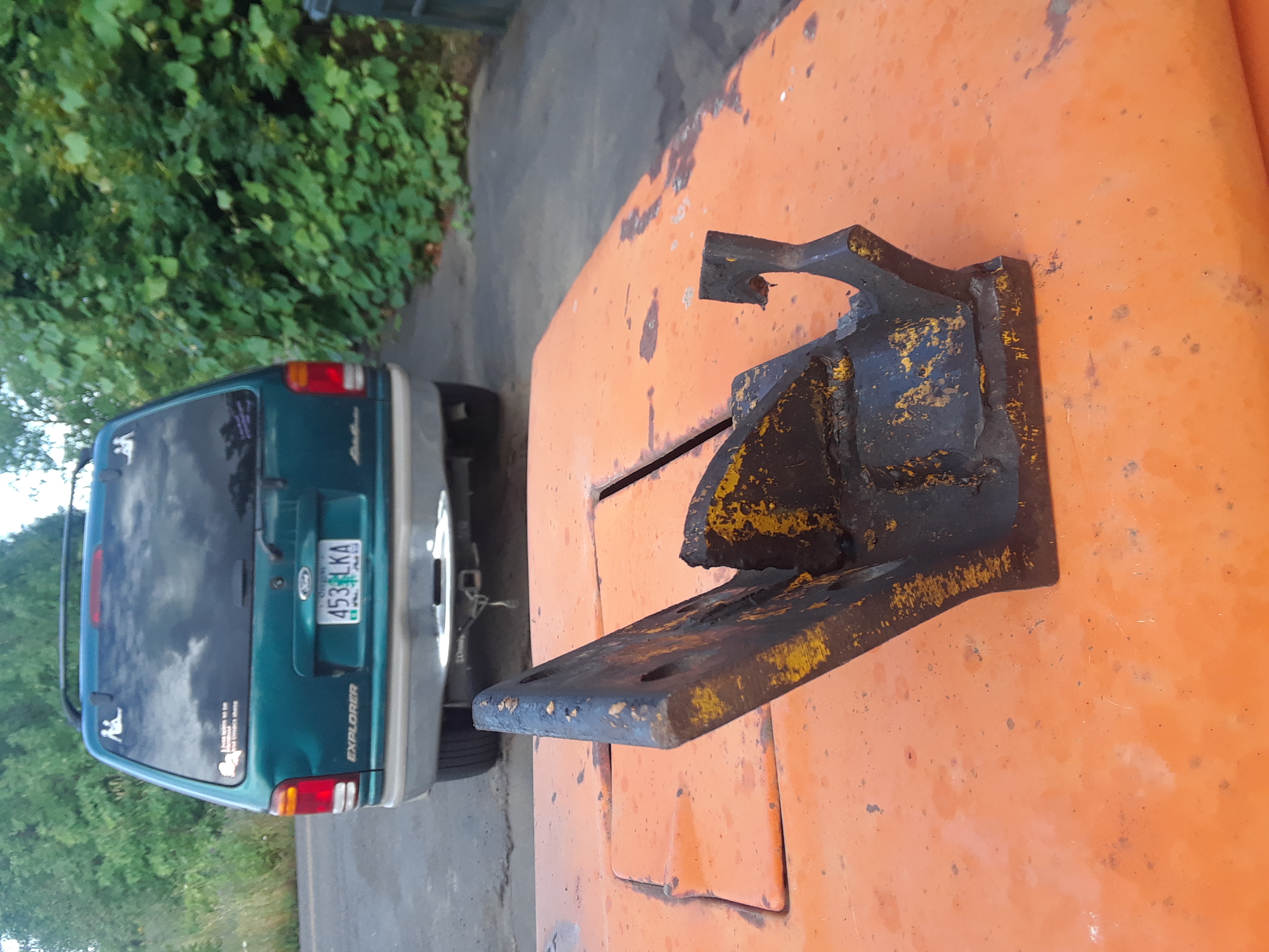

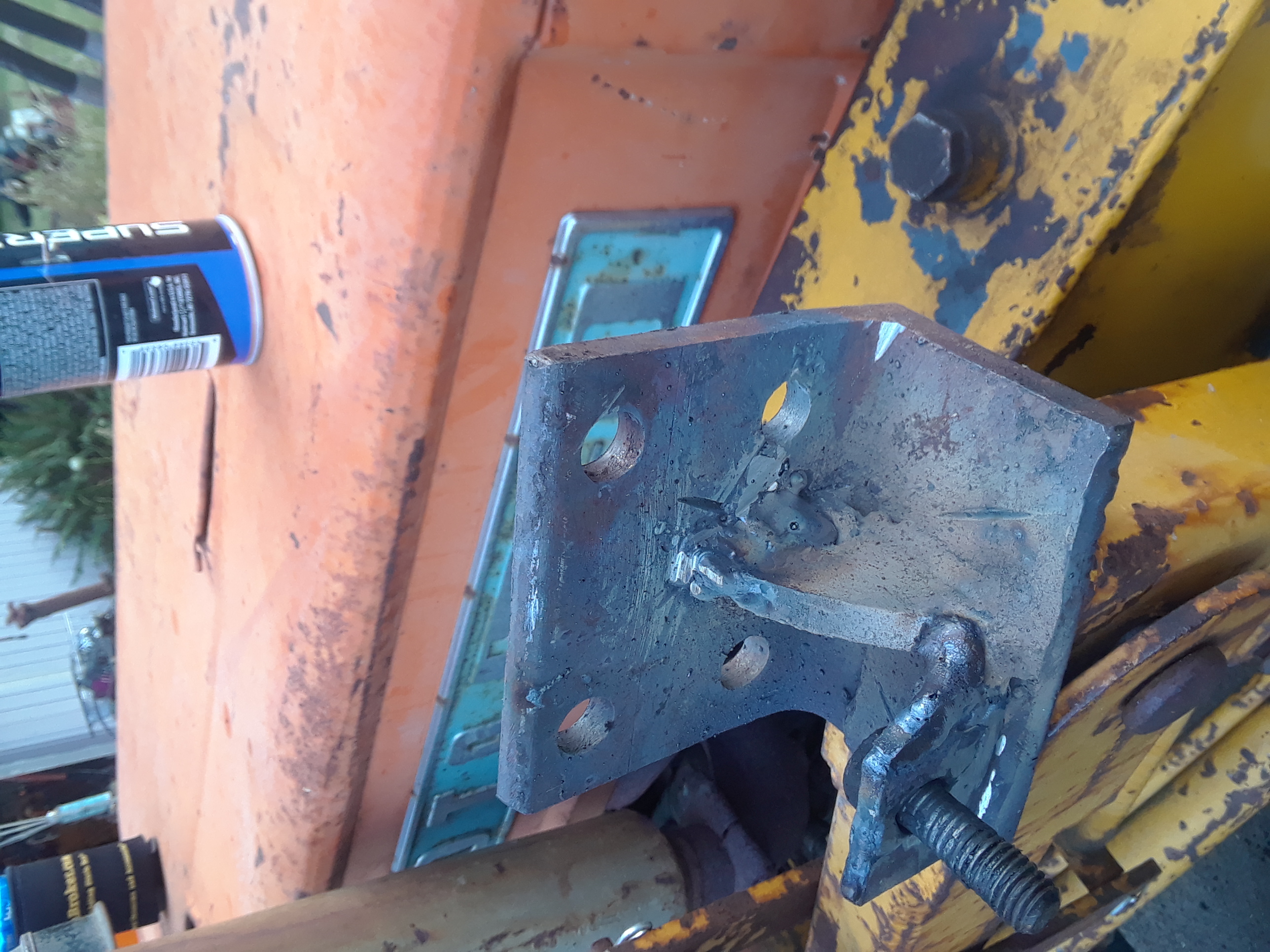

Here's one of the brackets on my FEL before and after repairs... took about everything I had metal working tool wise to get it back to normal... I had noticed the brace broken a few years ago but was waiting for the right time... then this summer I heard the twang of the bolt pulling through... that was the right time to fix it :)
I tell ya what, the loader is MUCH more solid after fixing it... even better with some better hydraulic hoses and a new belt for the pump...
