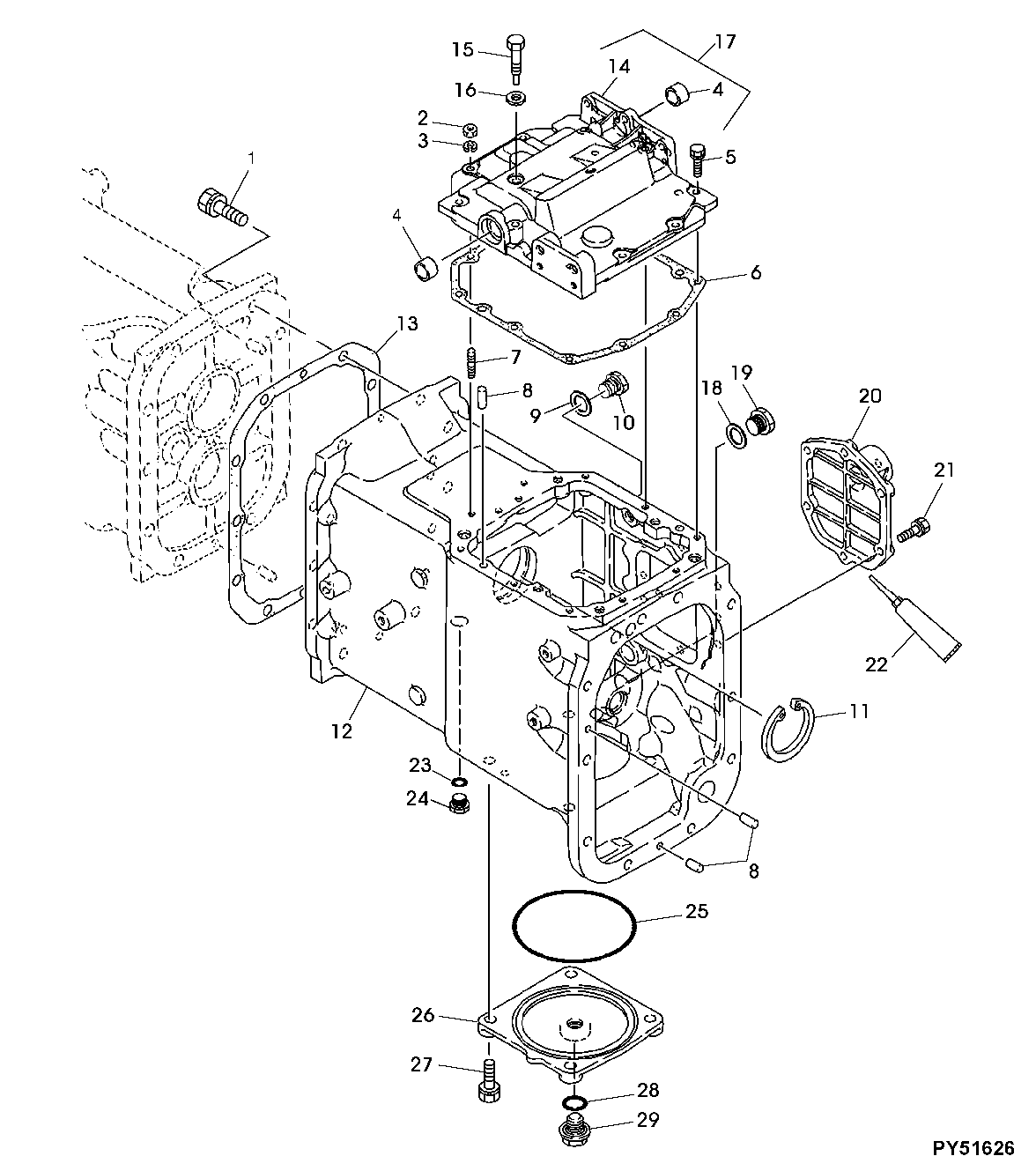

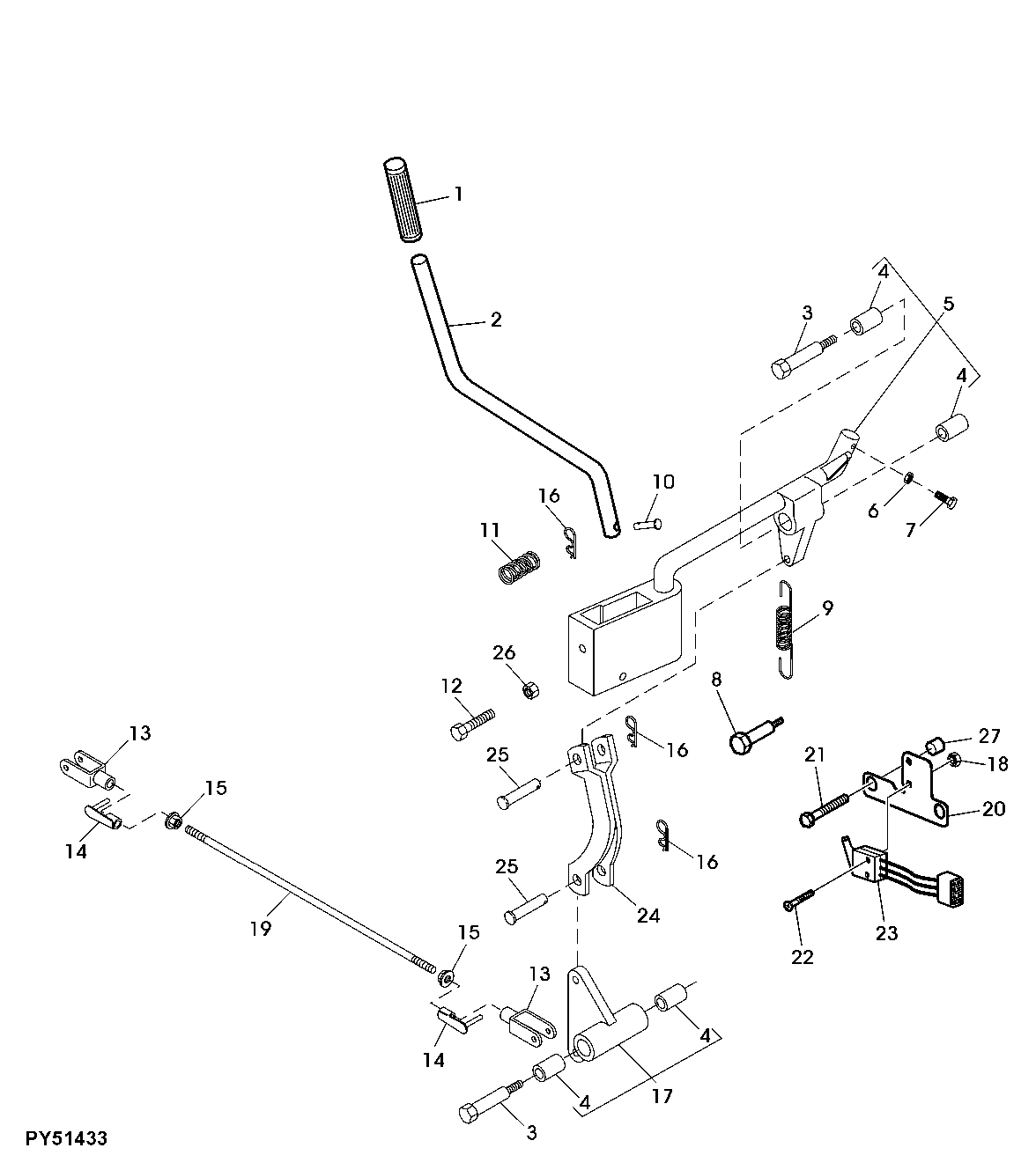

The plate on top of the transmission where the PTO lever attaches broke off. It is a threaded hole where only one bolt
holds the PTO lever in place. Looks like a very poor design to me.
I figured to get the days work done, we could position the PTO lever by hand to engage the PTO, but no such luck.
Why could we not get the PTO to engage manualy?
Any ideas on a fix?
Thank you

It's a shoulder bolt. Extract the broken piece and replace the bolt. If the bolt was loose, it would bind, breaking the bolt. Make sure the adjustment is properly done.

The bolt did not break, the hole the bolt goes into broke. It is part of the transmission, the upper case cover. No pics, sorry

Which bolt broke?

Might be time to try JB weld. I don't really like the stuff but it beats replacing an entire case. That's a whole lot of labour whether you pay for it or do it yourself.
