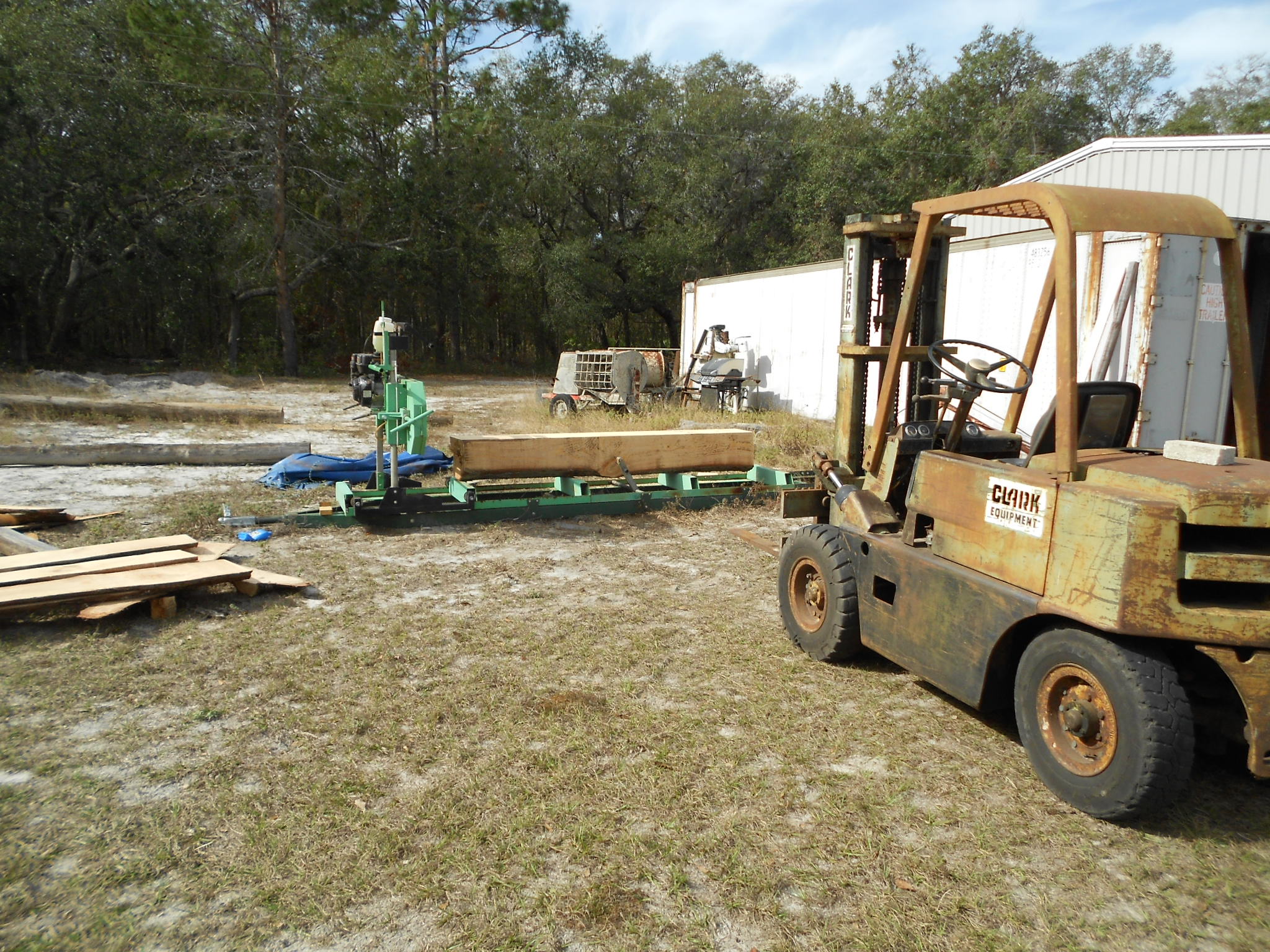

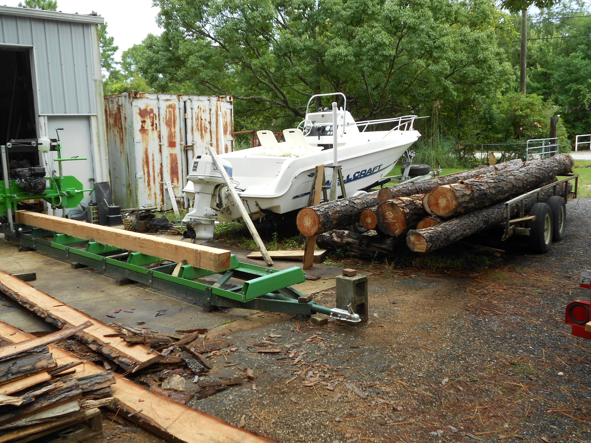

Here are pics of my old property and my current property.
I have been using my HF mill on the ground with no problems.

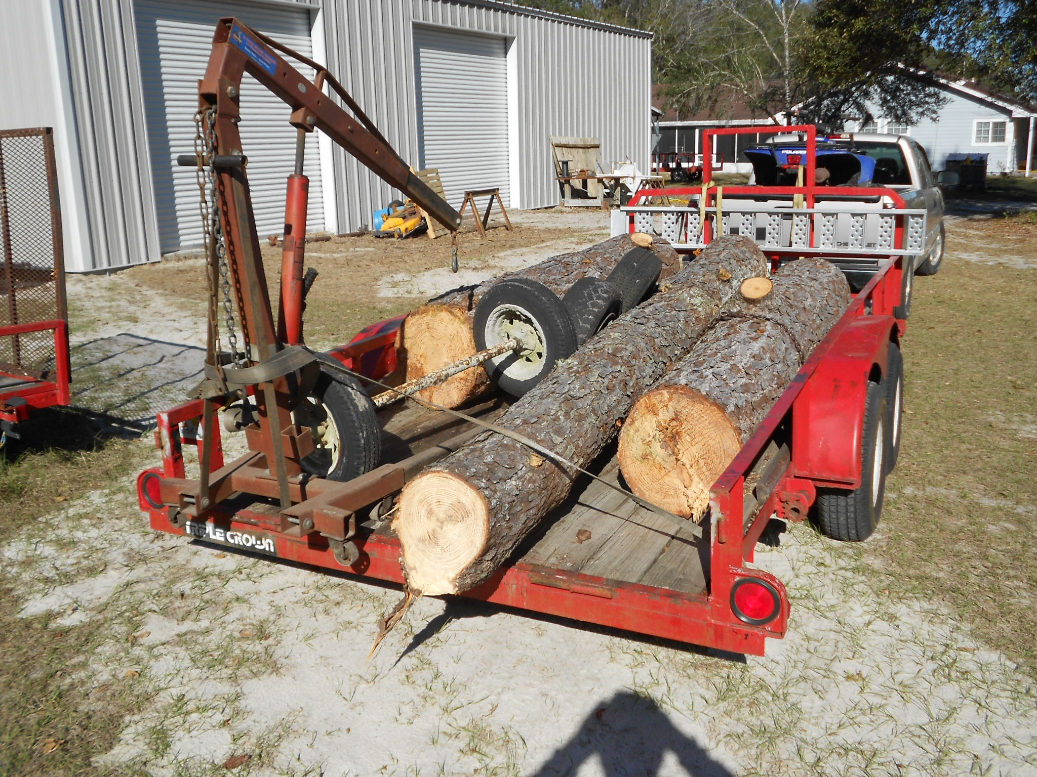

I got some logs a couple weeks ago (on the trailer) I had to load them with the engine hoist and com-along!

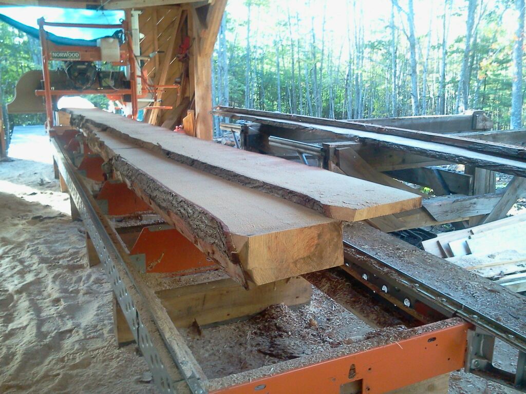

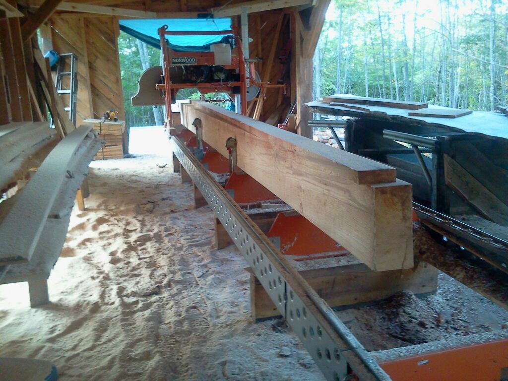

I like the idea of having a 4' wide, 4' deep, 8' beyond building length long dug out pit under the sawmill floor, for some sort of sawdust removal, like maybe conveyor belt, or maybe a long sawdust box that can be dragged out when full. At my mill if I had removable steel grating in the floor for sawdust to fall threw, it would save me a tremendous amount of time pushing sawdust out the side hatch into a sawdust box.
