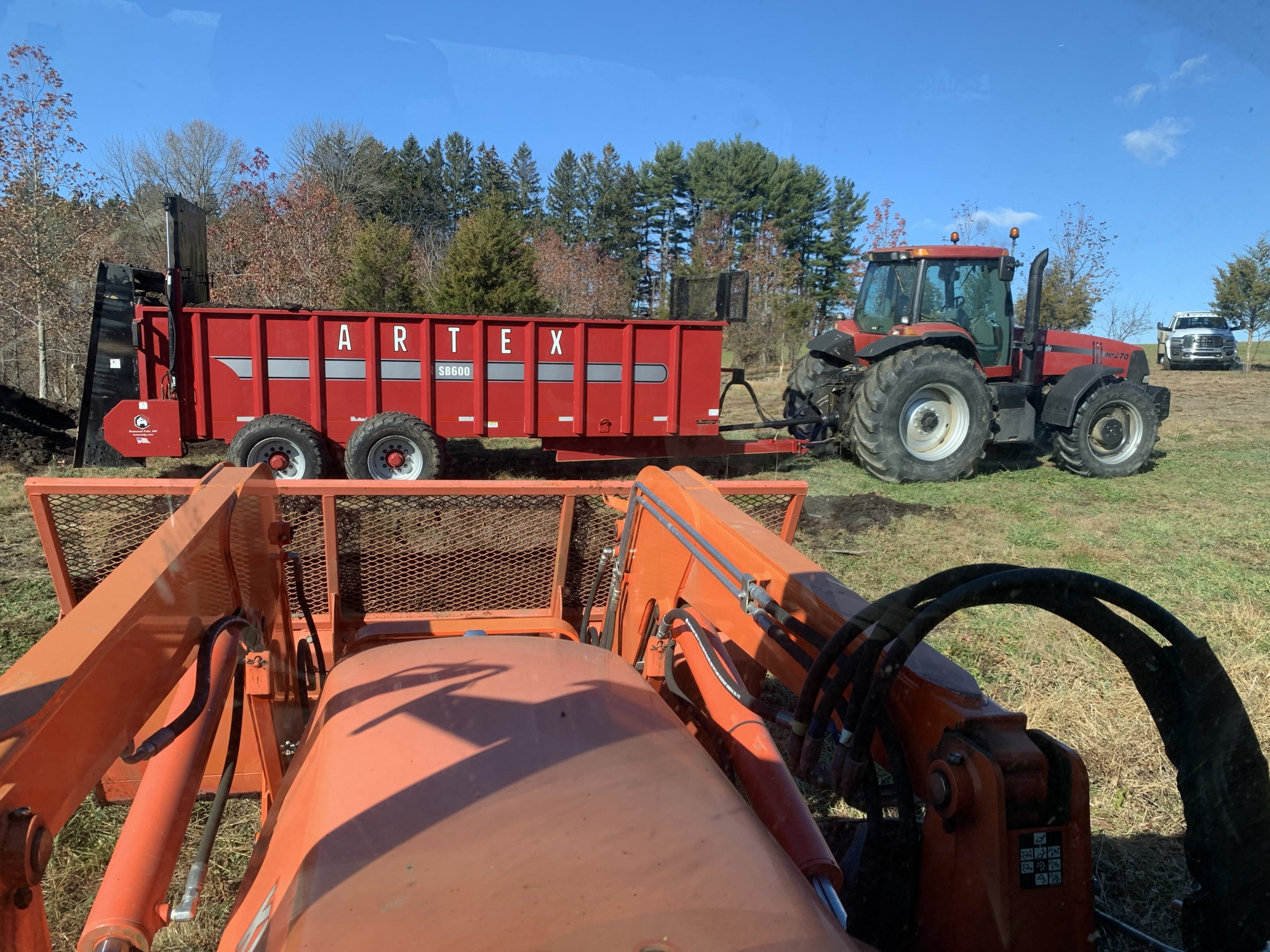

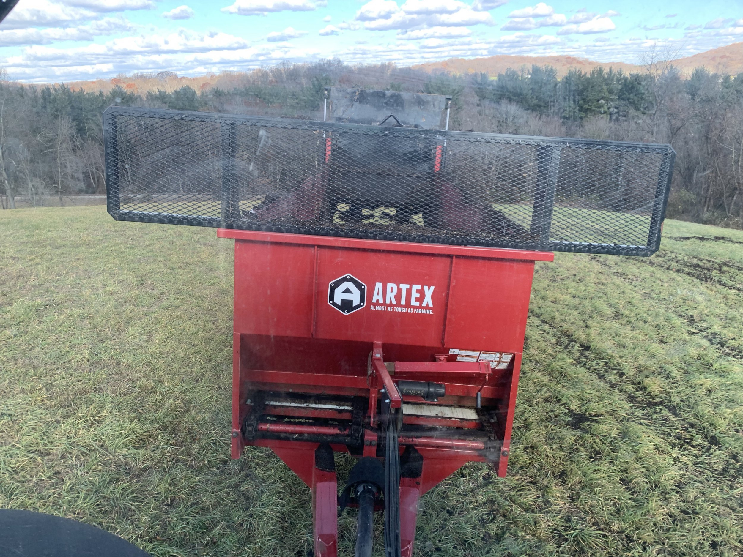

Well here we go. Day one of the next phase of hay farming….fertilizing about 300 acres with compost soil. I got the spreader as a long term rental. Used to own one, but it didn’t make sense. I rented an Artex 600 bushel. Nice unit. Looks barely used.

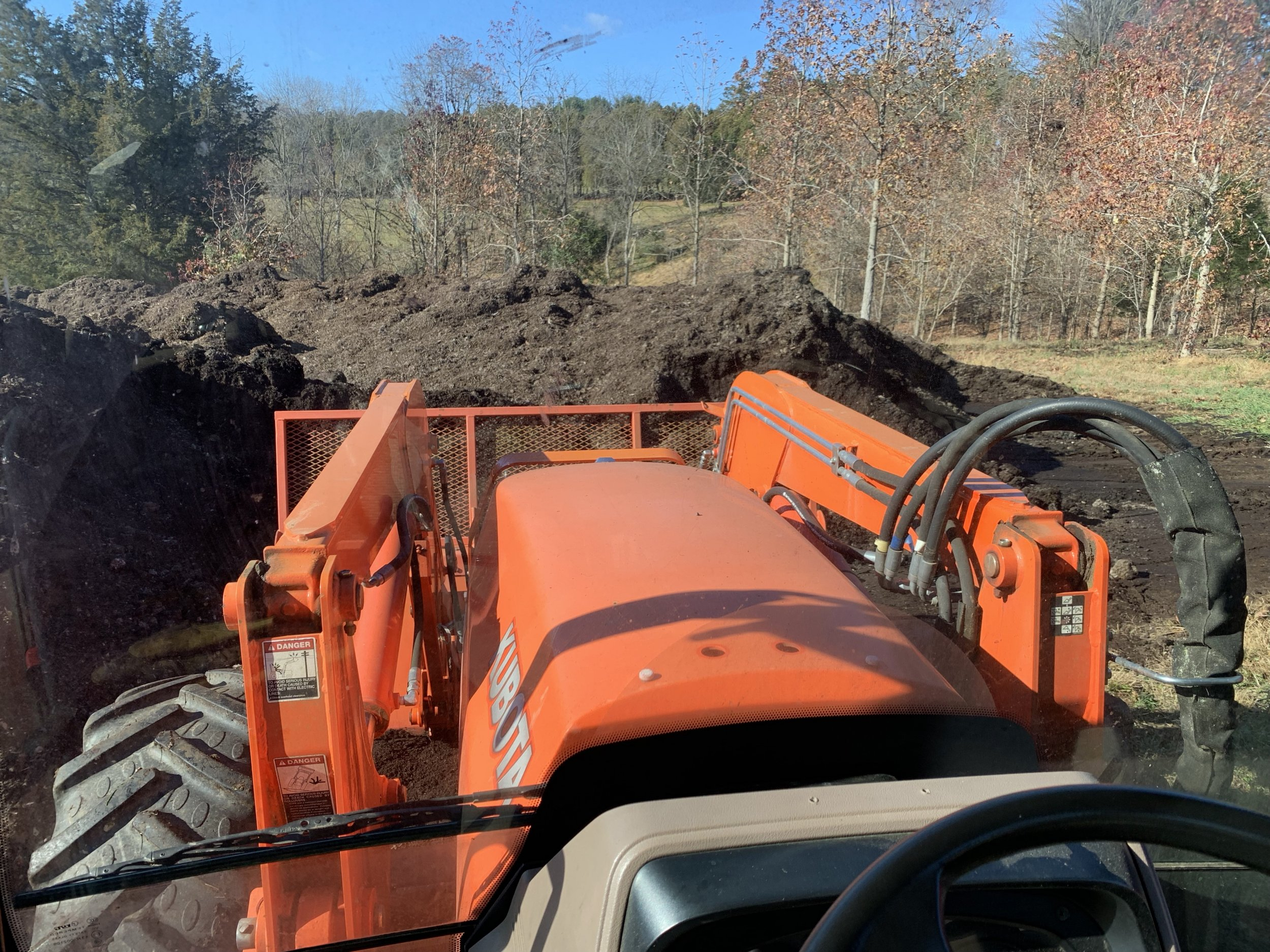

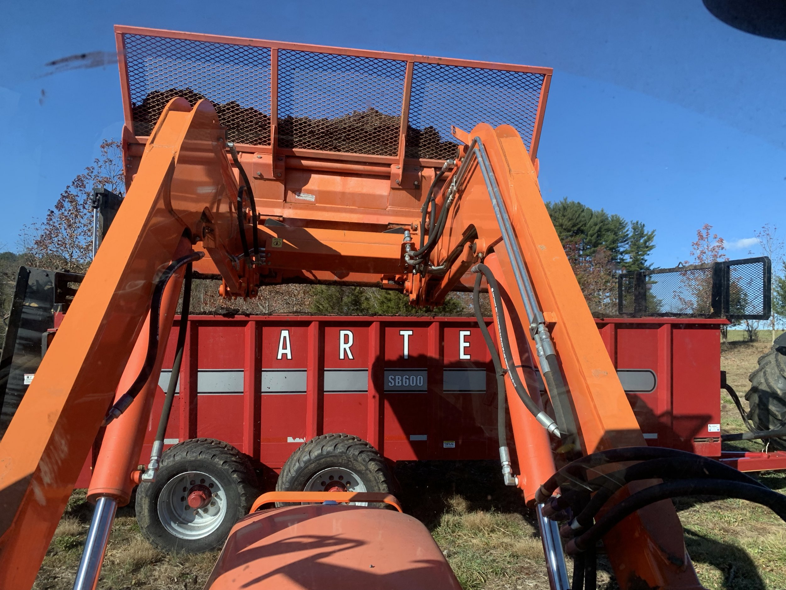

Loading scoops into spreader with the M126X and a high capacity 8’ bucket.
I made the reinforced screen mounted on the back to keep soil from tumbling over the backside onto the hood. Allows for a more heaped scoop as well.

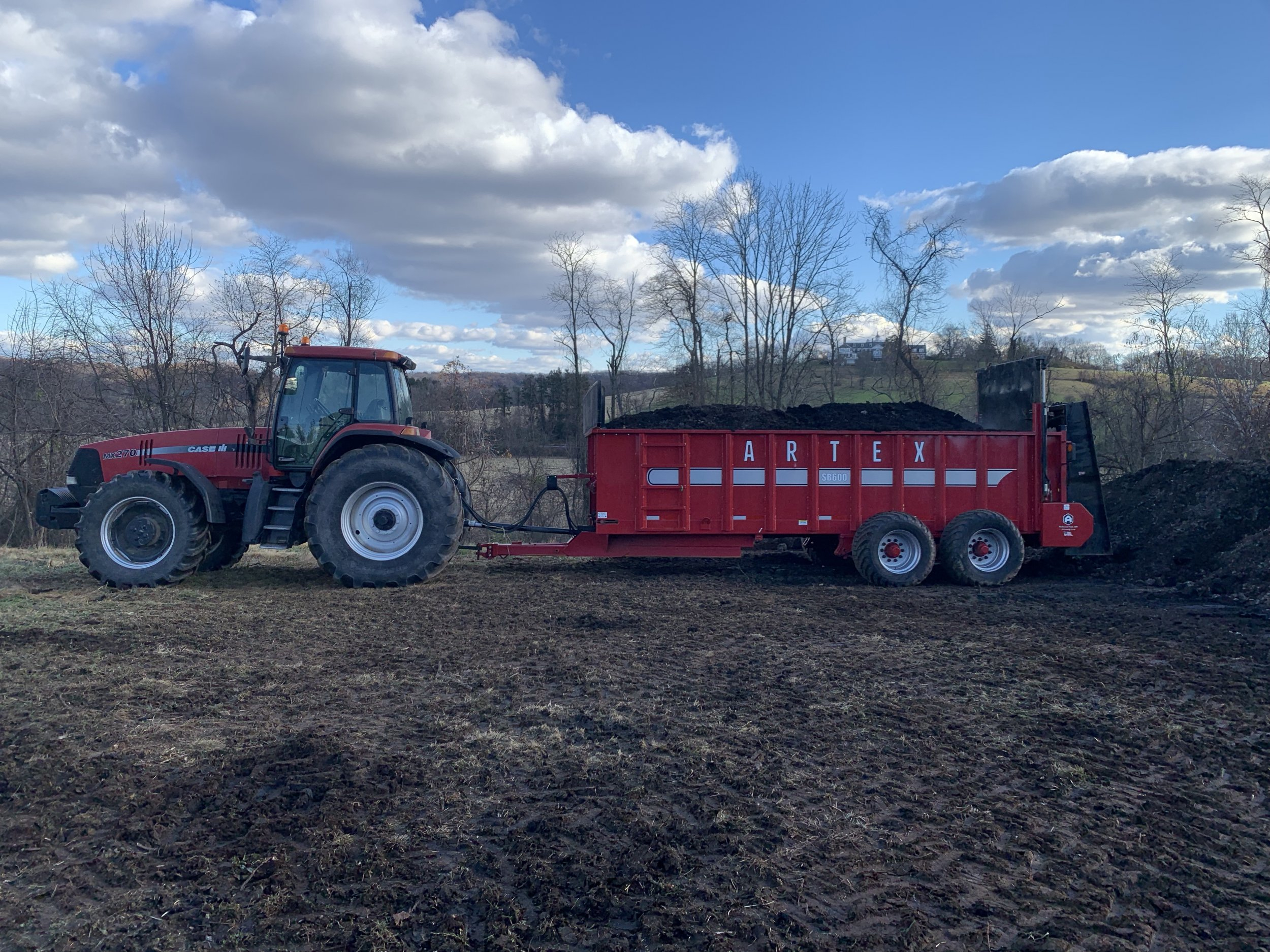

Back to the pile for another scoop. It was chilly and breezy today. About 40* and sunny. Love it. Hawks flying around, foxes and natural beauty

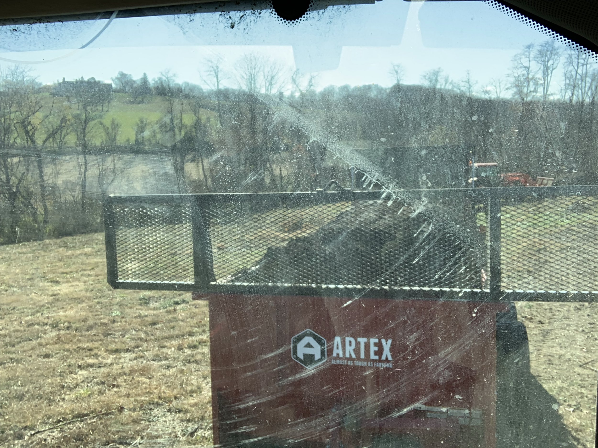

Fully loaded and off to the fields to spread. Think my windows need cleaning? Lol

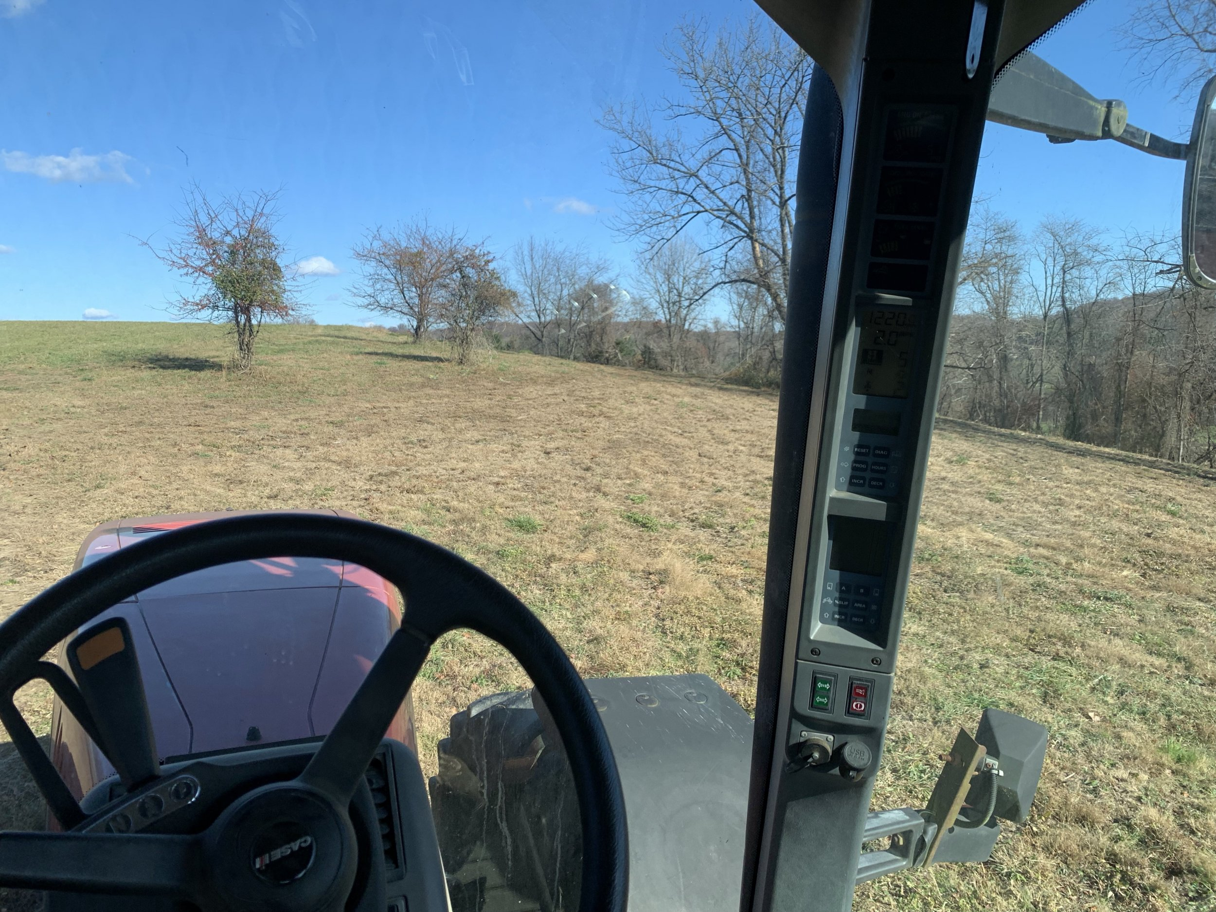

View out windshield

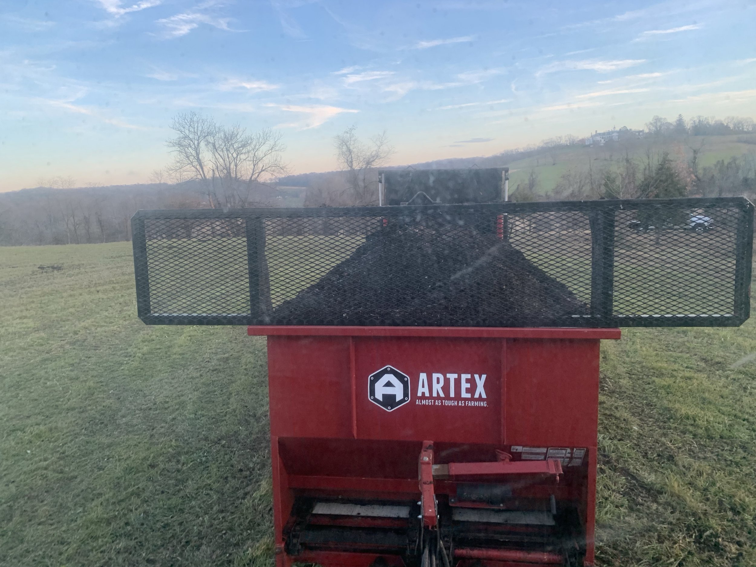

View of spreader out back window.

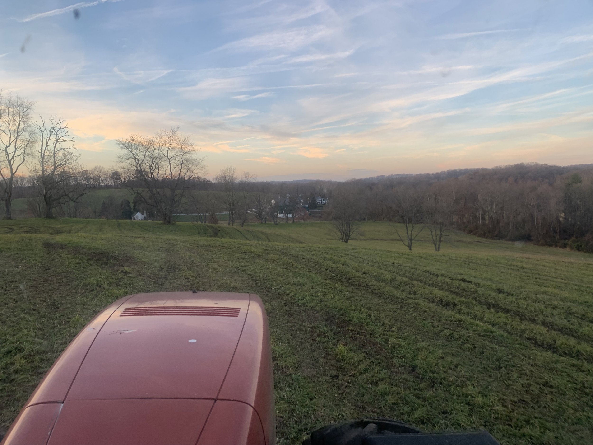

Returning empty for another. See anything significant off in the background? It’s East Penn Railroad!
I only spread 15) 600 bushel loads today. Not as much as I wanted. There’s 30 tri axle loads here and I got maybe 1/3-2/5s of it spread. Parked spreader for the day. Tomorrow should be more productive. Check out the DuPont mansion in the background.

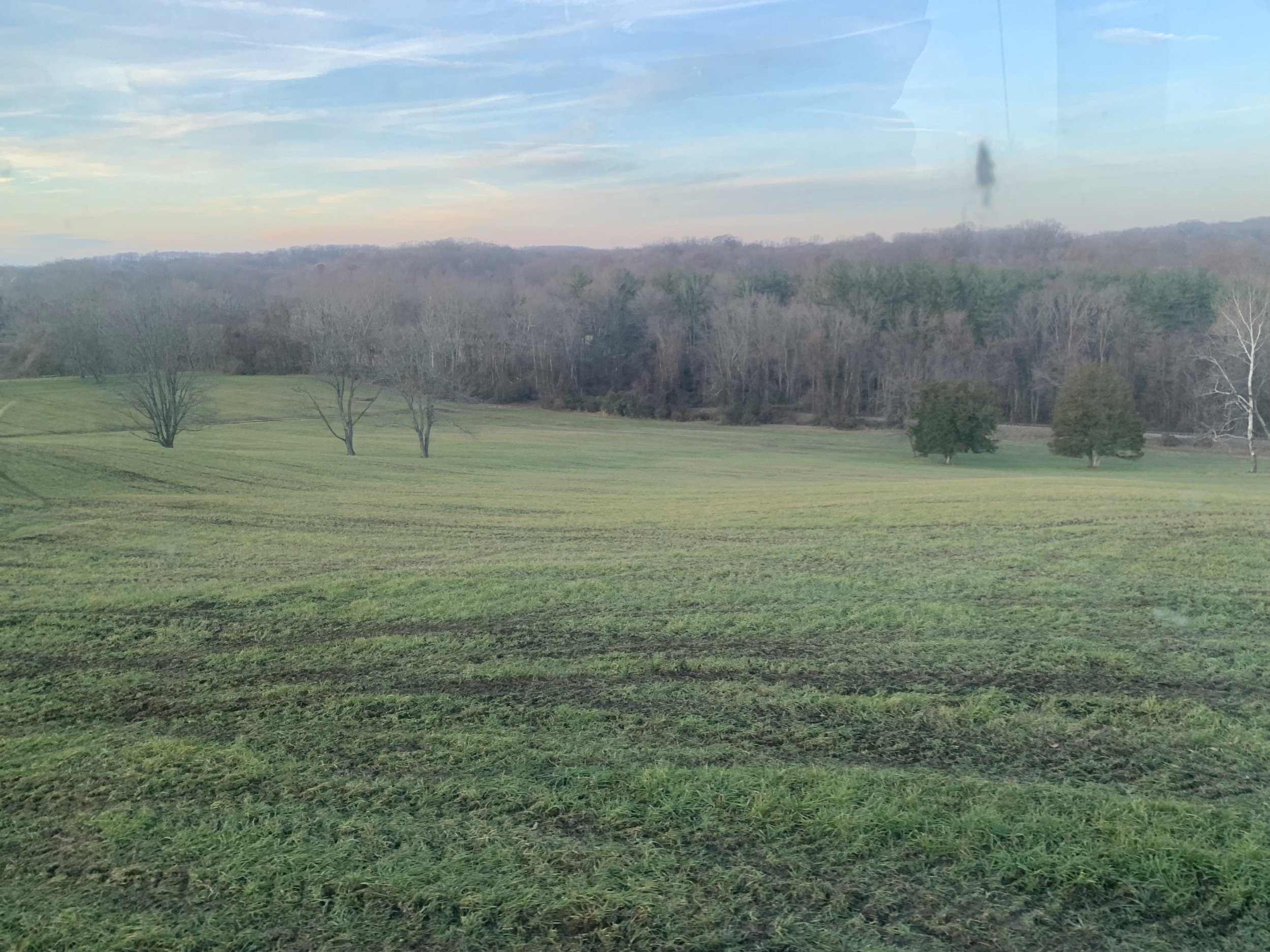

Heres a view of one corner of the property.
