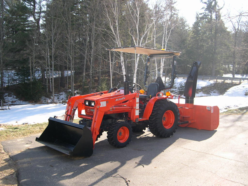

That's the one I used for 4 seasons. Would be using it again this year if I hadn't changed tractor and upgraded cover.

Bob:
thats a nice looking cover on your new rig. where did you find that one ?
Jim
   / A drafty but dry cab for a tightwad #25
Jim,
This is the distributor Who We Are. They do not sell direct to the end user but you can order it on their website and they will contact you and have the order placed thru one of their dealers or a dealer of your choice.
Very easy to install. Cost about $900. More than golf cart but less than Sims. Only use a cover in the winter months so this works for me

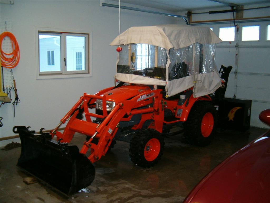

I just came in the house after blowing snow for the fifth time using this butt ugly snow cab contraption. I agree with Hillbilly, "Functionality rates at the top". I am going to even raise the bar a bit as I am experiencing zero condensation problems thanks to the drafty nature of this beast. So far I have yet to turn on my $20.00 defroster I bought on EBAY...........ymmv.
So perhaps I have forgone an air tight draftless expensive heated cab and settled for a no snow in the face and an out of the wind environment. But it literally cost over two thousand less dollars. So let's say it like it is and proclaim Butt ugly is beautiful but only when you are on the inside looking out as you blow snow protected by a snow cab from Tightwad cabs Incorporated.
After using my CK-20 and rear snow blower for the last two years it is no longer necessary to put on a snowsuit, snowmobile helmet with shield and pak boots just to go out and clear the snow. NO siree, not me.

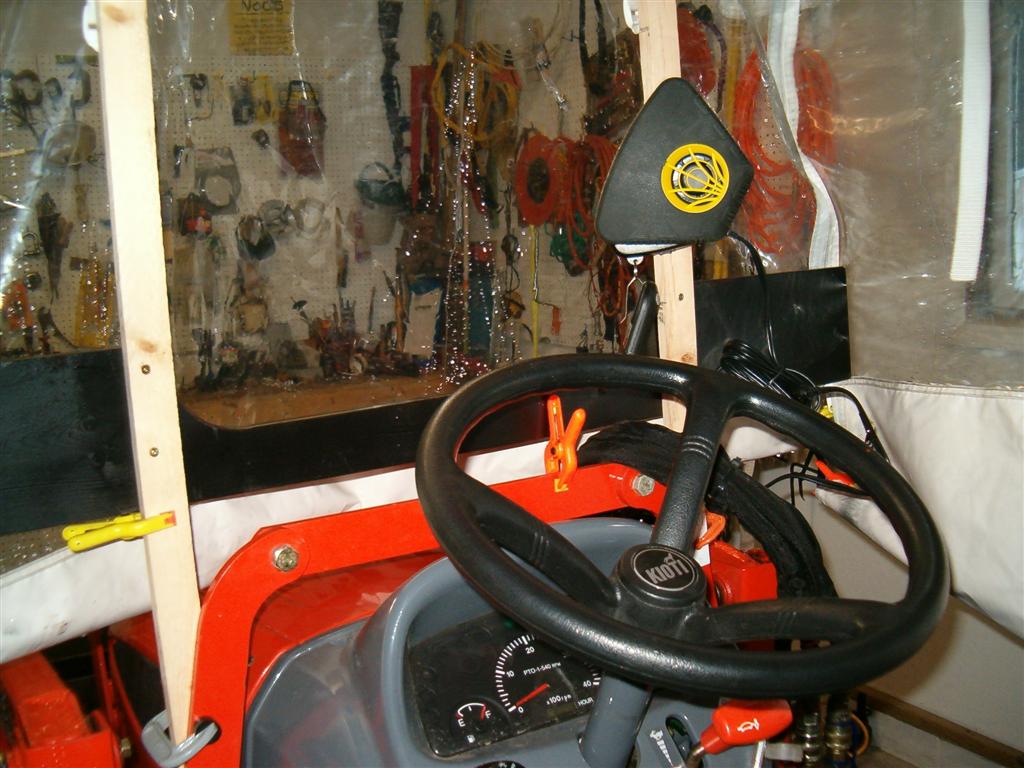

Yes,, I really do believe it would work. As you can see from my earlier pictures. I C clamped a couple of vertical strips of wood similar to your front uprights to help give the golf cart cover some shape. I have further refined my frame with some cross pieces of 1 X 6 screwed horizontally with an area removed so as to not limit visibility. In the picture provided you will be able to see the 1 X 6 with a removed portion scooped out for visibility which is painted black.
If I had a top on my tractor and was blowing snow, I would surely spring for one of those golf cart covers (on sale for $79 at Northern Tool) linked in an earllier post.
