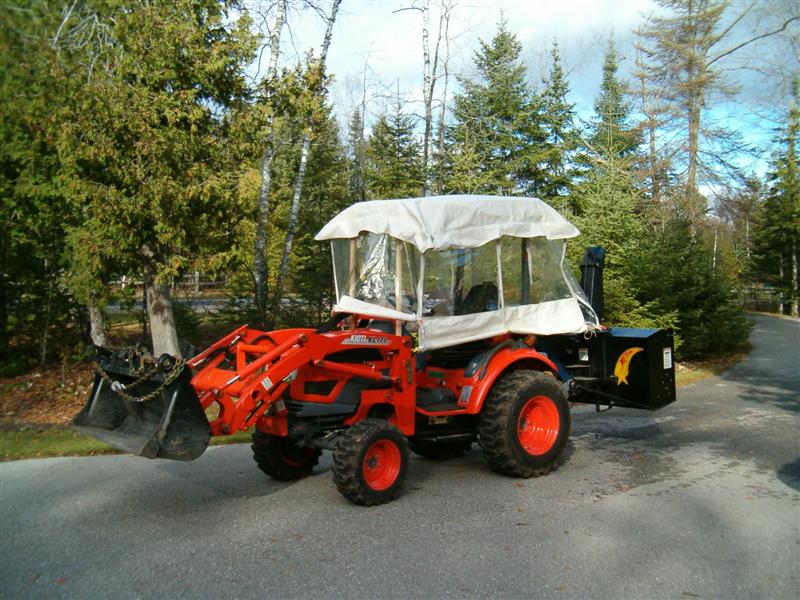

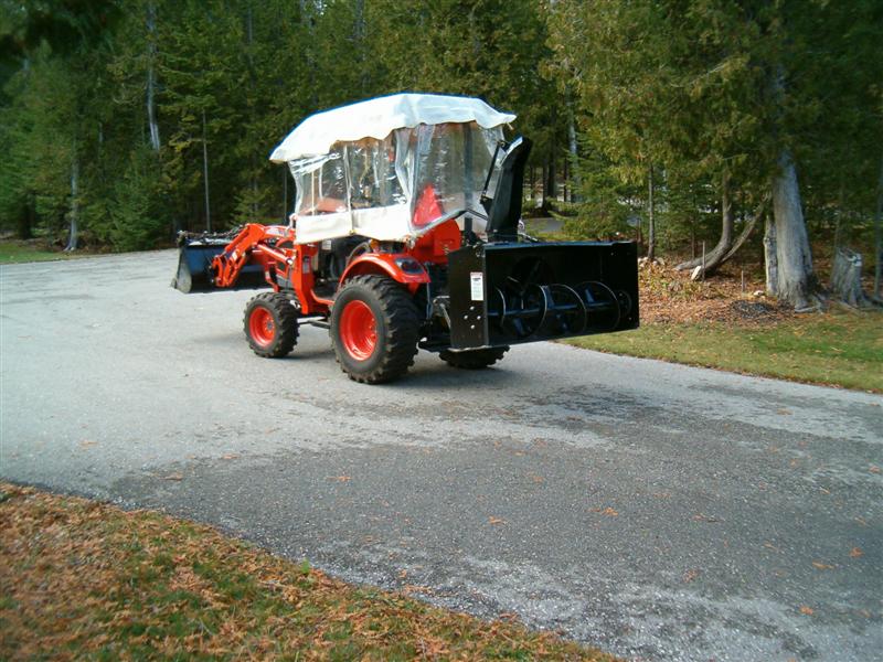

Weather and Winter snows are on the way. Last year after blowing tons of snow with my CK-20 (s) I vowed to do something different this year. In my area we get plenty of cold light powder snow. If one has to clear out the drive on a windy day just expect at some point the chute is going to be wrong to the wind and you are going to get a whitewash. This really feels great when it's 20 below.
Now that golf season has come to a close I thought about the windowed golf cart enclosure sitting idle all Winter. Now wouldn't that make a nice break from wind and blown snow if it were mounted on my tractor.
A call to Bob at Michigan Iron & equipment confirmed the measurements. The unused golf cart enclosure should drape nicely around the steel hung tractor roof. He shipped a roof up to me and I installed it.

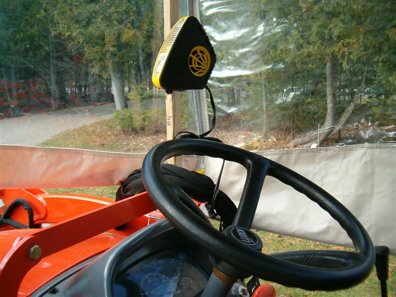

As you can see in the pics I have good clear visibility and access to chute cranks 360*. I got some light plastic abrsive cleaner and it really helped renew the clear window panels. Before throwing it over the new CK-20 roof lid I got four 2" c clamps and clamped a couple wood strips along the flat FEL mounting. This fit and aligned perfectly with predrilled holes in the tractor roof so I stuck a coupe big washers and screws to catch the wood framing. The wood strips make nice framing for that limp retrofitted golf cart enclosure.
Not enough snow yet to give it a field test but I'm thinking its going to be a great snow stopper and will cut down on some of the wind. I know, you don't have to tell me it's certainly no CurtisCab and yes, I can throw a cat through those intentionally left gaps in bottom. I'll just say that the draft is engineered into this model to defrost the cab if my 12 v defroster from EBAY blows a fuse. BTW, golf cart enclosures can be purchased right here at EBAY for as low as $69.00 and up:

Since blowing snow was one of the activities I KNEW I was going to be doing a lot with my DK45S, I got the factory cab (and hydraulic chute control for the blower). If you can control the fogging, your solution should work just fine...plus, you can take it off in the summer when the weather is nicer.

Yeah but..........I'm thinking it's going to look much better from the inside looking out and remain Ugly from outside looking in.
especially on a snowy windy day that I get to snowblow.
