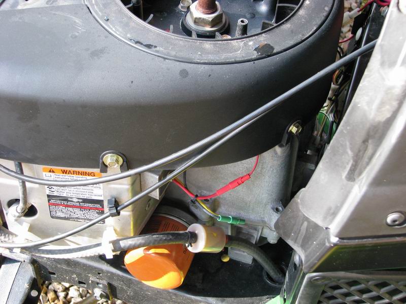

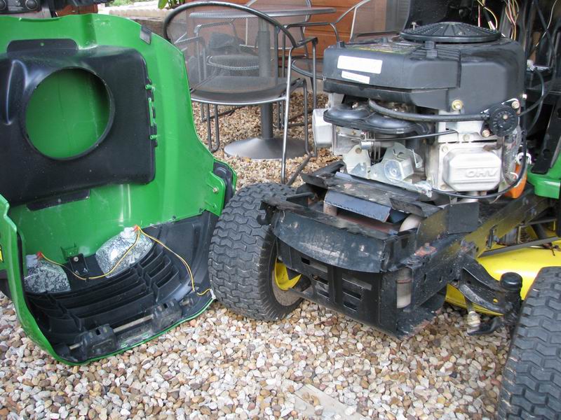

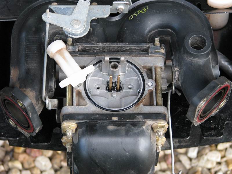

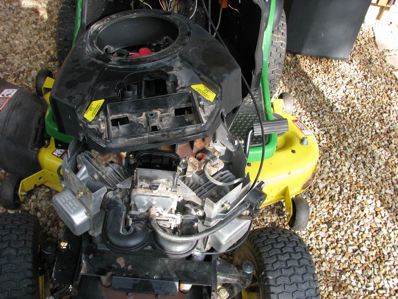

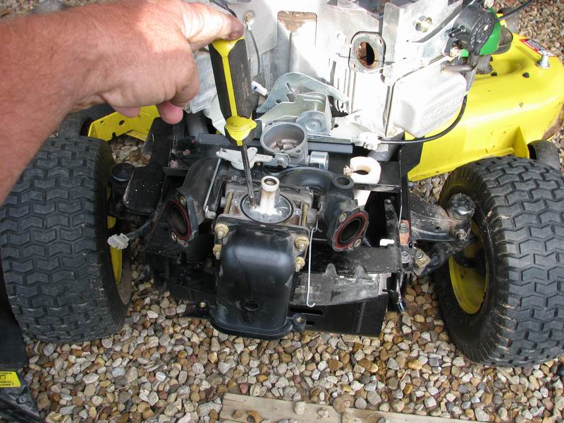

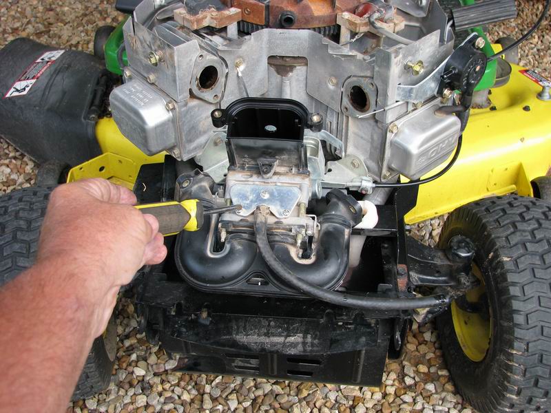

It's been a few weeks since I posted about the fuel starvation problem in my carbs. It turns out that I had problems again after mowing my 1/2 acre yard two more times. The mower stalled and refused to restart even with manual choking as before. It did fire right off when I poured a little gas down the carb intake. The problem did not go away when I removed the gas cap. Removing the hose from the front of the fuel pump also showed me that fuel was flowing fine into the carb. My problem was inside the carburetor, probably trash in the float bowl. I could hear and feel the fuel solenoid working, so that seemed to be okay.
I decided to remove the whole carburetor and intakes. Of course, these things never seem to happen when you have lots of time, so I hurried through the job and didn't take pictures. I found the carburetor mostly clean with very little residue, but what residue was there was black and fine grained. I cleaned everything I could see and checked the operation of the float valve and fuel solenoid. All looked good, so I reassembled the carb and put it back on the engine. When I completed the job, the engine roared to life normally and ran perfectly. I called it good and mowed my entire lawn with no issues.
After this, I mowed again and even posted in someone else's thread about how I had cleaned the carb on my B&S engine. I was sure I had found the problem. Well, I spoke too soon. Last week, I started the mower and drove it about 50 feet when suddenly it stalled. Nothing I could do besides pour a tricke of gas down the carb would keep the mower running. It was cleaning time again. Remember, my mower is still in warranty, but I don't know any warranty that will pay for cleaning trash out of a carburetor. I either have to do this myself or pay to have it done. This time I decided to do it myself and take some pictures.
Before removing the carburetor, I took off the whole hood for easy access. You only have to disconnect an electrical connector and then lift each side of the hood upwards and pull forward for it to come off. It doesn't require any tools. The rest of the pictures below show how to remove the engine cowling. After removing the inlet screen on top and six bolts, there is one screw to remove below the air cleaner filters. Then, the cowling lifts up easily so it is not in the way for removing the carburetor.

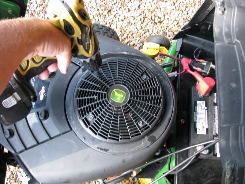

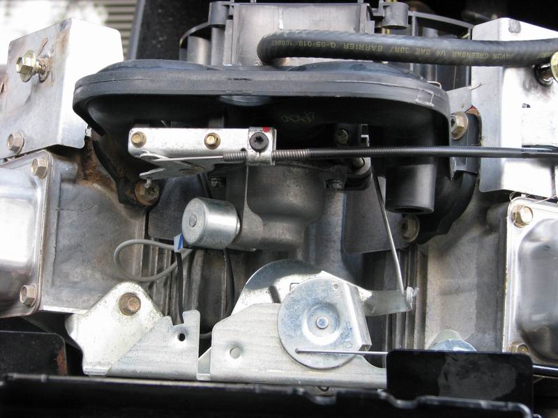

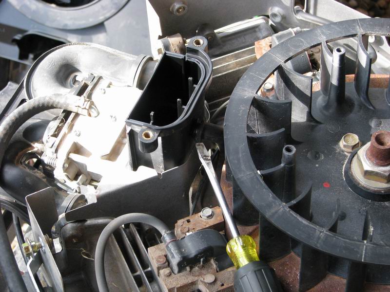

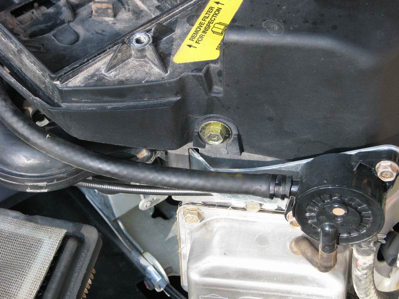

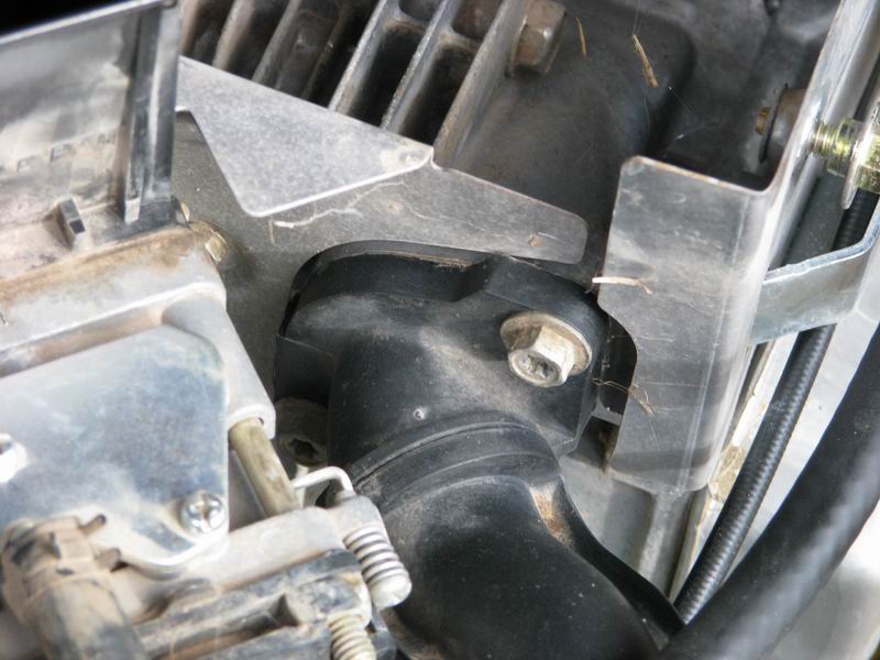

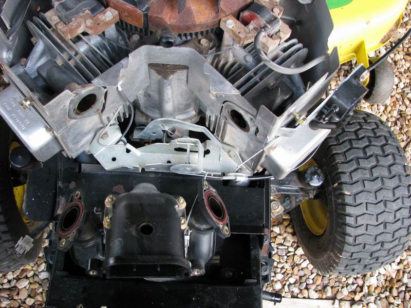

Next to remove the carb. There is a crankcase breather tube on the rear of the intake as show at the point of the screwdriver in the first picture below. This has to be removed before the carb comes off.
Next, there are 3/8" by T30 star socket fasteners holding the intake to the head. I used a 3/8" open end to break these loose and then the T30 for quick removal. You also need a T20 star wrench to remove the choke cable. That's all there is to it. My carb came off with no damage to the red o-ring seals to the engine intake. There is one throttle link under the carb, but it comes off by simply turning the carb and carefully unhooking it. The fuel solenoid is easily unplugged also.

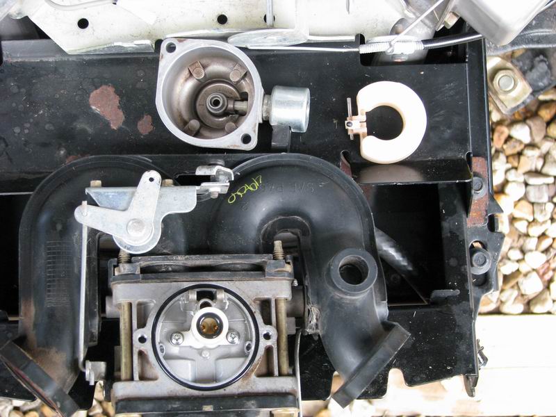

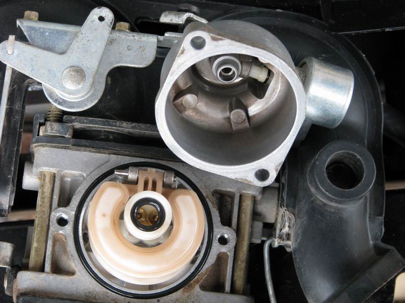

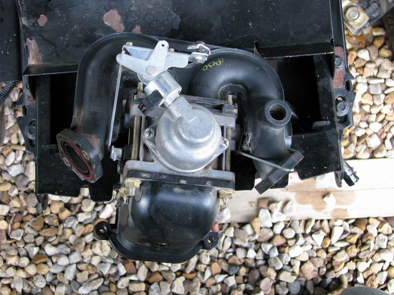

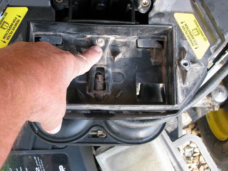

After the carb is off, it's a matter of carefully opening the float bowl and cleaning orifices. The first picture below shows the carb turned upside down and the two screws that hold the float bowl. These are probably the two tightest screws I found. You need a large flatblade screwdriver or a large phillips to make sure you don't burr the head on these screws.
After removing the bowl, and turning it over, the next picture shows how the fuel intake works. there is an o-ring that seals around an inner sump inside the bowl. Fuel from the outer bowl is only allowed into this sump when the fuel solenoid is energized. The outer sump fills by action of the float and float needle valve. The o-ring must seal for this to work properly; however, if the o-ring does not seal, it should not cause the mower to stop running, it should just let fuel bypass the solenoid valve.
The tower with the two orifices and o-ring is removable with two screws. At the top of the tower is a 4-o-ring assembly that is very critical. This must seal for vacuum to draw fuel from the float chamber.
Flipping the carb over reveals a cover plate for the carburetor orifices that feed into the intake. This cover has three screws and can be carefully removed without damaging the gasket.
After getting everything apart, I used Berryman B12 Chemtool to clean the carb and all parts and orifices. I wiped up all residues and made sure the fuel solenoid was working by plugging in the connector and turn the key on/off a few times while watching the plunger. I also put fuel in the other bowl around the sump and watched it flow into the sump with the solenoid engaged.
After cleaning, I installed everything in reverse order but put a thin coating of litium grease on all the o-rings to help seat them again. I also did that on the gasket above the orifices. I also put on a new fuel filter and cut the old one open. The original filter was full of the same black power that seemed to be inside the carb float bowl. I think this is just manufacturing residues that are not cleaned well. I don't know how else to explain it. This is all I have ever found in my carb and it seems to the the clogging culprit.
The mower again started and runs perfectly. Is this the end of the saga? Who knows? Am I sure there was no water in the fuel? Not really, but if it happens again, I'll remove the fuel solenoid and drain the float bowl first to see if that makes a difference.
All-in-all I think this was a pretty easy bit of maintenance, but it is frustrating to have this problem crop up repeatedly on this mower. When I don't have a fuel feed problem, the mower runs great. I'm still happy with it overall. I probably wouldn't be so happy if it weren't so darn easy to work on. In that regard John Deere and B&S have done a superb job.
I hope these pictures and my ramblings might help some others who experience similar problems.:)
