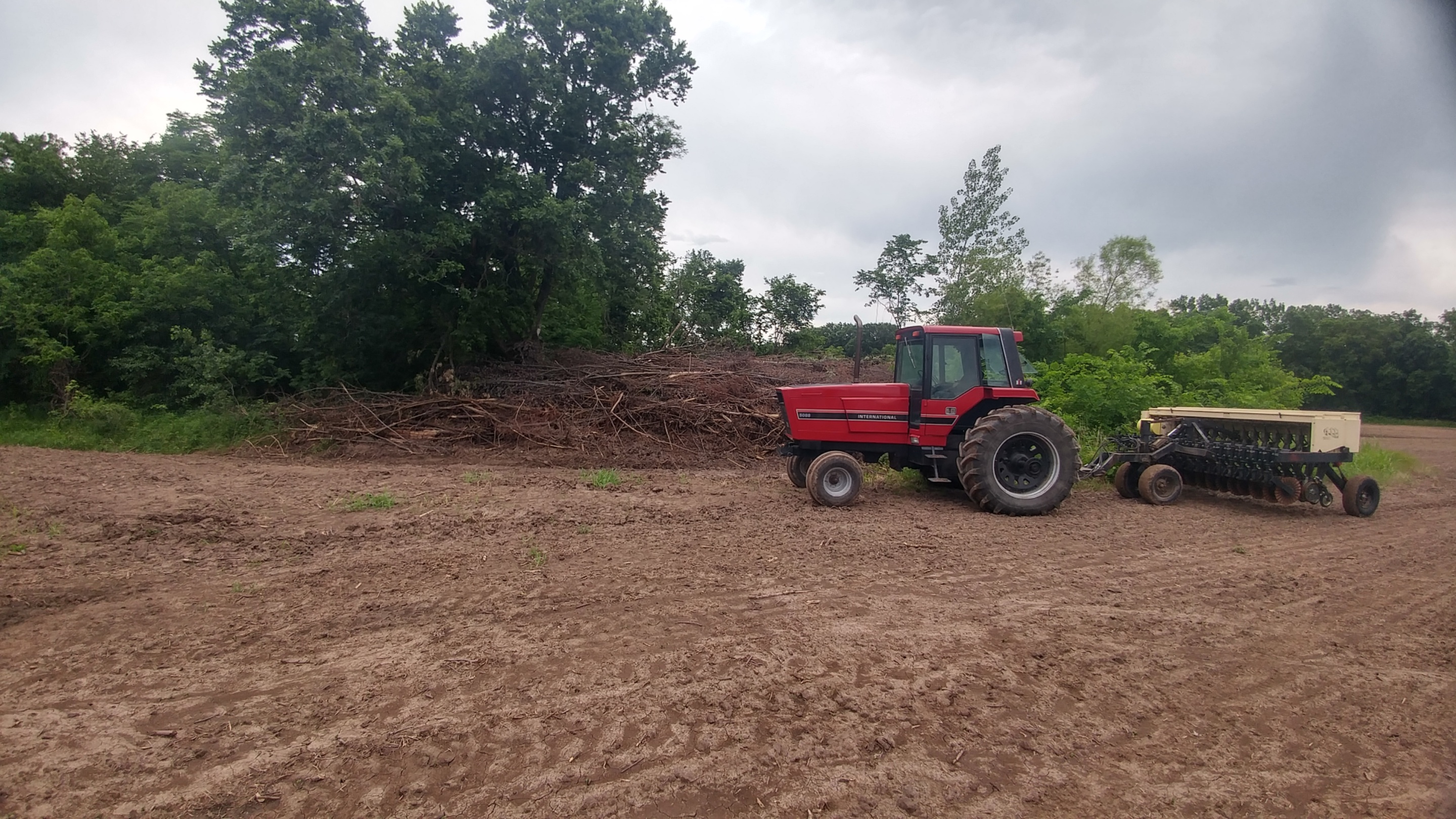

dad/mom drove the tractor over yesterday - i talked to Terry the repairman yesterday after mom/dad dropped it off, he has 90% of the items there and will tear into it over the weekend/first of the week barred no one has a crisis breakdown that interrupts, i never want my stuff to bump someone trying to get their crops in/out hay done, etc.......my stuff is not that critical i dont use my stuff to make a living i just maintain our stuff/others that isnt done by the folks that we rent/share crop with.
So..... Its getting a receiver/dryer, expansion valve, lines, orings, sanden compressor, for starters..............if needed the aux condenser due to the fact the 88 series had a few issues with cooling and condenser volume/pressures, he will check the rest and figure out why the compressor was not kicking on of course - i dont think that was it because i was not getting power on either thermostat wire.
tree removal 1.jpg this is what im getting worked on
