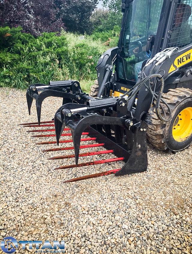

Got a question, I just finished clearing out one of my barns. I use a pitch fork and a four wheel cart to load up the manure and the very wet spent hay. This stuff is thick and quite heavy. My FEL can pick it up fine. The problem is getting it into the bucket. When the pile is big enough I can scoop down and roll it into the bucket. But after a few loads I just push the pile. I am looking for some sort of bolt on forks or spears that can pick it up without just pushing the pile. Now I have to hand load it into the bucket. Not much fun! When I clean out the barns I am moving several tons of material.

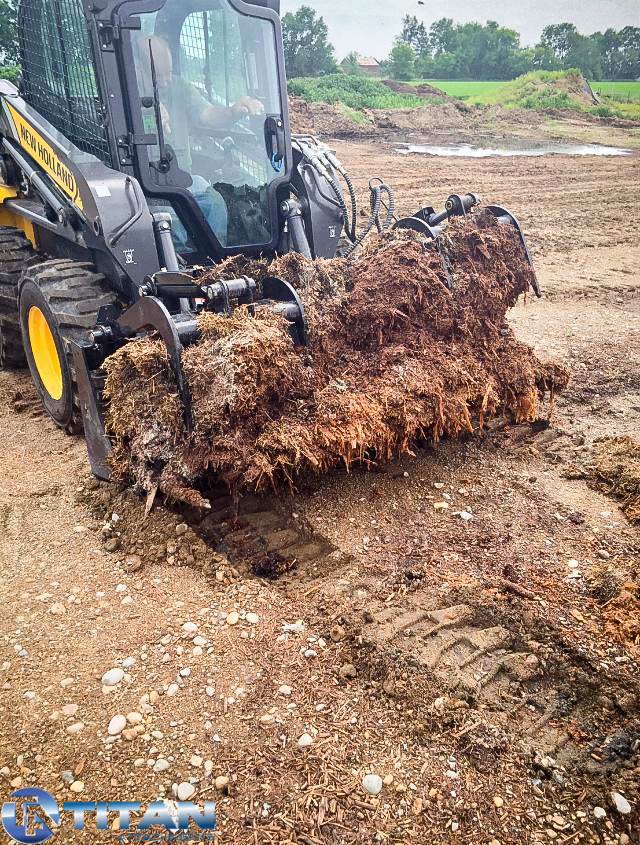

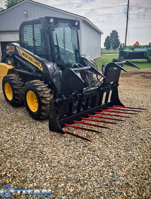

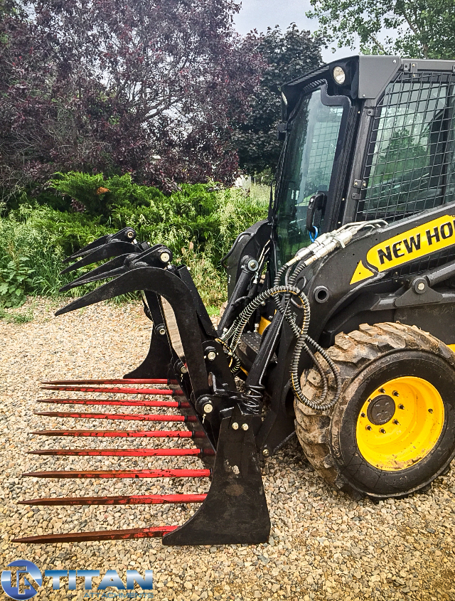

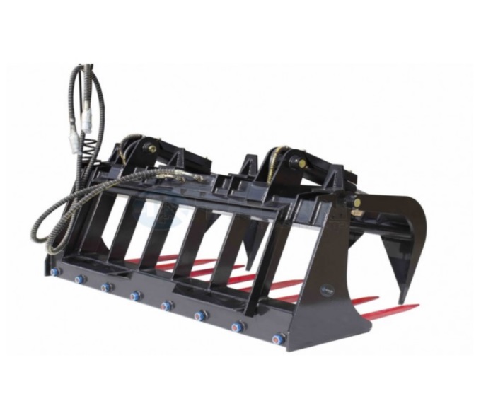

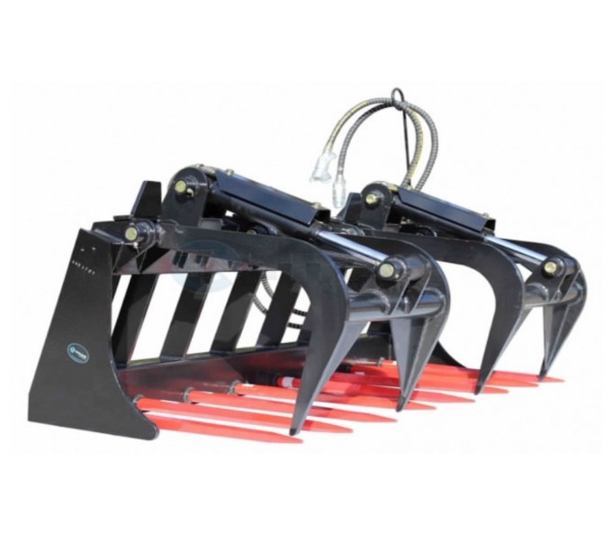

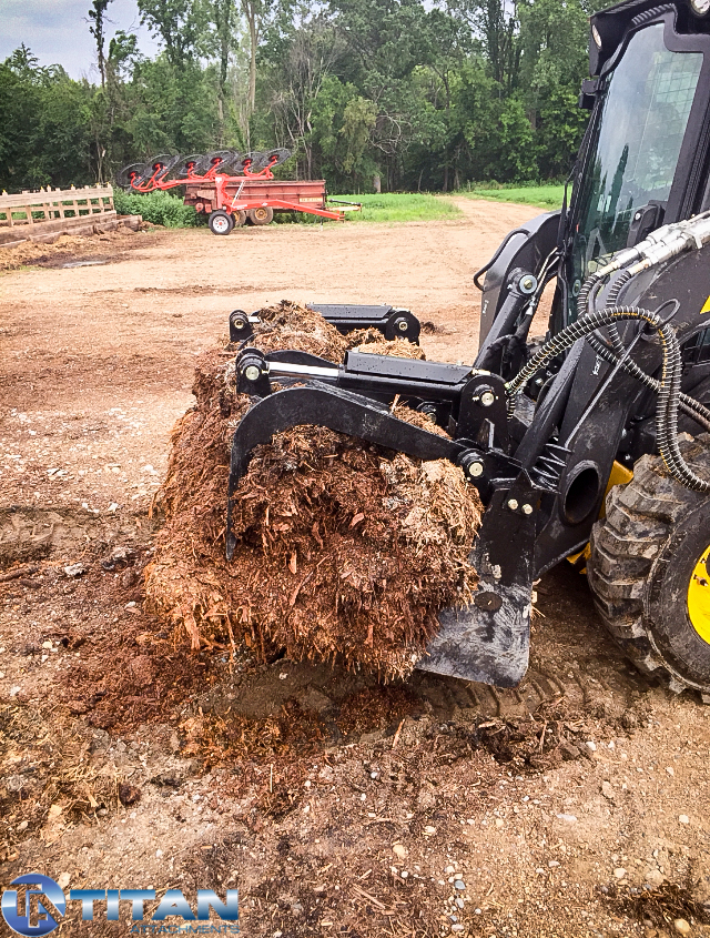

We have used a tined or (manure) grapple bucket for some time, it is built like a pitch fork in that there is no bar bar between tines. It does Not push the old hay or manure and the grapple helps hold everything in place while transporting.
Very similar to the picture Tom posted

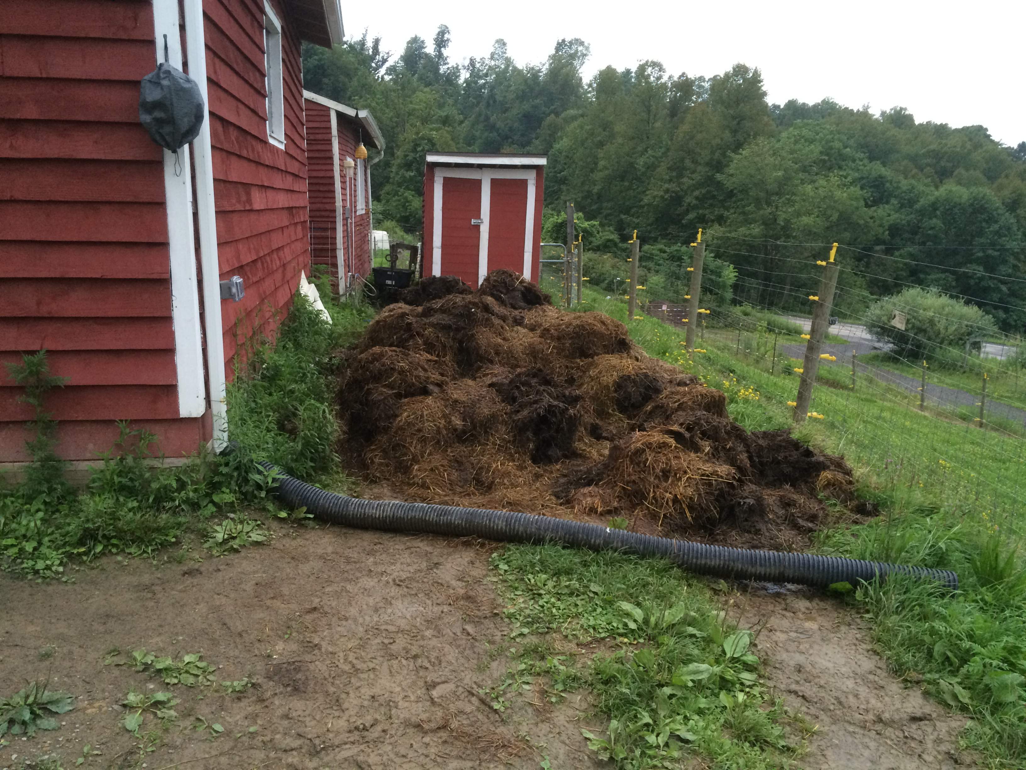

Hi Guys
Here is a picture of the pile I moved over the weekend. The goat barn is on the left toward the back. Straight ahead is my hay hut where I store a round bay of hay for feeding the goats. There were several tons here. barn pile.jpg

You are kind of boxed in there. I wonder if you could make a collapsible backstop? Get a plate of steel or a dumptruck tailgate and anchor hinges on the manure pile side with bracing to hold it upright when you need it to keep the pile from scooting away from the loader. One barn here has a conveyor that loads inside the barn and dumps outside; the owner parks a dump trailer under the outside end of the conveyor and hauls the dump trailer away when it is full enough.
Hmmm, I think the manure fork approach might be the most straightforward and affordable, though.

have seen way to many tines err pipe welded to a general duty bucket over my life time, i do not want to even think about. basically all they have done is welded pipe into the bucket, to create a "large pitch fork" in a sense. the pipes stick out any were from 1 to 3 feet. all the ends have bent / hammered into a point and welded / ground smooth. so they slip up under the manure / straw / old hay.
never seen an actual setup via grapple for manure. i guess i could see use for grapple. but most of the manure / straw ends up falling down / hanging from the tines.

Thank you all for the good information. A grapple would be ideal but is bit too pricey. So I am going to get a clamp tines for my bucket.
