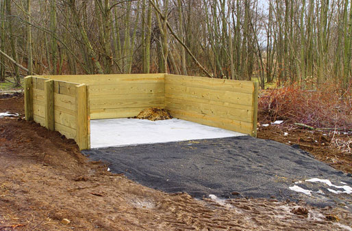

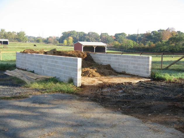

Something to push against, like a stack of RR ties or a concrete barrier. Here is a 3-sided one, but a back wall alone will work
Bruce
   / A Better way to pick up and move manure piles
Hi Bruce
Your idea would work like a charm but, the area I dump is also the path I use to bring in my round bales of hay and that would block it completely. I live in the mountains and there is very little flat land here.
Farm Guy

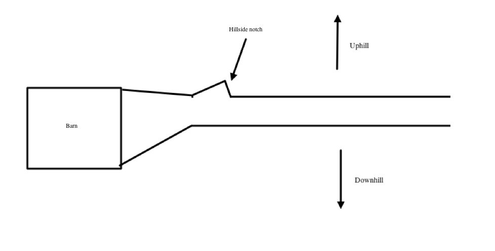

I know how that works! My only flat land is under the house.
Here is what I did. The notch only has to be as wide as the bucket.
Bruce
Hi Bruce,
I like your idea, but with my lay of the land I can not do that. The uphill side has a another building and the downhill side has a pasture fence, straight ahead is my hay hut where I store my round bay hay. I have been looking at getting this: Multi-Spear Ultra Fork I think it would do well picking up the manure. Since it will act like a large pitch fork. What do you think? I am trying to upload a picture of the pile to give you an idea what I am up against.

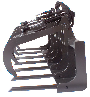

Bobcat, as well as others im sure, make manure fork attachments. Basically 1" square stock steel about 2 feet long spaced about 3" apart. Could probably fab something to mount to your bucket. Yea like that.
   / A Better way to pick up and move manure piles #10
Manure grapple is what I would use.
