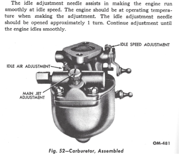

Before you replace coil, try troubleshooting it first. The next time you run the tractor and shut it down and then have trouble restarting, disconnect a sparkplug wire at one of the plugs and see if you get a spark while cranking. If you do then your coil is ok.
If the coil checks OK, check your main jet adjustment screw setting and your idle air adjustment screw setting. First make note of the existing settings by counting the turns required to close each screw. Turn each screw clock-wise until lightly seated (closed) and record the number of turns. Now you have your current baseline and can return to those settings if need be. Then set the screws at the factory initial settings for both screws which is one turn open from the closed position and see if you have better luck starting when the engine is hot.

FWIW, the carb settings on my ‘52 8N are 3/4 turn out for both the idle air and the main jet. The idle speed is adjusted on the linkage on the backside of the carb and should be set to about 400rpm. As low as you can go without it stumbling.
Set the idle speed first, then the idle mixture, then rev it up and set the main jet.

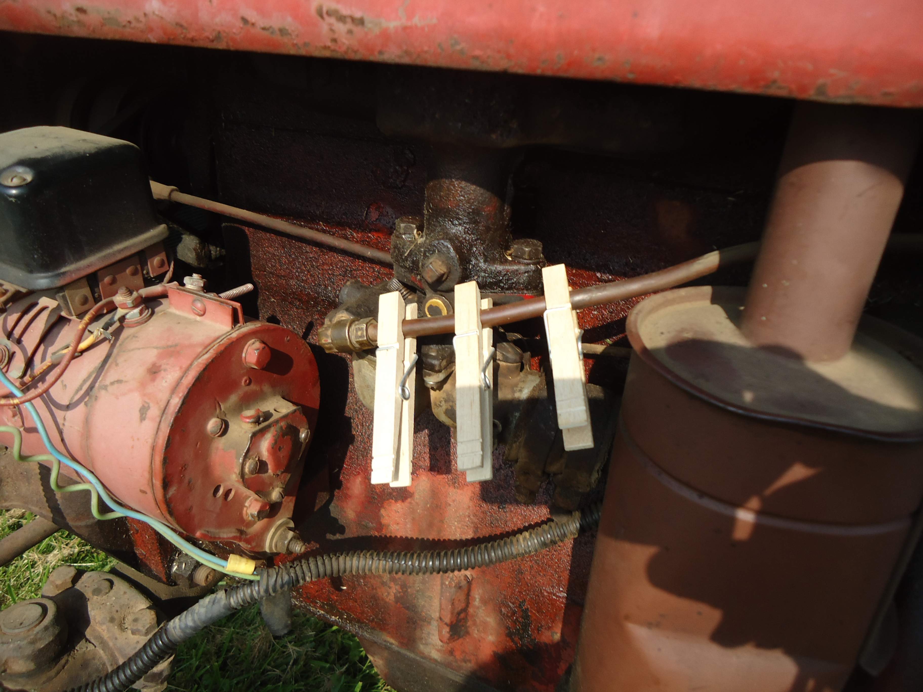

If after you do all of the above, and it still does it, and it truly is vapor lock. Do the easiest cure for vapor lock known to mankind, on Ford products. Get you 3, or as many as it takes, spring type clothes pins, and clamp them on the fuel line, in the "hot spot", like in the picture below. You may scoff at the idea, but it works. They act as a heat sink, to dissipate heat away from the fuel line. I can't count on both hands, how many Ford products from tractors, to large farm trucks, from the 50's, up into the 60's I've seen at least 2 wooden clothes pins on the fuel lines.
It worked on my little Farmall A several years back, when bush hogging on a 90コ day, working it pretty hard. It shut down after mowing for approx. 45 minutes, like it had dirt in the fuel system, somewhere. After taking the carb. apart, and checking the screen in the elbow going into the carb. and finding them clean as a pin, I deduced it was vapor lock. I went to the house, and got 3 clothes pins, clamped them on, and mowed for another 3 hours in the heat of the day, without a problem.

a wet rag on the fuel line should almost imediately take care of vapor lock, so that might be another way to tell.
